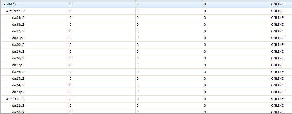

so i had a 11 vdev two way mirrors in my pool and decided to extend it by adding 12 HDD in an additional 6 mirrored vdevs. Problem is that I added the 12 drives to a single mirror. As below:
my question is can i fix it? can i detach drives from mirror 12? if so how?

Ad on 12 way mirrored vdev with 12x 8TB 7200 rpm SAS drives!
That's some redundancy!
Yes, you can detach the ten superfluous mirror drives, but you'll have to do it at the CLI. zpool detach poolname devicename will do the job. Once you're done, detach (export) the pool from the GUI and re-import it so the GUI catches up with what you've done.

Just make sure you only detach the 10 drives you want to reuse elsewhere. Don't try to destroy that entire vdev, or you'll kill the pool (assuming it'll even let you do it, I'm not going to try!)

It won't let you. You can detach 11 disks from a 12-disk mirror, leaving you with a single striped disk (which you also don't want to do, but it won't immediately kill your pool), but it will error out if you try to detach the 12th.
