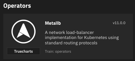

I'm now experimenting a bit with Cobia in one of my VMs and it seems like there's no MetalB/Operator app available. Any clue of how to make multiple IPs available for apps?
15,504
Sure there is:
