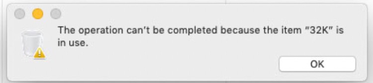

I do have another problem on the same setup, when deleting my (apx. 4000) test files in Finder.
First it take a considerable amount of time and after some time or like 300-400 items deleted ends up with this error:
The "32K" item is one of folders with many small files in it.
On the other hand, deleting one or few files works fine.
Worth mentioning, deleting all of 4000 files from Terminal works fine as well.
seanm
Jun 11, 2018
570
I'm also investigating performance with small files here: https://www.ixsystems.com/community...etween-single-big-file-vs-mixed-folder.74752/
Thanks for sharing your files.zip. I've downloaded it. In case it's helpful to you, on my system, copying from my 10.13.6 Mac to my FreeNAS, any of the different size folders all copy in about 25 seconds.
I've also seen Finder (on macOS 10.13.6) unable to delete folders with a lot of content. When I go inside and delete bit by bit it works. I was going to file a bug, but haven't narrowed it down yet. I've tried to repro with your dataset, but I cannot.
