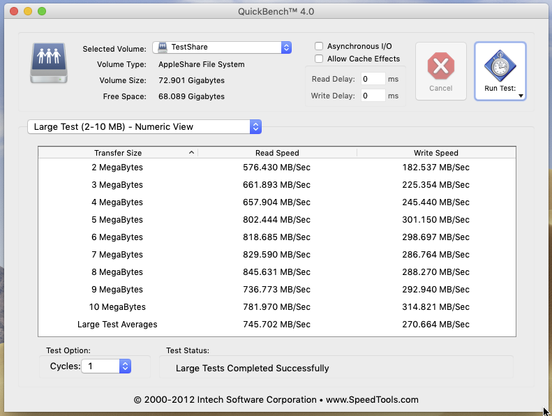

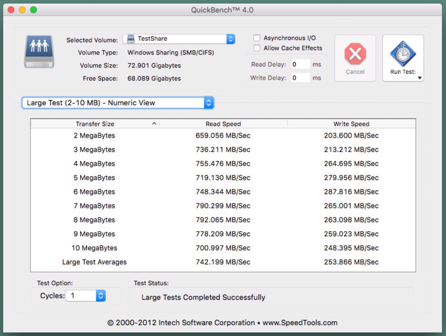

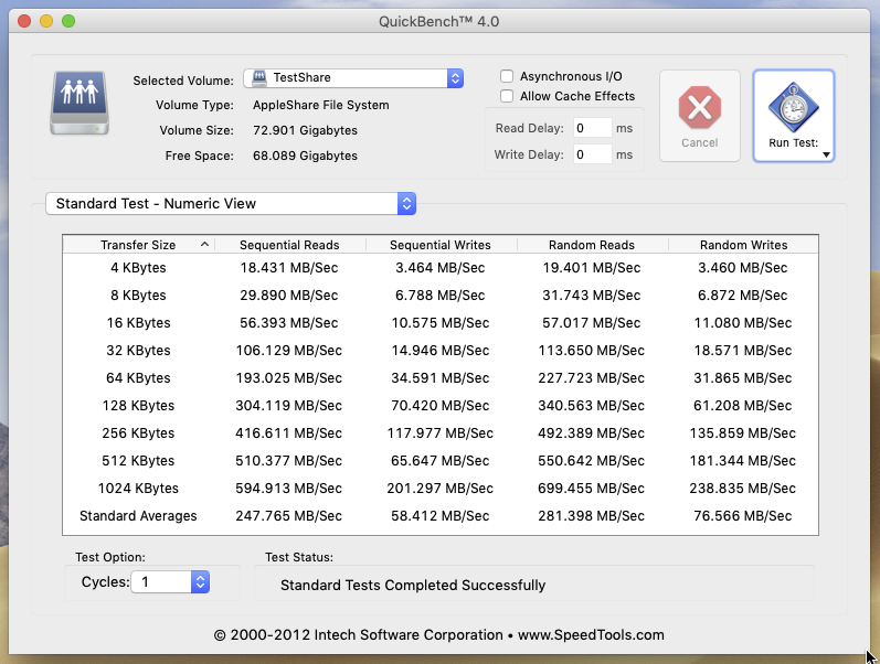

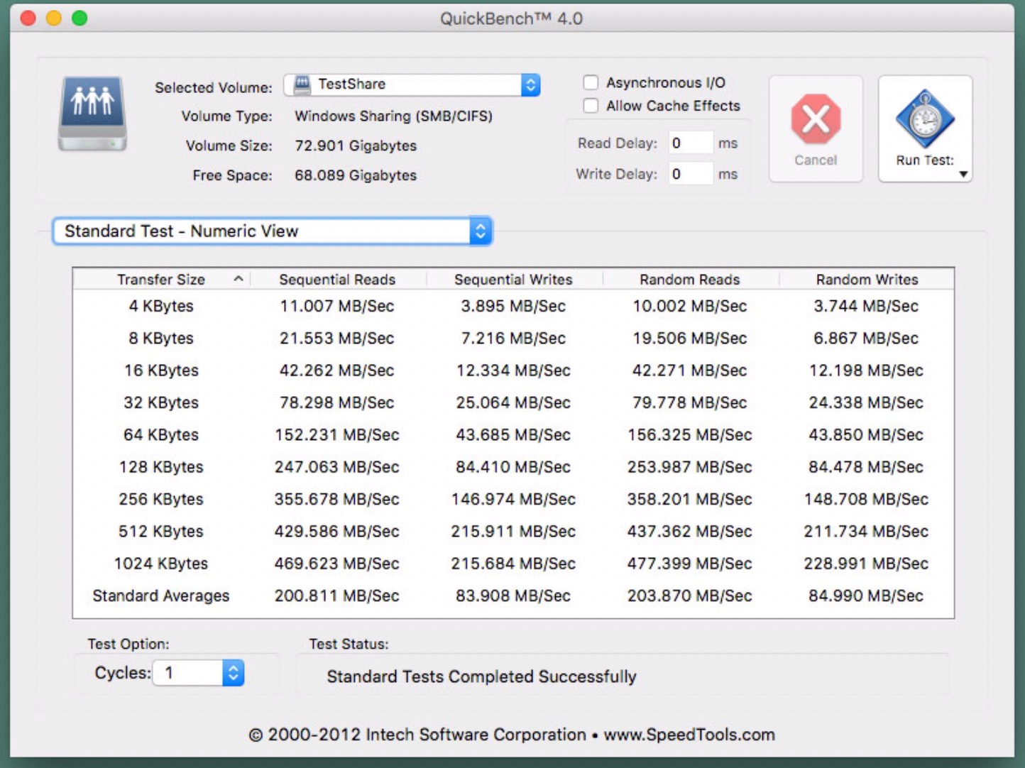

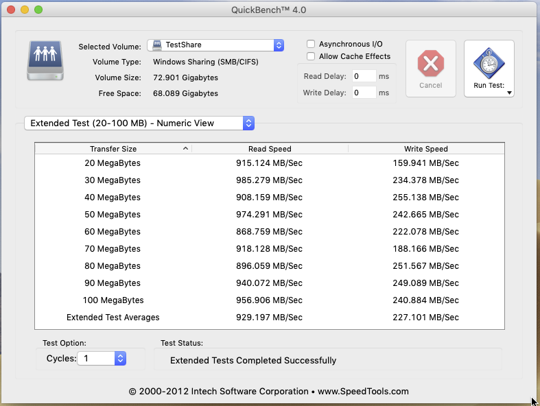

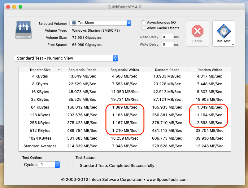

Hi.
Running Mojave 10.14.3 (last update as of 15/3) and I'm on 11.2-U2.1, I have some SMB write issues.
Normaly when writing larger files everithing works fine but writing smaller files ends up in very very slow transfers.
Both sequential and random writes of 64KB to apx 1MB files are slow, other sizes are OK.
My settings on FreeNAS
  • sysctl net.inet.tcp.reass.maxqueuelen = 1448
  • strict sync = no
  • zfsacl, zfs_space, streams_xattr, catia, fruit
are all in place.
SMB on Mojave
SMB on Sierra
AFP
AFP from same 10.14.3 as well as other Mac (10.13.x, 10.12,x, 10.11.x) client works fine,
SMB from windows 10 and windows 7 clients works fine,
SMB from other Macs (10.13.x, 10.12,x, 10.11.x) works fine as well.
Any ideas?
anodos
Sambassador
Mar 6, 2014
9,554
Try turning off samba's internal AIO (new feature in Samba 4.9 / FreeNAS 11.2-U2). This is a share-level parameter (aio write size = 0, aio read size = 0).
Also as point of reference try turning off fruit and repeating the test. If problems persist across these changes, begin by looking for errors in logs, and saturation (storage, CPU, network, etc).
nikbok
Mar 16, 2019
6
Turning off sambas internal AIO did not help, same with turning off Fruit.
Saturation:
On Mac side it is not even close to the full saturation on anything. Nothing i any log file...
On FreeNAS side there are no big jumps or changes, smbd proces is between 15-30% during benchmark and when it hits "brake" goes down to under 1%. No other processes visible to go up.
Logs:
log.smbd does not change under the test, should I change log level?
Any other log files I should look into?
Thax.
anodos
Sambassador
Mar 6, 2014
9,554
Saturation:
Logs:
Thax.
Check console on the Mac for SMB errors. Also check /var/log/samba4/log.smbd. Do note that those parameter changes require a full samba restart to ensure that settings have been cleanly applied.
