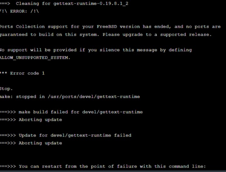

Hi All,
I am trying to install LMS on my Freenas in a jail using this link:
https://forums.freenas.org/threads/lms-on-freenas.61495/
in that link there is reffered to this link: https://audiodigitale.eu/?p=87
my jail is made in Release 11.1-RELEASE-p15
I think I am doing Okay but I keep encoutering the same problem.
I installed portmaster and now I try to execute the command "portmaster audio/logitechmediaserver"
there is a lot of text running on the screen and at some point it asks me to proceed to install a lot of dependencies I guess.
after I type "y" it starts to build and fails with this error
i can't seem to get passed it. can someone help me please?
Thanks!

Did you update the jail before you tried installing? pkg upgrade
rival23
Feb 22, 2019
11
yes I did,

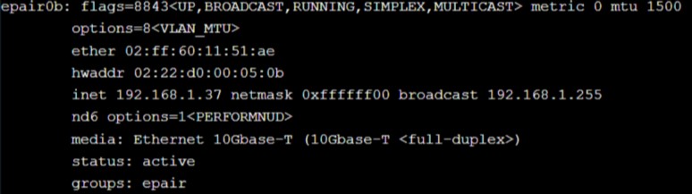

I used this command to install the jail
iocage create -n "lms" -r 11.1-RELEASE ip4_addr="vnet0|192.168.1.37/24" defaultrouter="192.168.1.1" vnet="on" allow_raw_sockets="1" boot="on"
but when I ping to google inside the jail it can't resolve Host name

What version of FreeNAS are you on?
rival23
Feb 22, 2019
11
I just did the newest update: FreeNAS-11.2-U2 (Build Date: Feb 14, 2019)
previous jail was installed on the previous version where I had no network issues

so I did the downgrade as everyone suggested. now I can't seem to access my freeNAS over the internet... I can't even ping it what should I do?
Nvious1
Jul 12, 2018
67
So you rolled back to 11.1 or 11.2-RELEASE? In that thread above there was this post which was the fix on 11.2-U2 jail networking...
You need to change this-> Jails -> Edit Jail -> Network Properties and change vnet-default-interface to "auto" . I use static IPs but if you use DHCP uncheck and check again, save and restart.

sorry I was unclear, I downgraded my system to 11.2U1.
I was unable to access it through the web so I took my monitor and plugged it in the server to see what was wrong. apparently I chose the wrong boot environment. (initial instead of default). i changed it to default and it was all okay.
I now have my internet connectivity back for my jail. I'll keep you up to date wether the LMS server is working or not
