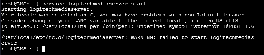

Is lms started? "service logitechmediaserver start"

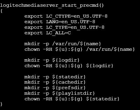

quite happy to change the value - but where?
Looking at /usr/local/etc/rc.d/logitechmediaserver (probably the wrong file)
logitechmediaserver_enable="YES" is hashed out
BUT lang isn't set to C - its set to US.UTF-8 - which is probably good enough for me in the UK

There's a reason why I left it to C. It's because otherwise you'll get a memory leak on FreeBSD. So, don't change the locale. See previous posts.
Which version of FreeBSD is the jail based on? 12 or 13?
During this Weekend I'll set up a TrueNAS VM to test the latest update which I have only tested on FreeBSD 13

BaseJail: 12.2-RELEASE-p6.
TrueNAS 12.0-U5.1
NugentS
Apr 16, 2020
2,947
Just released an update, tested on FreeBSD 12.2. Update from lms_installer
That seems to work - now got LMS running, and starts automatically
