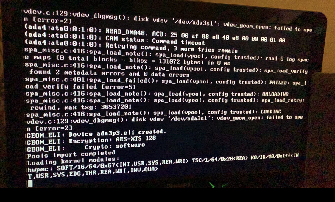

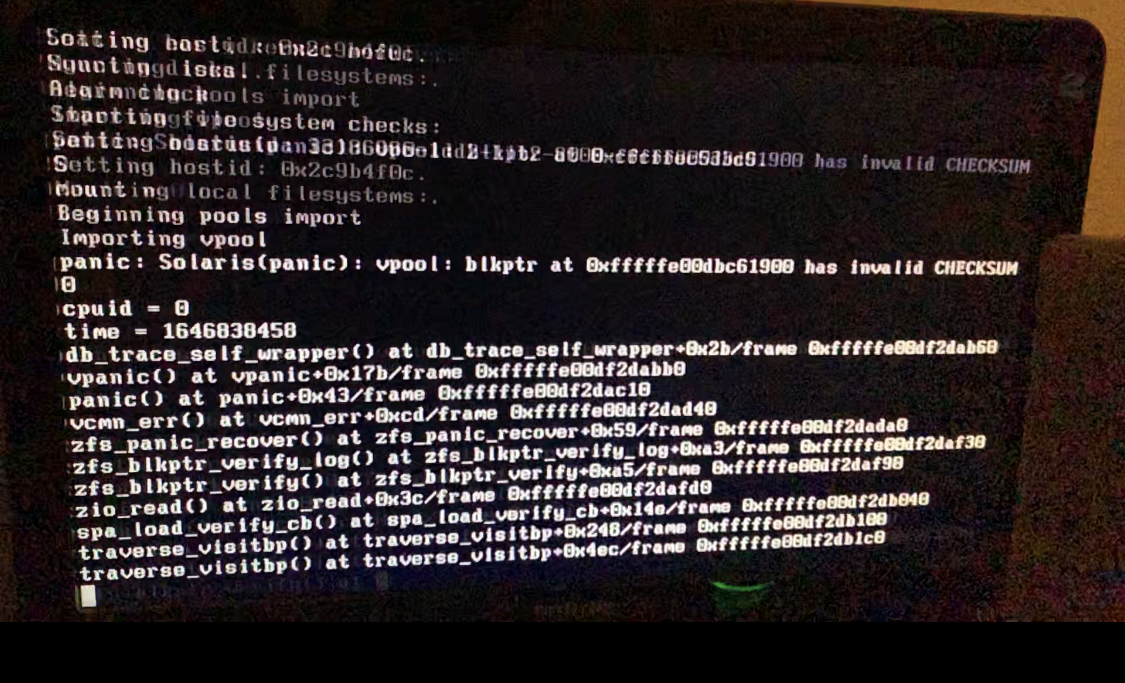

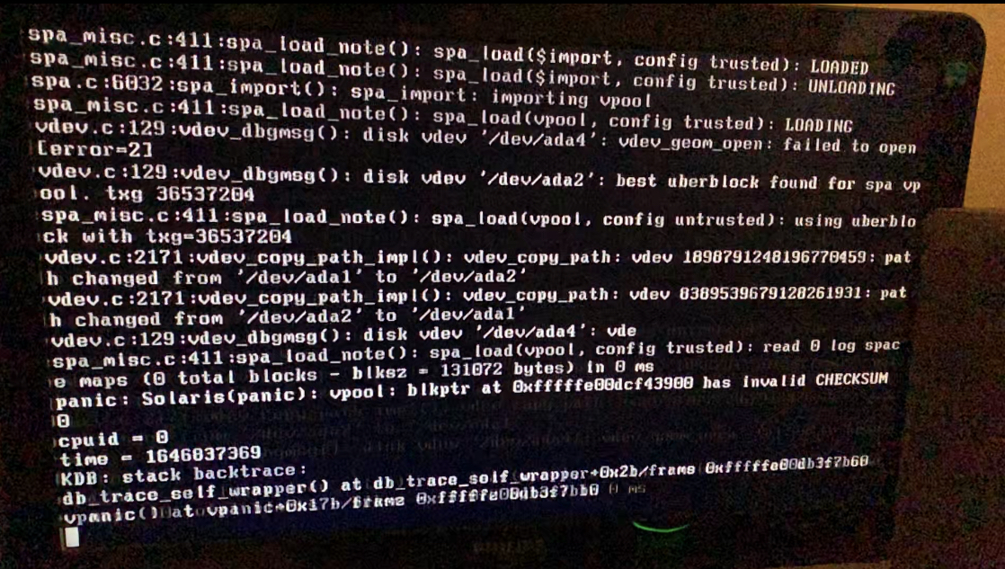

I noticed my nfs and sambda shares were offline and not accessible so I rebooted the server a couple of times with no luck.
Hooked up a monitor and saw kernel panic and stack trace points to IO.
I was running Truenas on a usb stick so first thing I thought was a buggered usb stick, so I decided to reinstall on an SSD.

The above is how I got to my current situation and now I'll explain what troubleshooting I have done to the zfs pool
I saw the pool was not online so I went to shell and tried to import it
root@nas[~]# zpool import vpool
cannot import 'vpool': I/O error

So here is an update, not sure if its good or bad but I think I'm gaining more understanding of the situation.
I'm reasonably confident that the pool failure got nothing to do with the reported disk partitions.
Quick summary of all my 5 disks
Disk A: WD 2TB, no smart errors and doesn't have partition table
Disk B: WD 2TB, no smart errors and doesn't have partition table
Disk C: WD 2TB, no smart errors and doesn't have partition table
Disk D: Seagate 2TB, whole bunch of smart errors and has an ext4 partition
Disk E: Seagate 2TB, no smart errors and has a NTFS partition
This is the kernel stacktrace during boot (please excuse the photos, its the quickest way for me to capture it)
This is booting via USB stick using 12U4, with Disk B-E plugged in
I saw the erorr on failed to open /dev/ada4 and ada4 is Disk D so then decided to plug it completely.
After unplugging it, 12U4 started without issues (obviously pool not been imported). I was not able to get 12U4 start until this point.
Then I plugged in Disk A, Disk B, Disk C and Disk E. Started 12U4 via usb stick
Which is the same checksum error as the previous step
So I thought Disk A doesn't have any smart error so the disk itself could still be ok and latest 12U8 maybe using newer version of zfs and could better deal with this. So I started 12U8 and this is what I got. 2 metadata errors and 0 data errors
This is with Disk A, Disk B, Disk C and Disk E plugged in and 12U8 started fine. I then tested with just Disk B, C and E, 12U8 also started fine.
Could this be a better situation then I was previously in? I don't know and I hope someone can give me some ideas.
Could I try mount the pool readonly with Disk A, B, C and E? then try with the -Fn switch if no luck on read only?
Or should I try to clone the faulty disk and hope it can somehow provide more data?
