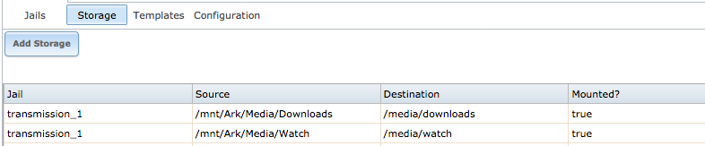

I don't understand what you mean by mount point doesn't work. Did you add the media download folders using Jails > Storage > Add Storage? When you're done it should look something like this:

Yes i did, but i found a solution.
I switched my jails to windows permissions, and the trick was to give permission to the download folder from windows...
