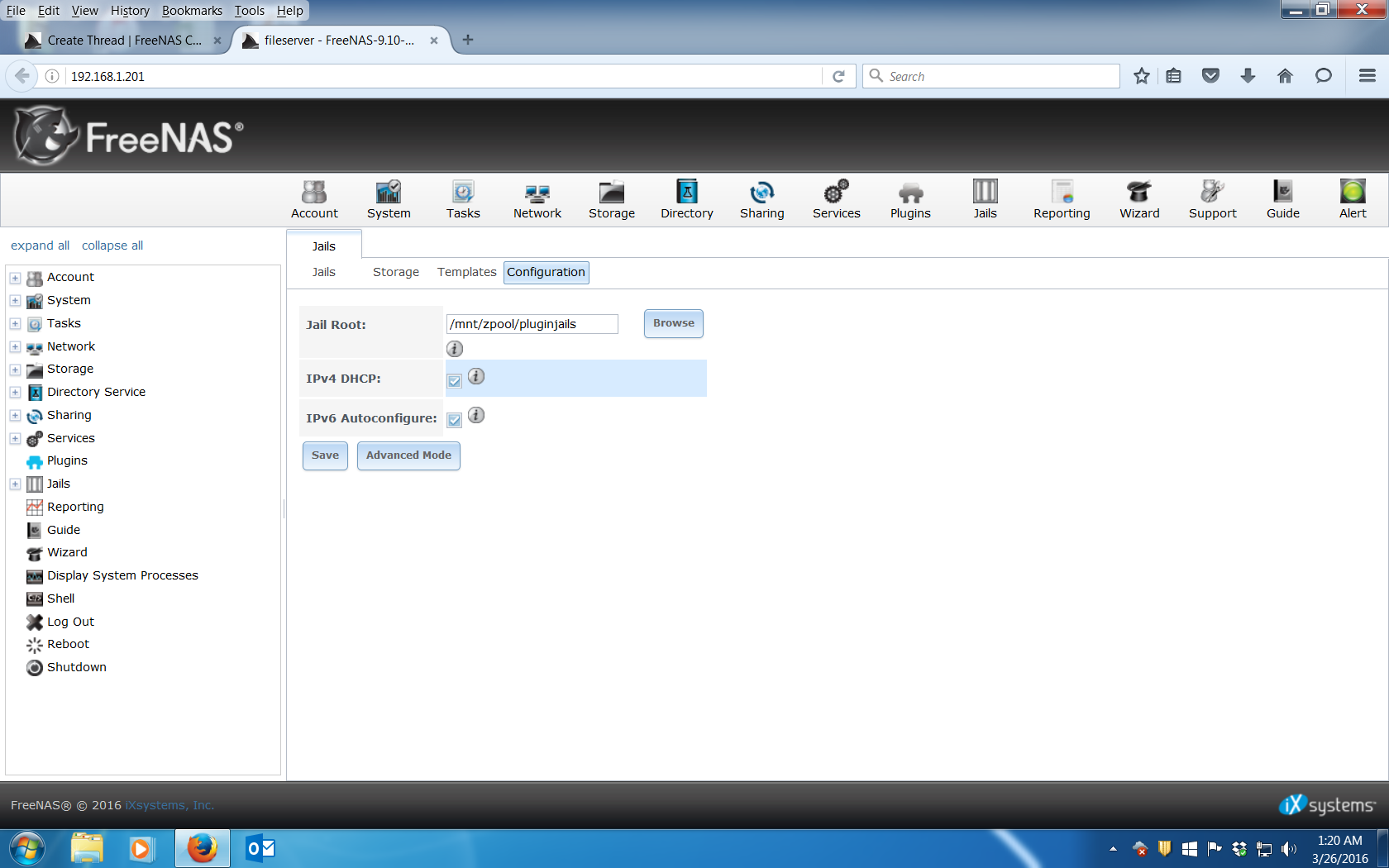

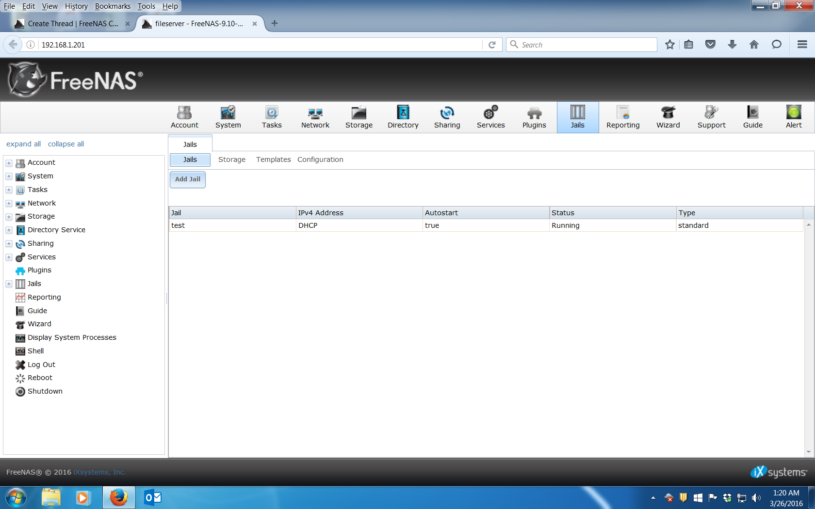

I have installed a fresh copy of FreeNAS 9.10 and the 9.10 nightlies to try and correct my problem. I tried to add a new new jail (test) and the dhcp will not grab an IP address. I have it set to autoconfigure and I have tried deleting the jail root and allow it to reinstall and I still can't get it to work.

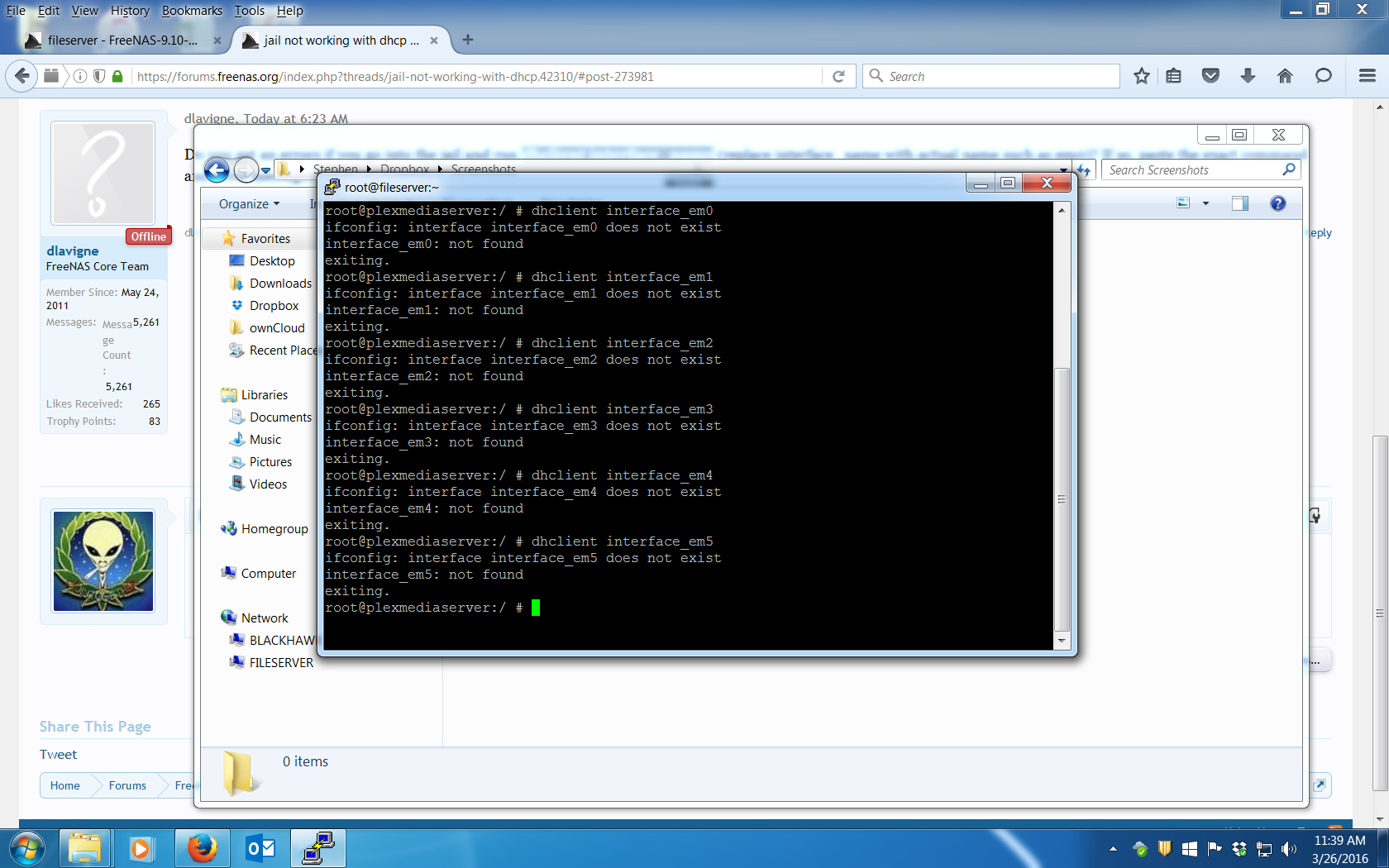

Do you get an errors if you go into the jail and run dhclient interface_name (replace interface_name with actual name such as em0)? If so, paste the exact command and error messages.

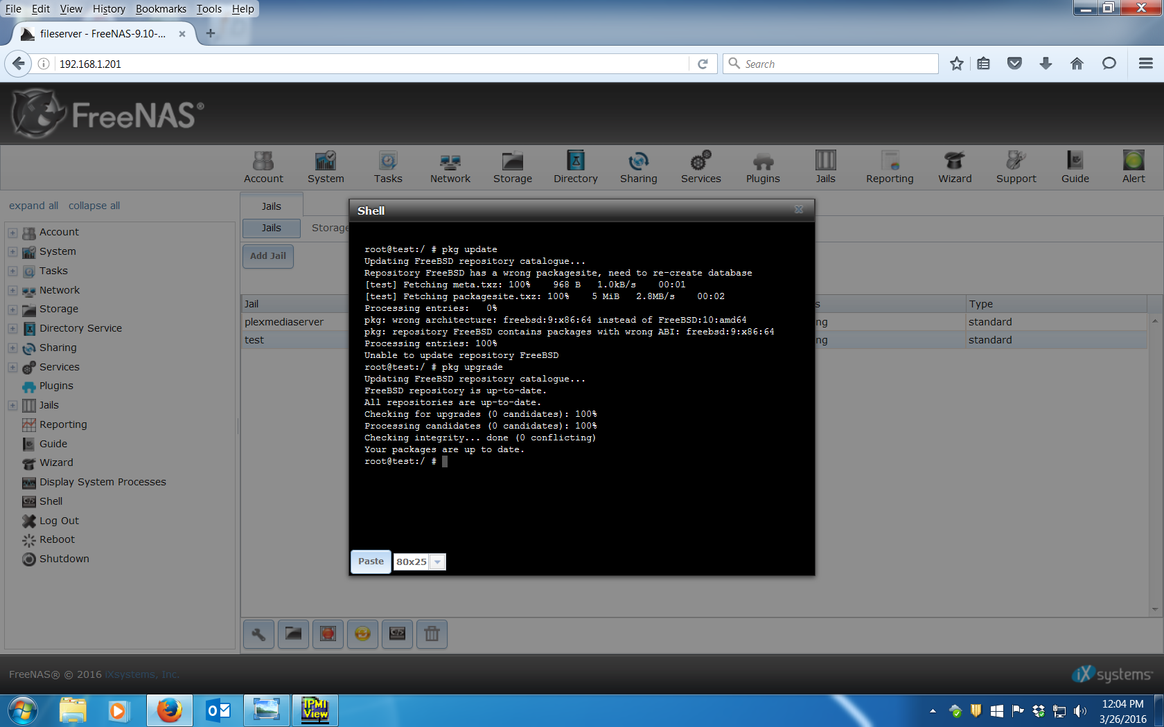

This is the strangest thing. I had a couple test jails that grabbed an IP address when I restarted the computer but when I deleted them and tried to start over it went back to the original problem of not getting an IP address. I have a intel 4-port nic and 2 built in on the motherboard with em0 and em3 plugged in on the 4-port.
