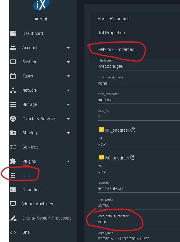

You need to change this-> Jails -> Edit Jail -> Network Properties and change vnet-default-interface to "auto" . I use static IPs but if you use DHCP uncheck and check again, save and restart.

Oh my goodness. One small hidden away change. Thank you soooo much. It fixed my issues. Been banging my head trying work arounds, but this is actually the fix. Cheers! Forgot to say, I only signed up to the forums to say thanks and let others know that this actually works. For those who may find it hard to determine exactly which setting it is, I have circled the sections in my attached screenshot.

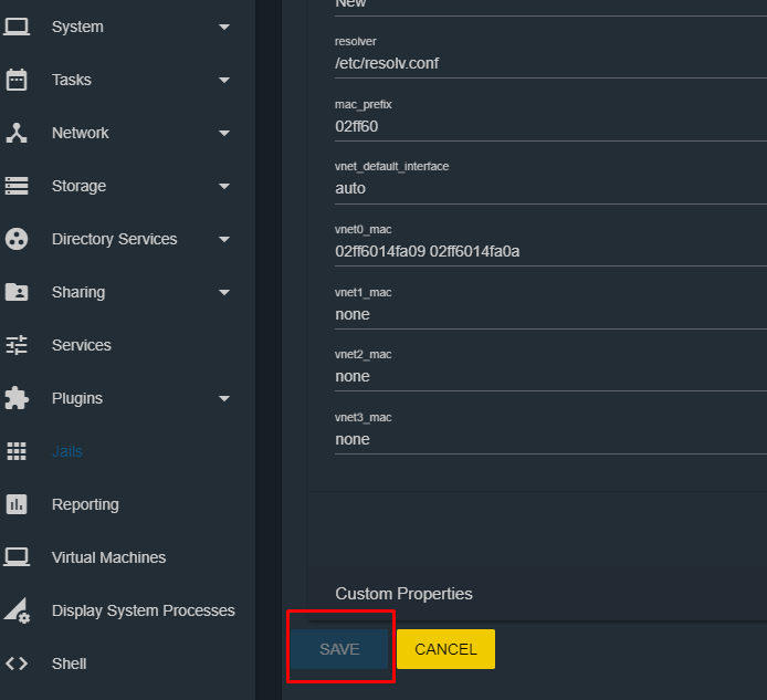

Make sure you have stopped your jail before trying.
Yes of course it is stopped, without that i cant edit. I can edit but cannot save because the button is disabled.
Anyway, i changed disabled button to enabled with "inspecting element" from Chrome, and saved it successfully.
