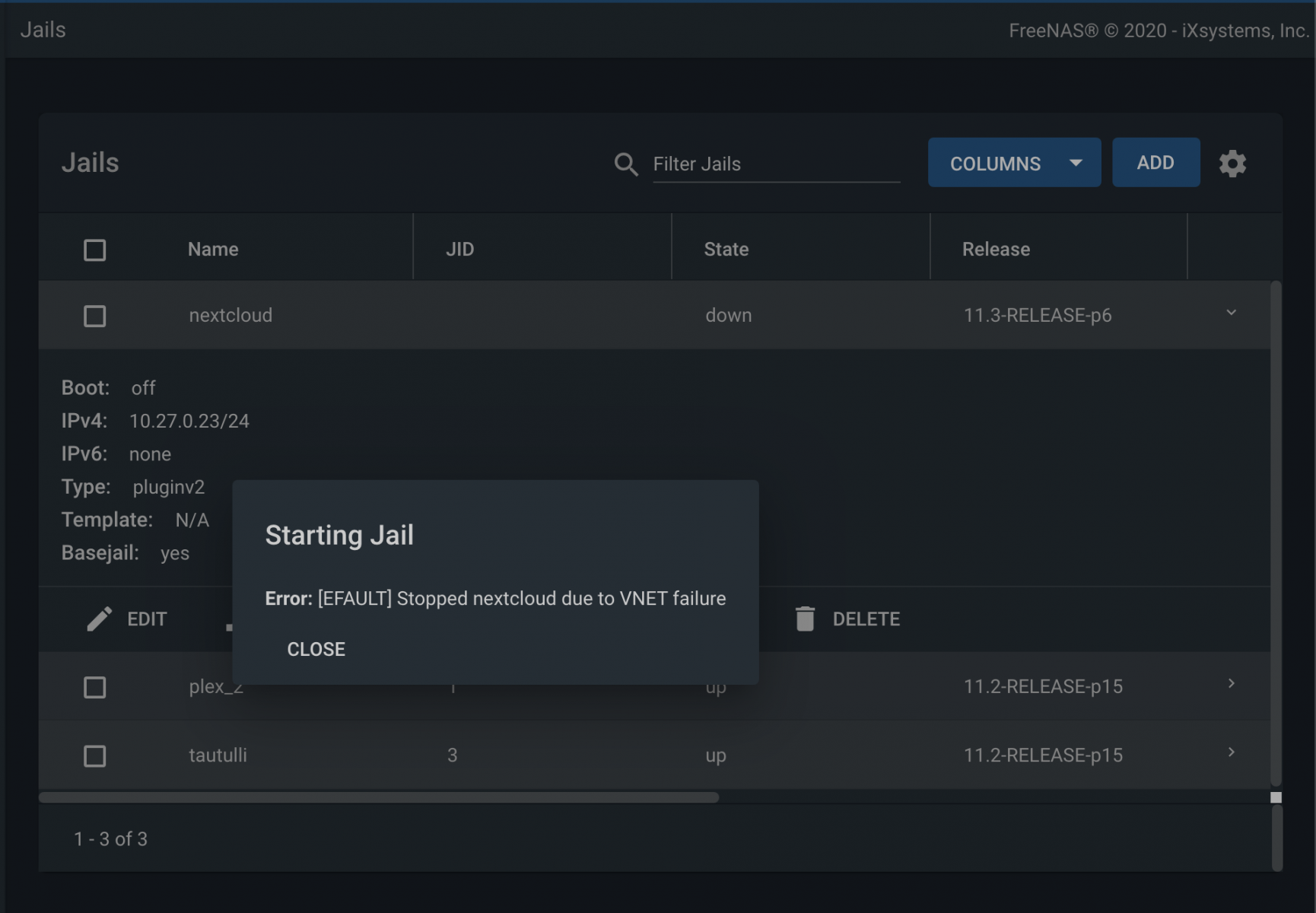

I cannot start the jail afterwards. It throws the following error when I tried to start it.
% sudo iocage start nextcloud
* Ruleset 6 does not exist, using defaults
No default gateway found for ipv6.
* Starting nextcloud
  + Started OK
  + Using devfs_ruleset: 6
  + Configuring VNET FAILED
  route: writing to routing socket: Network is unreachable
add net default: gateway 10.0.0.1 fib 0: Network is unreachable

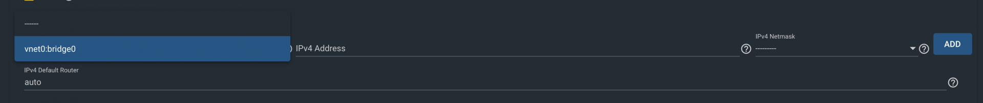

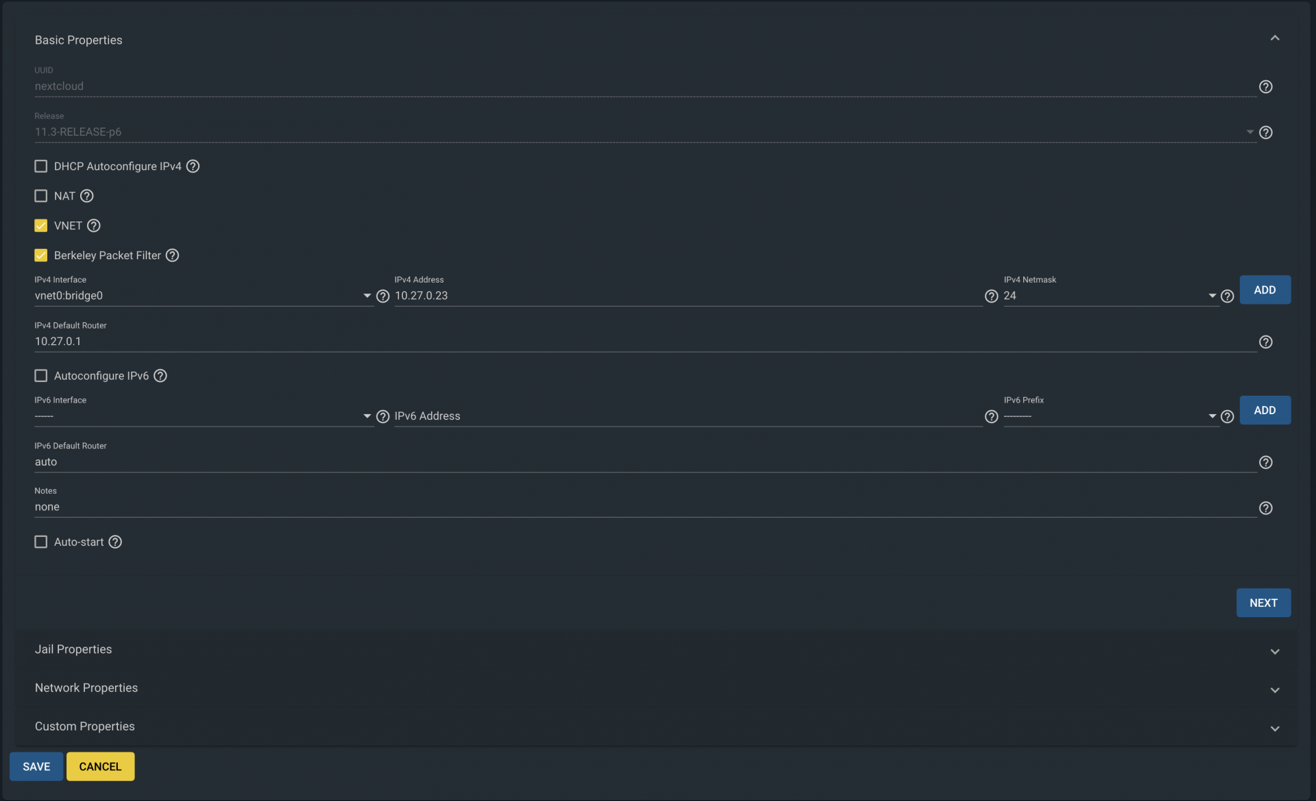

On the Jail Edit pane, with both "DHCP Autoconfigure IPv4" unchecked and "VNET" checked, the only option available in "IPv4 Interface" is
"vnet0:bridge0".

Thanks for pointing out. I was just trying to illustrate my problem with a make up setting that similar to mine.
I have set with your suggested settings. It still does not work. :(
freenas% sudo iocage start nextcloud
Password:
  + Started OK
add net default: gateway 10.27.0.1 fib 0: Network is unreachable
Stopped nextcloud due to VNET failure
