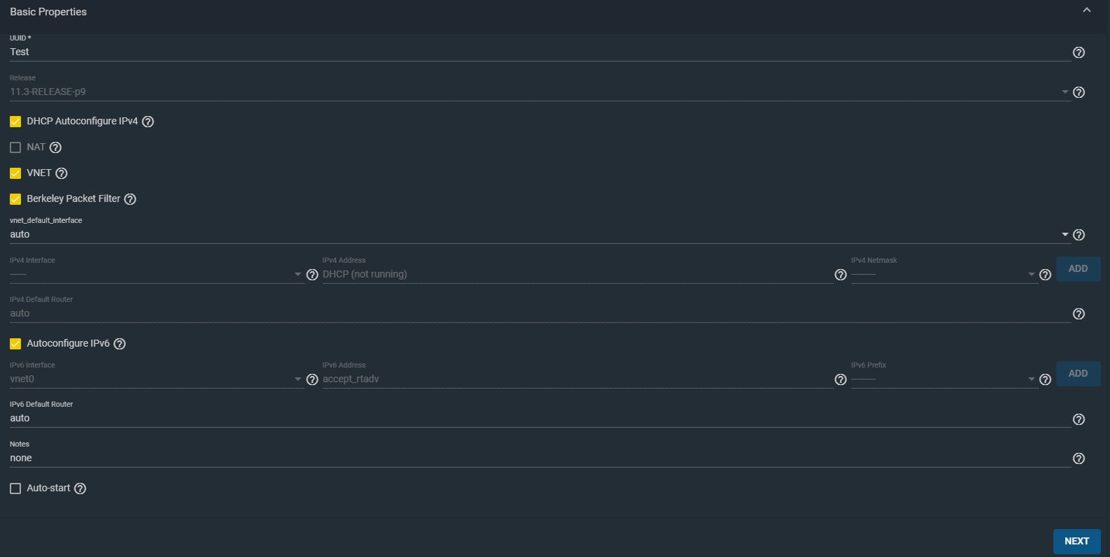

I have tried creating fresh jails with the minimum basic settings, and still I am unable to receive an address or route via IPv4. For Example:
"Fresh" Jail
1. Initial Settings
Type: Clone
Release: 11.3
2. Network Settings
DHCP Box Checked
NAT Box Unchecked
VNET Box Checked
Autoconfigure IPv6 Box Checked
Jail Summary
  • Release : 11.3-RELEASE
  • Jail Name : Test
  • DHCP Autoconfigure IPv4 : Yes
  • VNET Virtual Networking : Yes
  • NAT Autoconfigure IPv4 : No
  • IPv6 Address : Auto configure IPv6
  • Default Router For IPv6 : auto
Attempt to start this jail yields the following error:
Error: [EFAULT] + Acquiring DHCP address: FAILED, address received: 0.0.0.0/8 Stopped Test due to DHCP failure

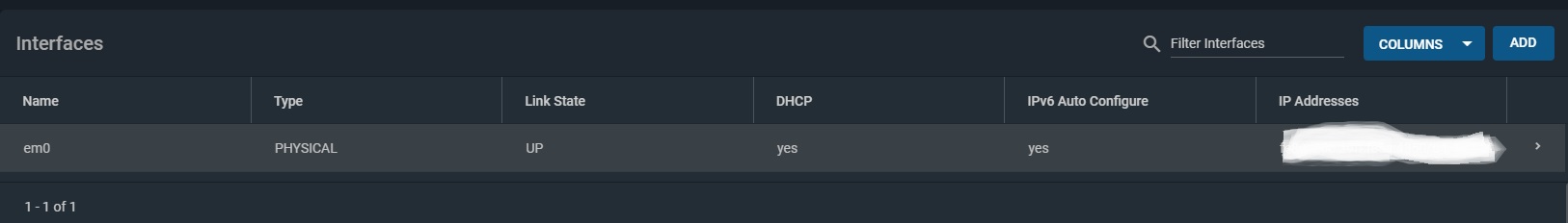

I just noticed that there is no bridge interface defined in FreeNAS Networking Interfaces. That might be a problem? All I see is the physical interface em0.

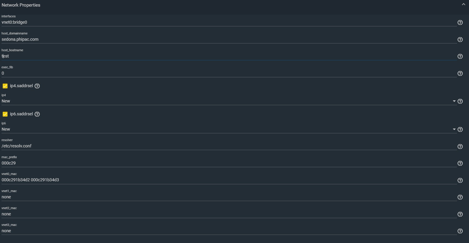

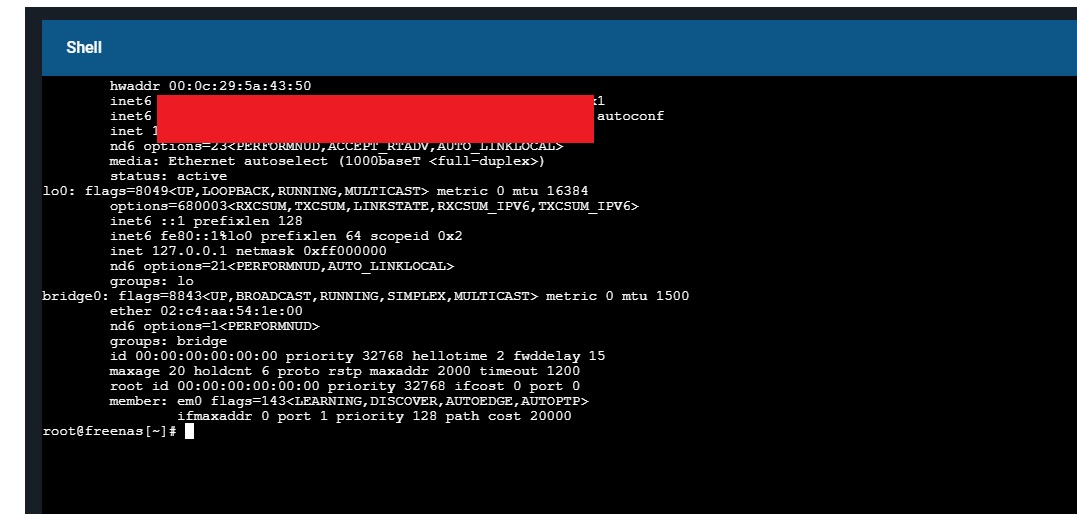

I do see that, yes. Still no luck. Here are the rest of the network settings for the jail:

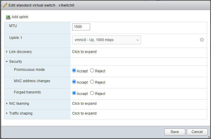

I had this same problem, in a virtualized TrueNAS-12.0-U2.1 under ESXi 7.0 Update 2.
I set all the security options in the vSwitch port group containing the TrueNAS vm to "Accept" (not just promiscuous mode), and the problem went away:
Promiscuous mode
Accept
MAC address changes
Accept
Forged transmits
Accept
YujiTFD
May 5, 2021
22
Promiscuous mode
Accept
MAC address changes
Accept
Forged transmits
Accept
That totally did it, cheers mate!

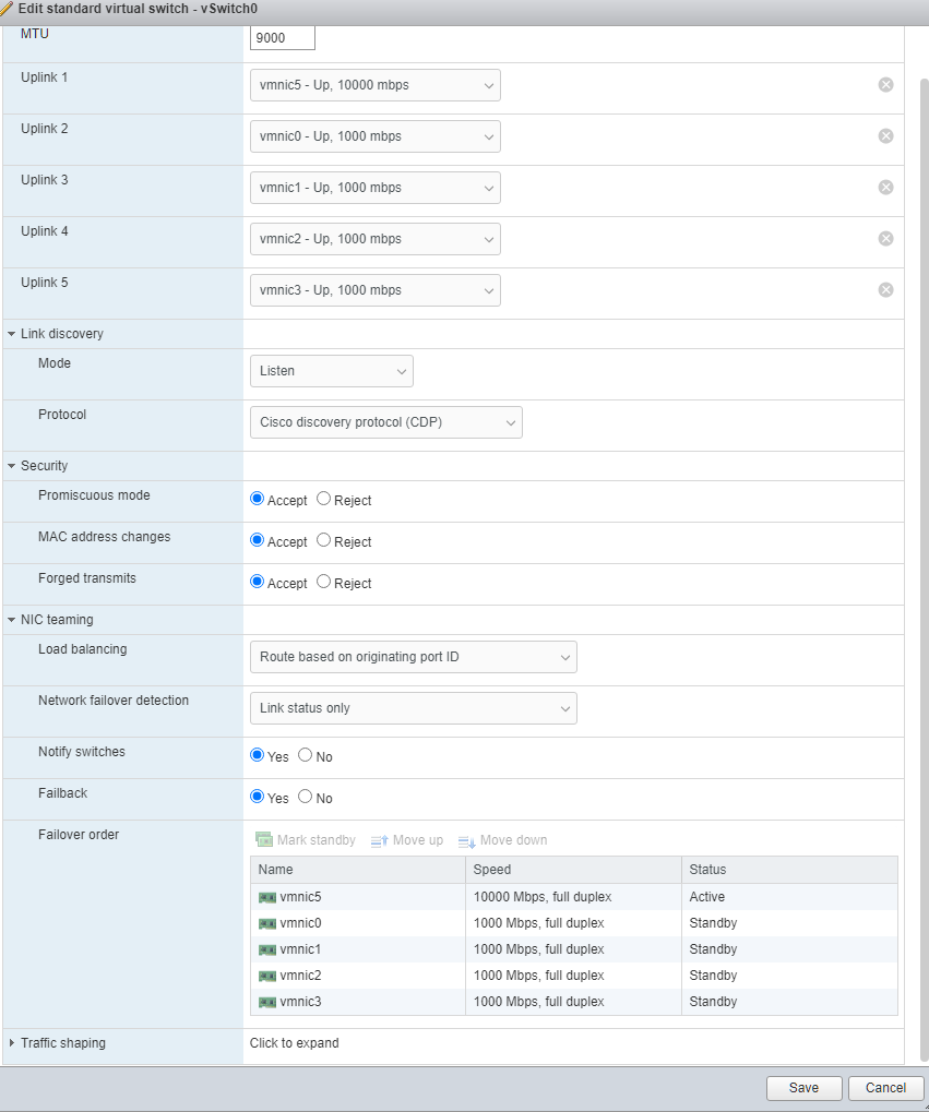

Did you have to restart ESXi after you made the changes? I have changed all 3 to Accept and Truenas still wont get a dhcp ip for the jail. I did restart Truenas I just haven't restarted ESXi.

Ok I will have a look when i get home, I have a 10Gbe port and 4 x 1Gbe, I have the 10G as the main and the 4 others as failover.
Could this be the problem?
I don't have any issue getting DHCP addresses for any other VM's and the TrueNAS got a DHCP address ok.
I do have the TrueNAS as DHCP with UDM Pro assigning a fixed address to the TrueNAS install.
My settings are identical to yours expect I have no standby NICs. I'm not an expert in networking and I doubt failover would cause such a problem, so I would test it out, if possible: disable failover and look if it helps, but, again, I doubt it's the problem.

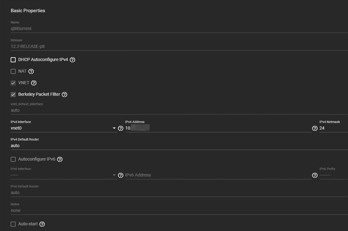

Same again: UDM Pro, fixed IP for TrueNAS via DHCP, so nothing to add here. My jails's settings are:

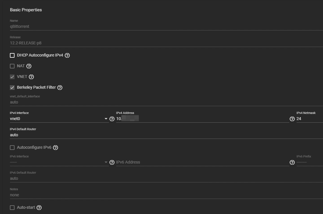

Thanks, yeah i can use a static ip for the Jails, it's just the DHCP. I was trying to create a Jail for Syncthing but when i use a static IP Syncthing keeps looking for localhost and I can't get into it.

I have spent Months and Months installing and reinstalling TrueNAS etc and YES it does not like the Failover. I disabled them all and just left the 10Gbe and it got a DHCP address.
I went for static IP as a personal choice, but before I did that, as I said earlier, I had Jails to have an IP from DHCP pool.
As for localhost situation, off the top of my head, try to disable VNET in Jail's Basic Properties and enable "assing_localhost" in Custom Properties section and test it out.
