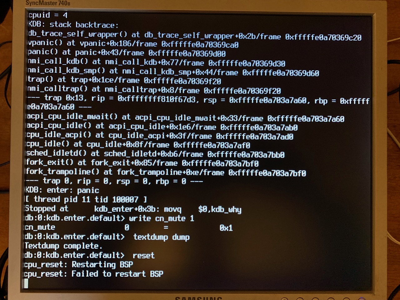

Hi FreeNAS friends.
After 2 years of solid service, I think my ASRock C2750D4I has finally succumbed to the Avaton family LPC bug. I had a few unplanned restarts in one day (kernel panics) and now it won't POST. Power supply spins up, but nothing happens - no output to VGA. The only thing I have to go on is this photo I took from the last kernel panic before it refused to start. I don't know enough to interpret the message - I'm hoping someone maybe able to make sense of it and / or confirm that the symptoms are consistent with the LPC bug.
I've tested everything I can think of: removed / swapped memory, removed all USB / hard drives. Checked power supply. It seems overwhelmingly likely that it is the LPC bug, but would by nice to verify by someone else's experience that the symptoms line up. Very difficult to diagnose this board - no way to get a POST beep (no onboard speaker, no terminals for an external speaker), VGA output doesn't start until a successful POST, BMC is dead.

Interestingly, the symptoms of the BMC watchdog fault were subtly different: in that case, pressing the case button wouldn't even start the power supply (ie POST wouldn't even commence). This time, the power supply comes on, but I am guessing POST fails.

I can't say the root cause in the system board for this fault, but it does sound like a failed board. If you are not going to pursue some warranty remedy, what would your next choice be?

Looks like you've been bitten by the avaton bug. A no post situation with those boards is a dead giveaway. I wish I had more to offer but maybe some of our Australian members can help out with what might be a suitable replacement. ASUS has a good reputation in the desktop arena but I have no idea how one of their server boards would work out. They are not a popular option so you'd basically be on your own if you ran into issues with it.
