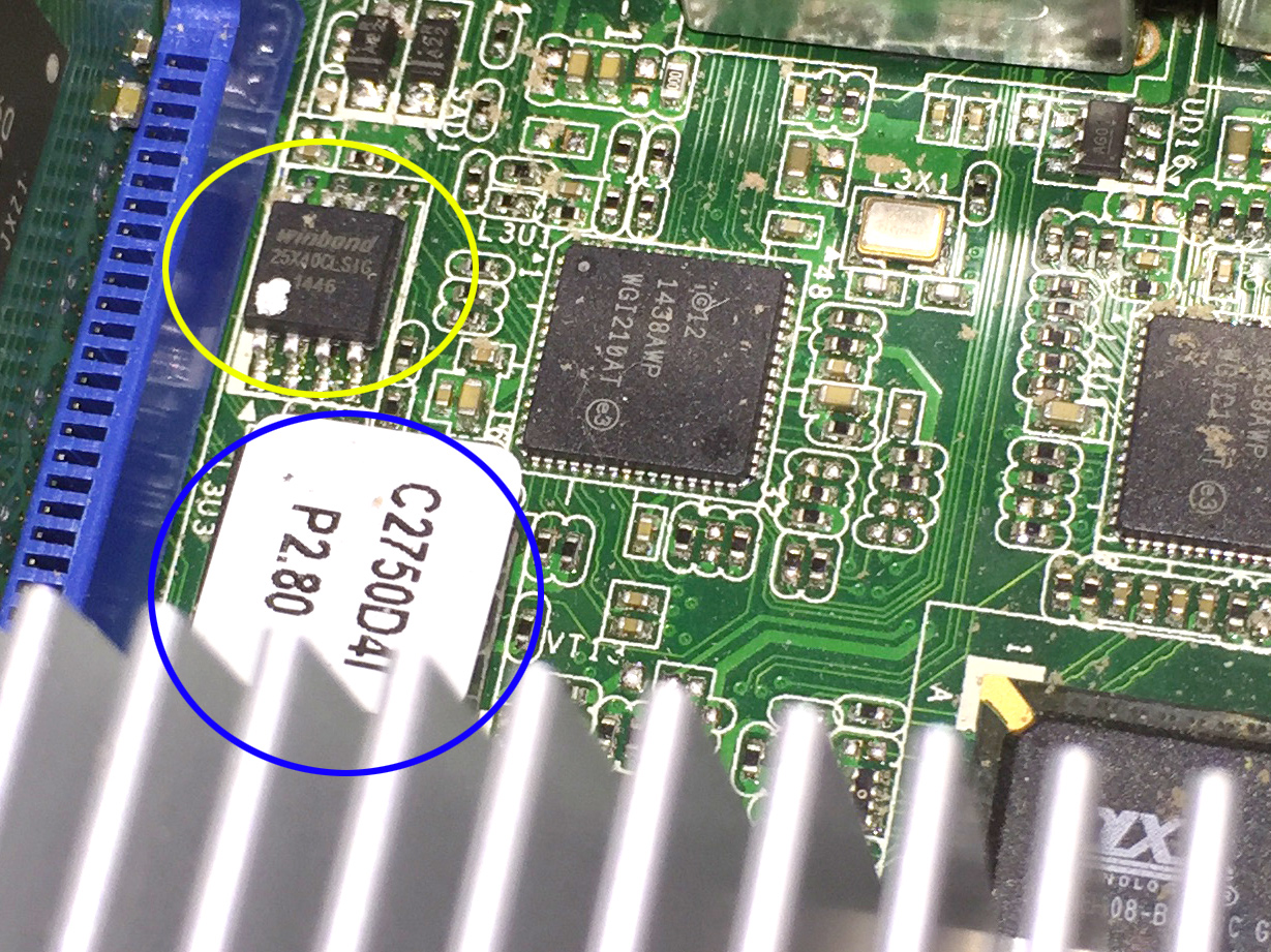

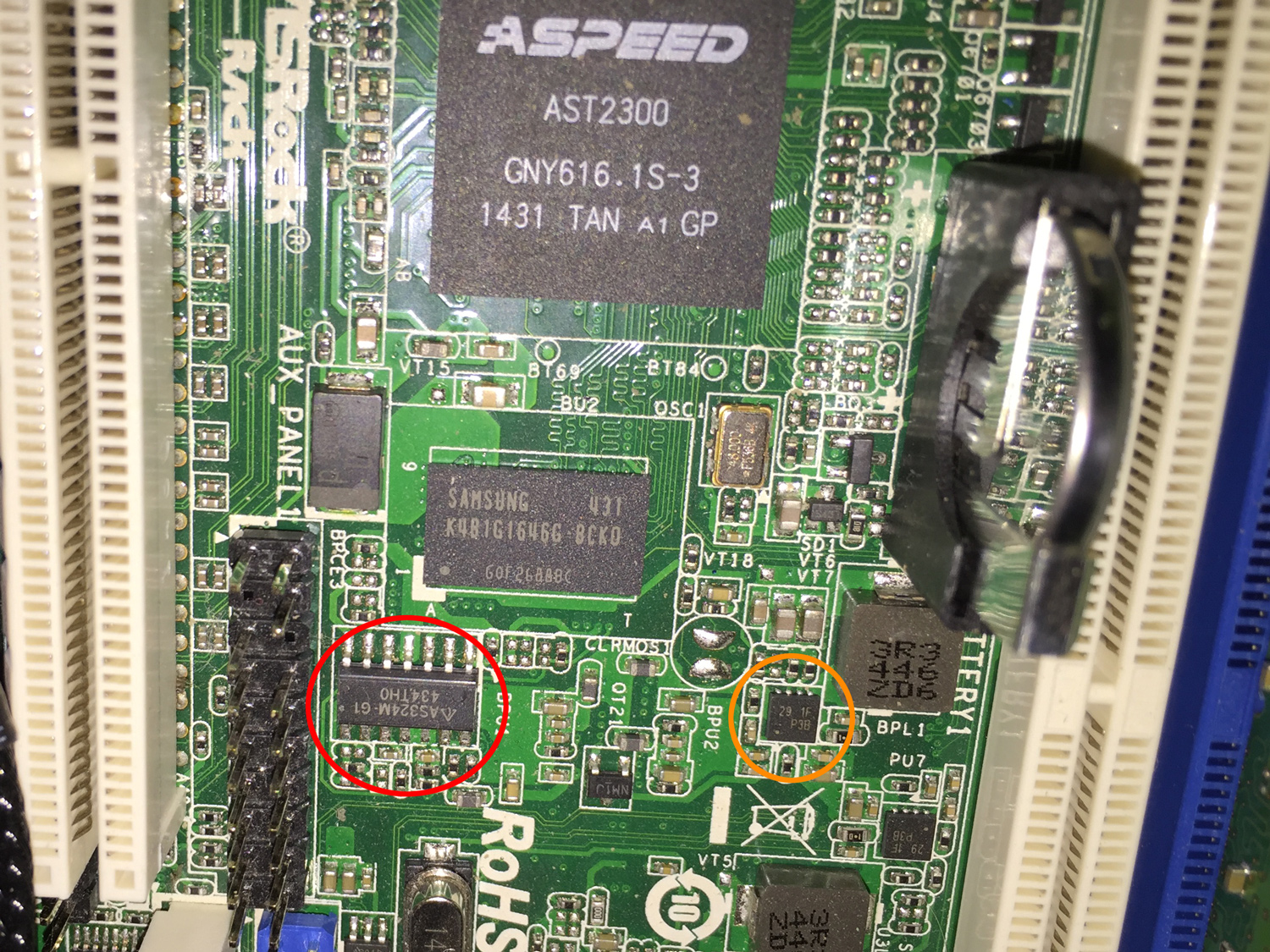

@Ericloewe - here are some close ups of my board, using the same coloured markings as you. The good old 8 pin DIL package is covered up with a sticker, and given that I hope to RMA the board, I'm not going to pull it off.
Mass die off? It certainly can't be universal to the product - the outcry would have been much louder / sooner, but the consistency of reports turning up right now with very similar sounding symptoms and board lifetimes suggests at least a serious and consistent batch issue.

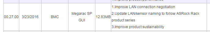

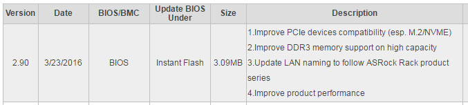

@Pitfrr good questions, I'm sure. In my case, versions are:
- BIOS version: 2.80
- BMC version: 00.23.00
- FreeNAS: FreeNAS-9.3-STABLE-201602031011
You might notice that these are all at least one version behind. I prefer to wait a month or two before applying updates. Board firmware I don't touch unless release notes suggest a very good reason. In this case, AsRock release notes don't suggest they've addressed the issue we suspect (other than a nebulous "improve product performance"):

Thanks for the pics, by the way. I'll look up the part numbers in the morning.

The SPI flash has 4KB sectors and is rated for 100 000+ write/erase cycles. At one write per minute, that's something like three months for it to wear out.
If it's only writing to single page (or handful of pages), it may even be possible to use spare capacity to avoid replacing these chips - since most of the chip would be in order, remapping the bad pages to new ones (after the bug is fixed) would allow these to stay in place.

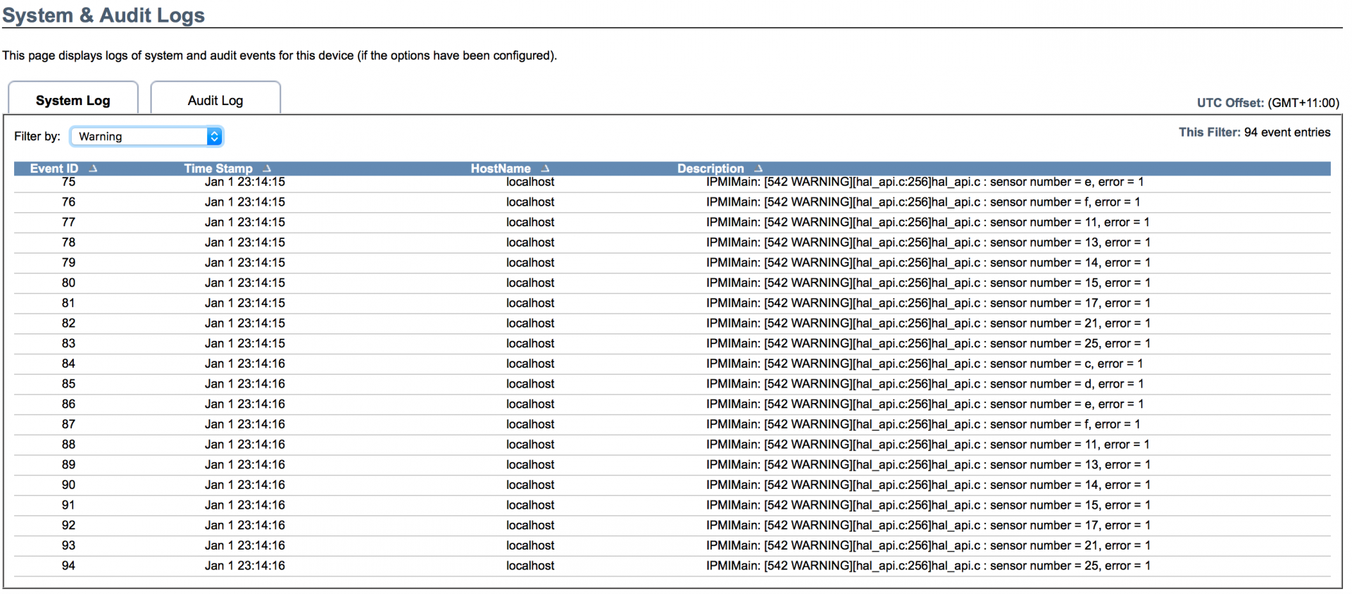

OK... this is weird. As suggested by @Ericloewe, I added a new user to IPMI, just to see what might happen. At first, nothing much interesting - the new user took, and I was able to power cycle and successfully login with the new user. So it obviously worked fine.
In doing that power cycle, the board still did its 3.5 seconds of life thing.

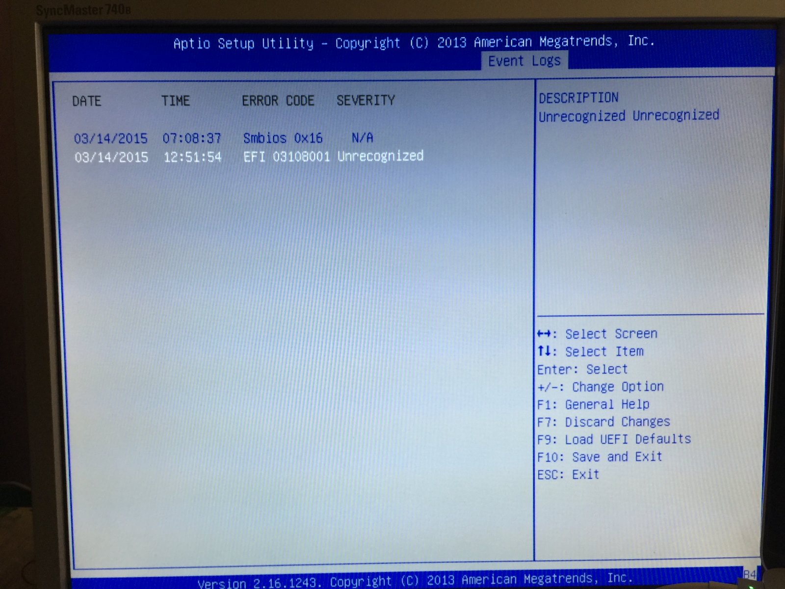

But here's where it gets interesting: a couple of power cycles later, and the board stayed on! A tour of logs / sensors in IPMI suggested things were running (IPMI confirmed that the power state was "on"), but there were some abnormalities (quite a few of the sensors weren't running: some voltage, CPU / MB temperature). OK. Another power cycle, and the board stayed on again, and this time all the sensors are good.
I haven't attempted to boot into FreeNAS yet - as part of earlier fault diagnosis I reset CMOS, so it just boots into the BIOS screen (which I can navigate just fine). Later tonight, I might run a memory test and then attempt to boot FreeNAS (although I won't be risking any of my data drives).
I still consider the board well and truly toasted - there's no way I'd trust it for daily service anymore. But this latest observation certainly provides a few more clues as to what might be going on here. For me, it seems to supports the current theory.
For general interest, here is a grab of some sensor warnings in IPMI (these still seem to be appearing). Also a lone entry in the system log in BIOS - no idea what it means. Let me know if you'd like to see anything else.
Oh and ASRock support? William is awesome - he keeps emailing me and trying to help. Global support? Dial tone. Radio silence. Nada.

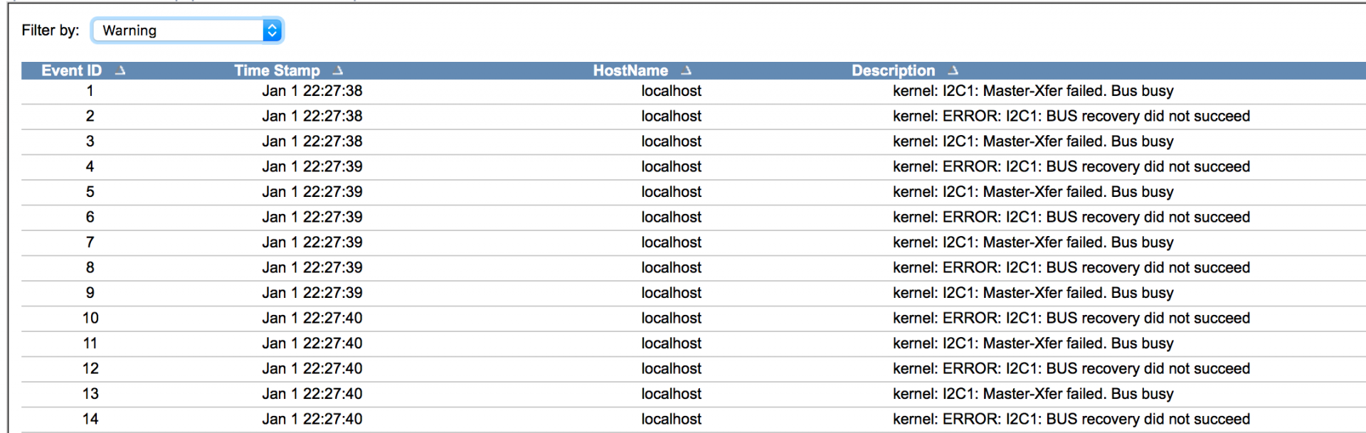

Righto. That was short lived. I left everything powered down for a few hours, came back to it just now and it's all dead again. 3.5 s of power, then no more. I've tried retracing my steps - created a new user, power cycled a couple of times (the new user persisted OK). But this time, nothing happens. It's staying dead.
Nothing much different in IPMI, except for the system log includes a bunch of I2C errors at the warning level.
Oh well...
Not-very-passive-but-aggressive
16,958
So, the BIOS is complaining of a ME engine problem, which is consistent with the BMC failing. What I don't quite understand are the I2C errors - the flash device uses SPI, so maybe the firmware team didn't quite understand the difference between SPI and I2C?
