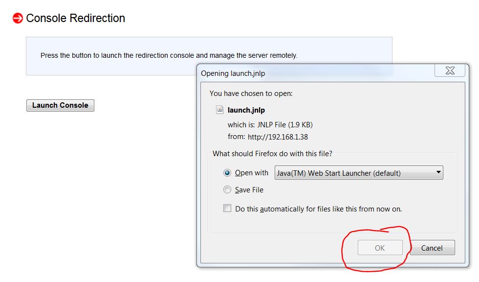

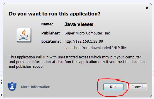

How do you access the BIOS from the IPMI? I am able to power cycle the board from IPMI, but I dont see a BIOS option. My memory is on the QVL 1600 ECC 8GB Crucial CT102472BD160B.18FED 3SE17 D9QBJ Micron
BigDave
FreeNAS Enthusiast
Oct 6, 2013
2,479
These are the steps for my Supermicro board, your mileage may vary...
Log in to your IPMI.
From the Remote Control Tab> choose Console Redirection.
From that page click on the Launch Console button.
A popup window will appear.
allow the Java Viewer by clicking Run.
When the Java iKVM Viewer opens,
select the power control tab and reboot
your machine. When the bios option
appears on the screen, hold your delete key as you normally would.
When you're done, use the exit tab in the iKVM window and close the viewer.
