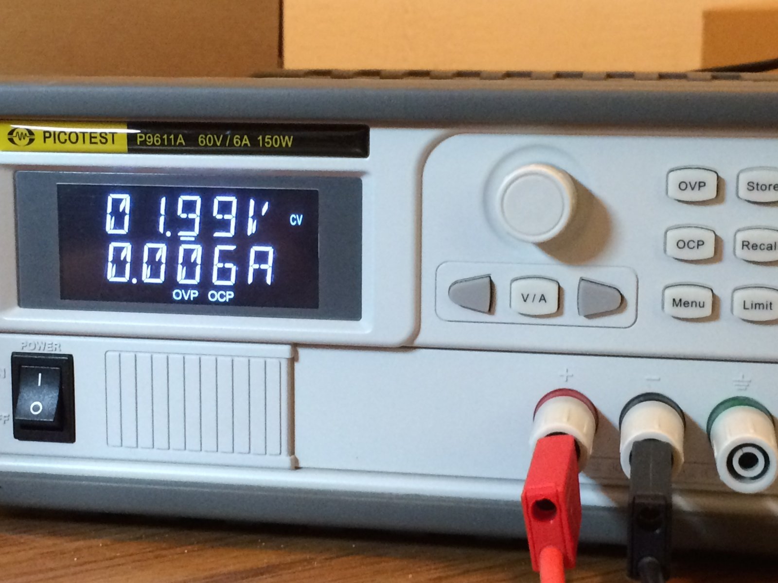

Thanks to @Ericloewe and @nogates. With an external power supply, testing leads, clips and the 10 second delay I was able to boot my no longer booting Asrock c2750d4i board (which previously showed near 97ºC CPU temperature in IPMI).
The Picotest power supply says that PCICLK consumes only 6 mA (@2.00 volts), see pictures.
A Linux reboot command restarts fine without having to do the 10 second delayed PCICLK power supply hack.
PS How hard can it be for Asrock to supply a TPMI header add-on, as a form of customer service, instead of denying warranty exchange requests. I am even willing to pay for the thing.
During BIOS boot, the boot process pauses until +2V signal returns.
That seems to be coherent with the observations over on the other thread, where the CPU seems to get around to booting, but then the boot process doesn't really go anywhere.

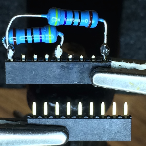

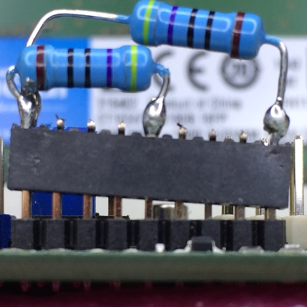

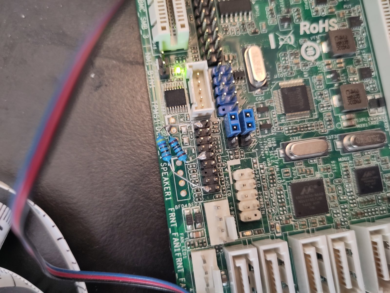

C2750D4I TPM-S voltage divider on a header
The 2 mm spaced 9 pin headers arrived today.
A first attempt with 470 and 470 Ohm doesn't work.
Also the clipped off terminals don't look good.
The resistor leads were routed inside the terminal header. Thus blocking the motherboard pins that should fit in that opening:
In a second attempt the resistor leads were clipped off shorter.
The unused terminals were pulled out of the header (instead of clipped).
Bending and soldering done neater.
Also the resistor values were chosen as in the opening post: 100 ohms on the left side, and 470 ohms on the right side.
The header sits nicely on the mainboard.
And last but not least, the C2750D4I mainboard boots again.

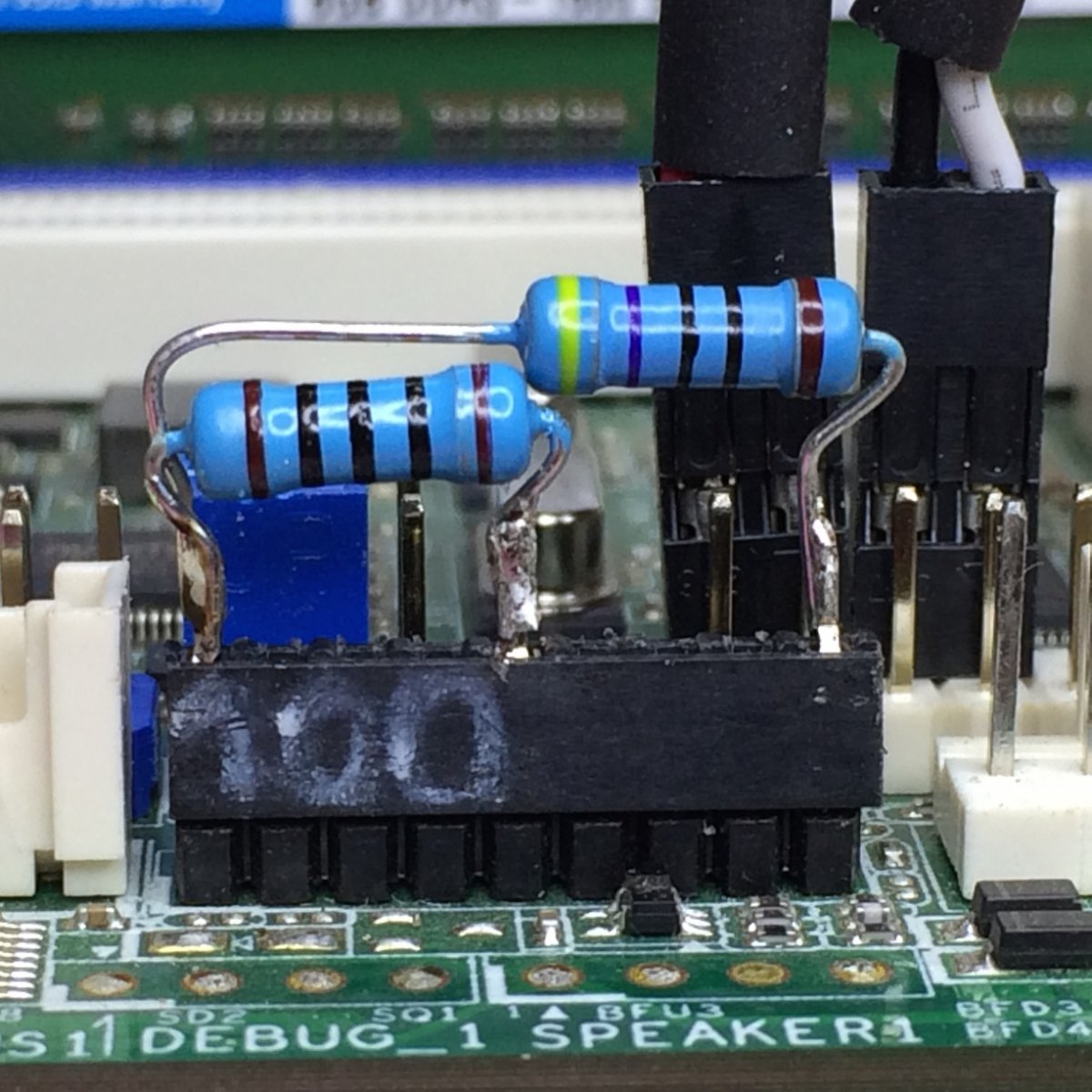

I just used the 100 + 470 ohm method and it worked. I almost can't believe it. Do I need to upgrade my firmware or disabled anything in bios for longevity's sake?
You must update the BMC's firmware to avoid an unrelated bug that destroys the BMC EEPROM.

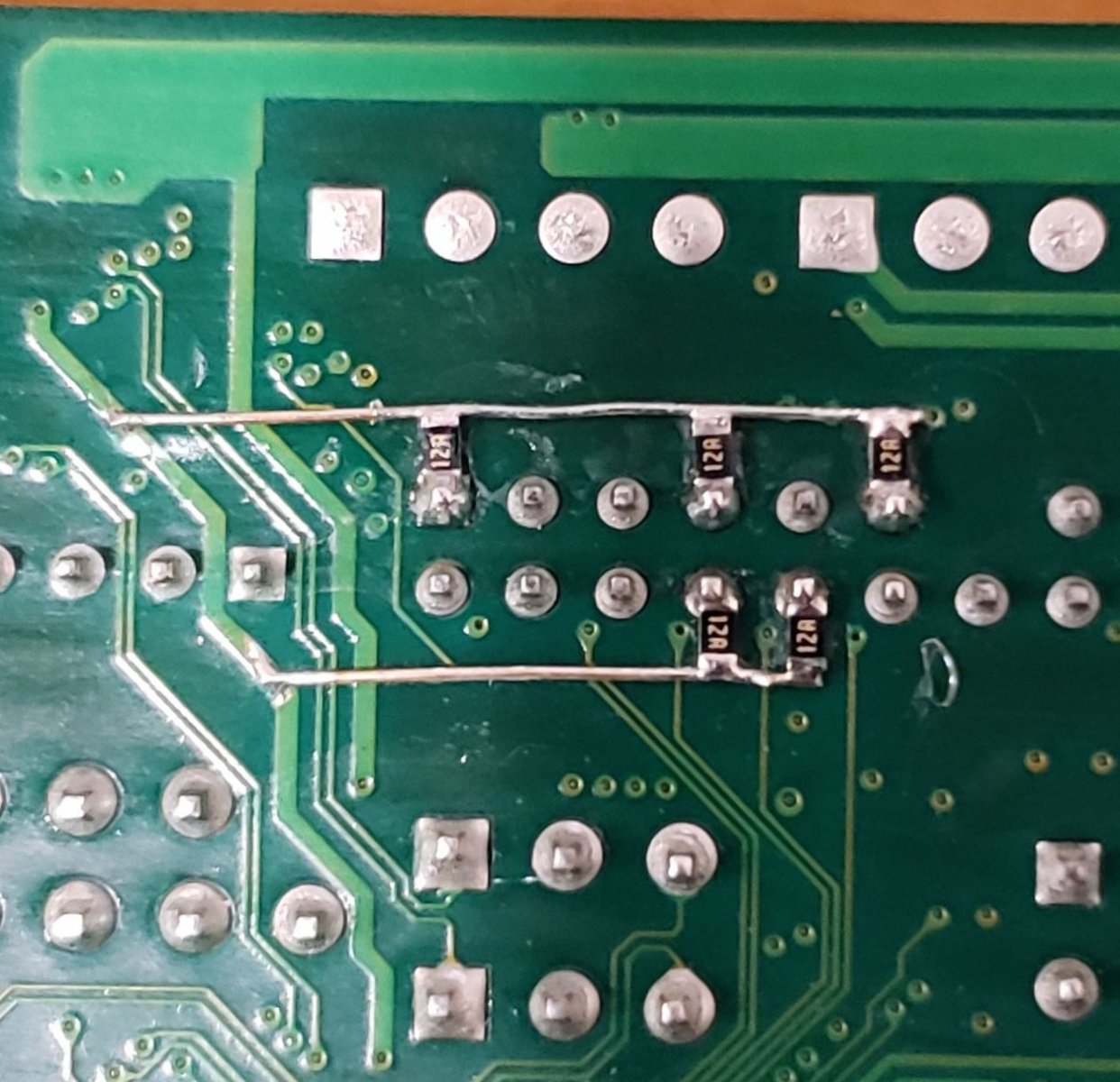

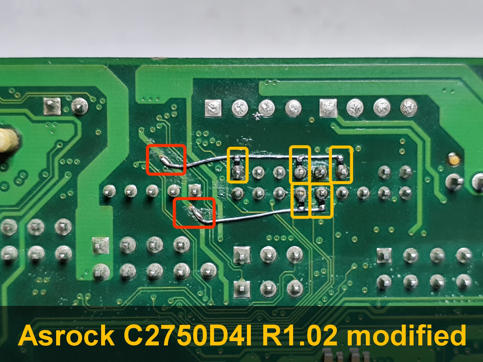

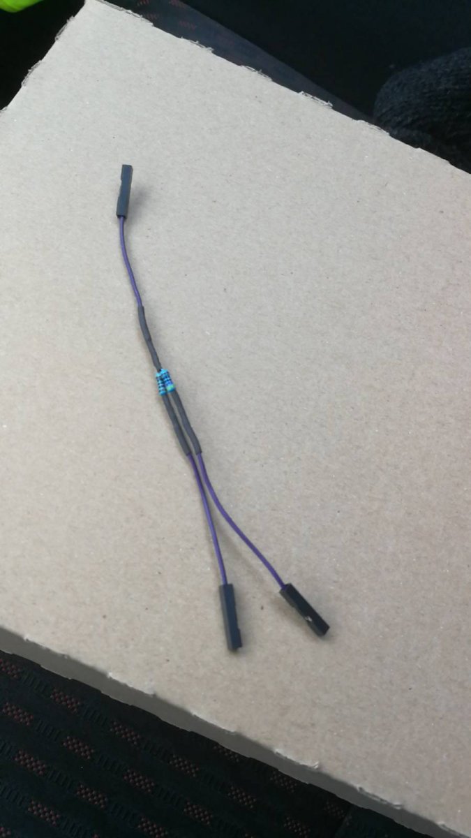

Another success story. Mainboard just died when running fine last week. I am remote right now and have no access to the board, bit asked a friend to make this divider connect and boot. Tested without it no vga output. With the divider works fine, boots, reboots works like a charm at least for now.
You'll probably want to keep those wires shorter, for better signal integrity.

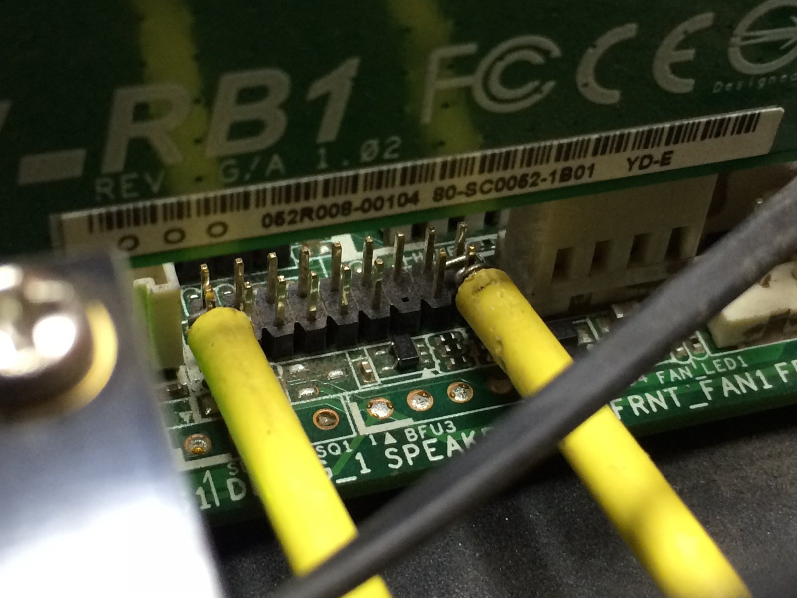

Prong0035
Aug 25, 2023
I did what the first post mentioned, using the same values, placed the same way, with short legs on the resistors and got my server back to working condition.

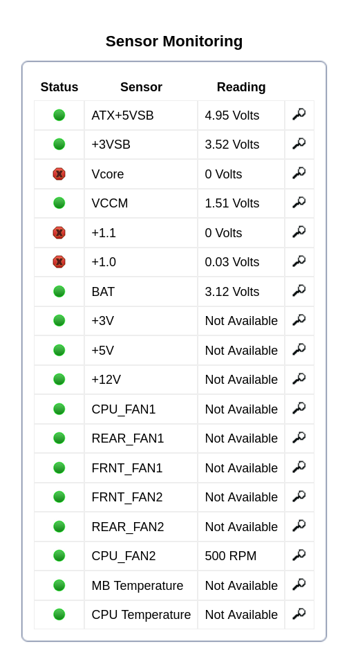

Hi, I have come across a very cheap C2750D4I, revision 1.03, that was supposedly working. I cannot get it to boot up however, and I've eliminated all variables like power supply and RAM. The IPMI lights come on and I can access it, but the system does not POST or display anything over VGA. I have cleared the CMOS and tried with one stick of RAM. I have also tried the 100/470 resistor trick in the OP with no luck.
Here is what I see in the IPMI after I attempt to power on the board. I don't have an oscilloscope to get any readings from it. Any ideas?
Hmm, the screenshot does paint the picture of a dodgy power rail or two...
Do the fans spin up?
An oscilloscope wouldn't be the starting point, but a multimeter would. The board will surely have test pads for those voltage rails somewhere (finding them is likely to not be super fun, but they might be labeled). Cross-checking the BMC's measurements should narrow things down a bit.
If it is a power delivery issue, a repair will probably be too complex for most people to be comfortable with it, but any decent repair shop might be able to take it on, assuming you can narrow it down and acquire the necessary parts.
Yes, fans connected to motherboard headers do spin up. I will bust out the multimeter and start searching. Thanks.
