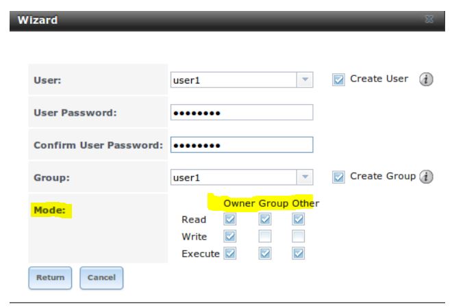

I get hung up on the mode checkboxes (pic attached). For the example in the pic, they are setting up a share for a single user to access. The user is user1, and that's also the name of the group. So user1 is the only person that can touch this share. The owner (R/W/E) are all checked off, but Group and Other cannot write. This is confusing. Was an actual group: user1 actually created? And does Other mean that other people can read and execute the files?
