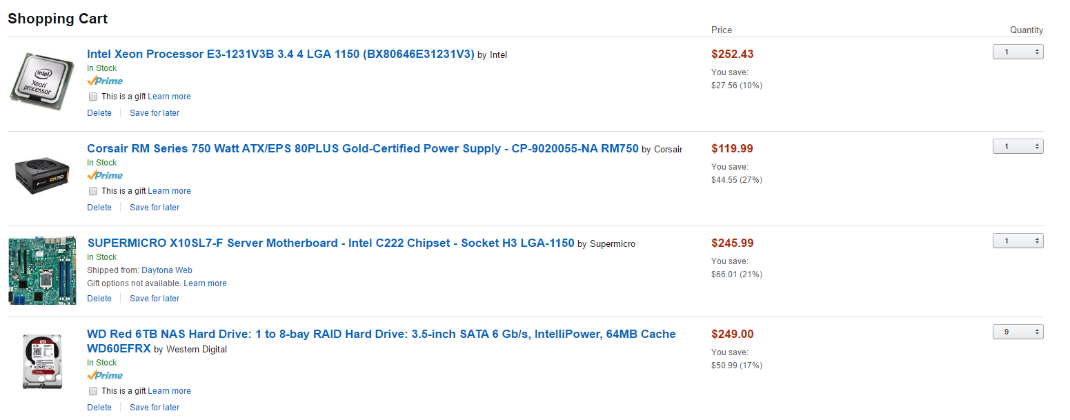

For anyone who's interested, I think I've nailed down the hardware I'm going to get.
And two of these (32 gigs total): http://www.crucial.com/usa/en/x10sl7-f/CT4484984
