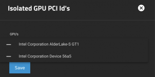

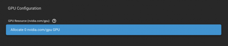

I recently picked up an Intel Arc A380 and installed into my TrueNAS-SCALE-Bluefin system, however have been unable to allocate it to apps and instead it is showing the GPU resource as an "nvidia.com/gpu" configuration instead. Previously I have ran a nvidia 30 series card to test the hardware encoding.
The card is read by the system fine as shown in the 'isolated GPU PCI Id's but for some reason I am just not able to allocate apps to utilise it. Looking at the forums, it seems some people are able to use intel GPU devices so it may be an issue on my end, however as they are relatively new and somewhat difficult to search for the case may be because it is simply unsupported as of yet.
I apologise in advance for my lack of codes, I have no idea where to look for this and how to assist anyone who would be kind enough to help (I've gone through so many pages on google and the forums which is why I've created an account and posted this thread)
Screenshot 2023-01-12 at 7.48.39 AM.png Screenshot 2023-01-12 at 7.51.19 AM.png
