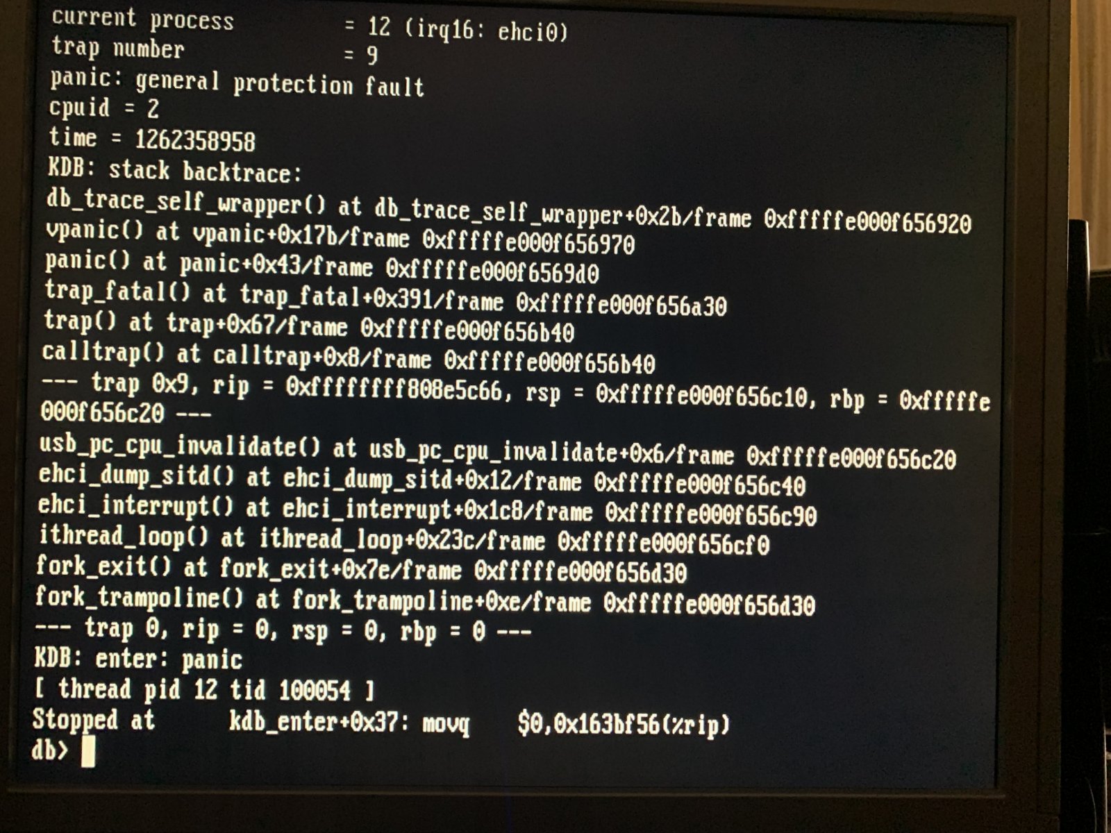

Hello everyone and thank you very much in advance for your help. I discovered Thunderas a few days ago and I'm trying to test before making a higher expense, that's why I'm trying to install Thunderas in an old recycled computer, at the moment only with a hard drive to install Trienas and when I get it to work I'll buy the HDD big. The computer I am trying to install on is: Matherboard: Acer H57D02P8
Processor: Intel i3
Memory: 8Gb
HDD: 250Gb
Net card: Motherboard.
I do the entire installation process and when I tell it where to install Thunder, it starts the installation and stops and doesn't install, it stays on the screen of the attached image. I have no idea what can happen. Does anyone know what can happen and why the program does not install? Thank you.

I'm sure you mean TrueNAS vice Thunderas.
I suspect that your computer is unstable. You should stress test the system to ensure it is stable, you could have something bad with the hardware. Use programs like MemTest86+ and Prime95. Also, you should have a minimum of two drives in order to test TrueNAS, one drive at least 8GB for the operating system and one drive for the pool/data storage (the 250GB drive is fine).
Lastly, I would recommend you try the other version of TrueNAS. You didn't specify if you were running CORE or SCALE, but try the other version if stress testing passes.

Thats a FreeBSD panic message.. After checking you hardware you can try TrueNAS SCALE to see if it's a driver issue as well.

Thank you both for your response. I am trying to install Thunder CORE.
I have verified that the memory is not ECC and that the motherboard does not support ECC memory. Could that be the problem?
Kris Moore; You tell me, with the hardware I have, try to install TrueNAS SCALE to see if it's a driver issue. What driver?

CORE and SCALE run different operating systems. If CORE is failing, it may be worth trying out SCALE which has much more broad driver support for random hardware.
