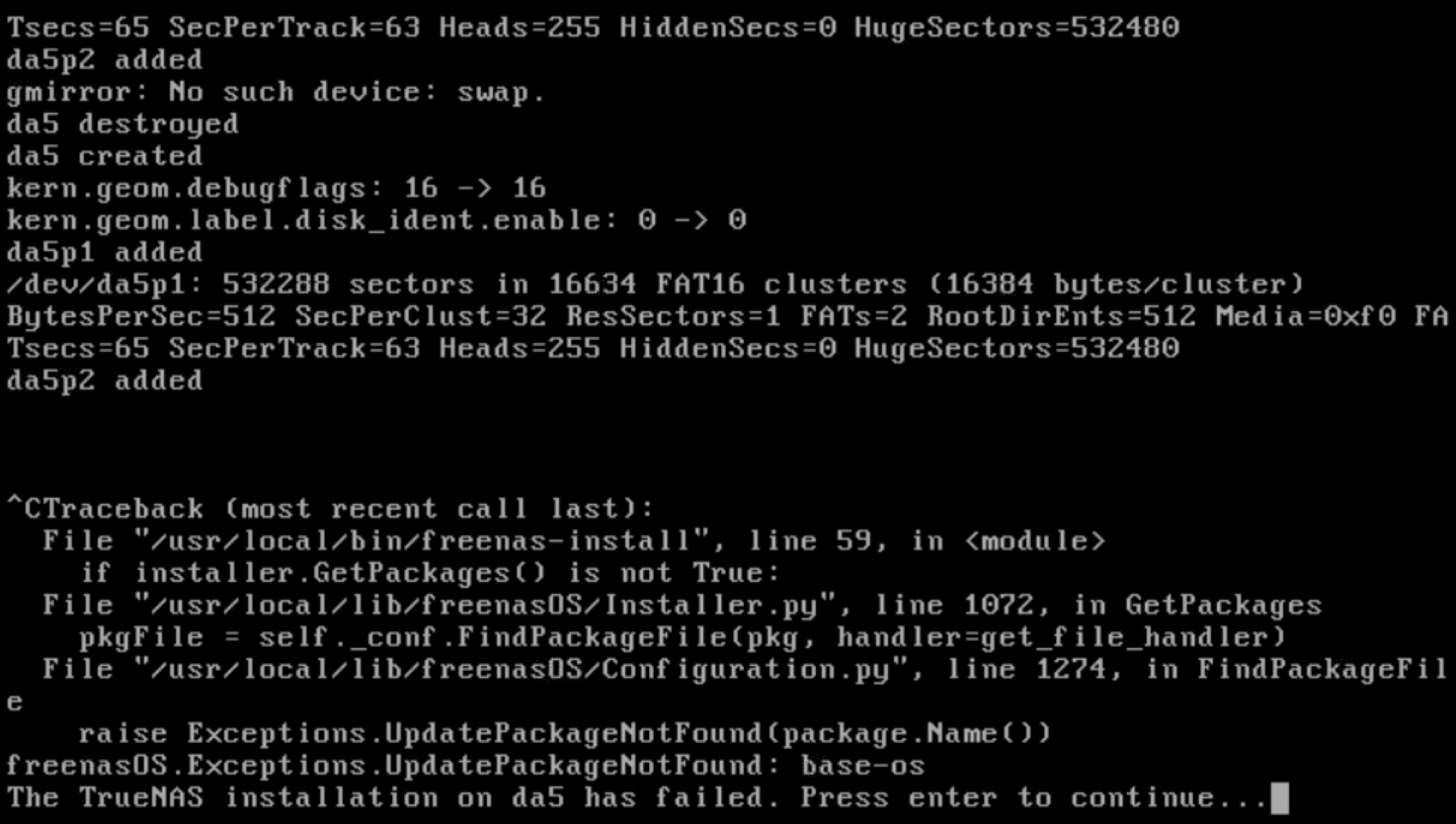

Created install medium from ISO on Ubuntu using dd. When booted and choosing Install on an SSD, I see the following message:
File "/usr/local/bin/freenas-install", line 59, in <module>
   if installer.GetPackages() is not True:
File "/usr/local/lib/freenasOS/Installer.py", line 1072, in GetPackages
  pkgFile = self._conf.FindPackageFile(pkg, handler=get_file_handler)
File "/usr/local/lib/freenasOS/Configuration.py", line 1274, in FindPackageFile
  raise Exceptions.UpdatePackageNotFound(package.Name())
freenasOS.Exceptions.UpdatePackageNotFound: base-os
The FreeNAS installation on ada0 has failed. Press enter to continue...
