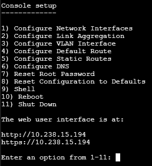

I use: 1) Configure Network Interfaces
I get: The web interface could not be accessed. Please check network configuration.

Something has assigned 10.238.15.194 to TrueNAS.
By default (in a new install) TrueNAS is set to get an IP address from DHCP - Its extremely likely that the 10.238.15.194 comes from a DHCP Server somewhere
Looks to me like your network isn't what you think it is - or has other strange stuff on it
I suggest manually assigning 192.168.1.120 / 255.255.255.0 to TrueNAS through the console
I am assuming that your PC (the one you are on) has an address of 192.168.1.xxx with a subnet of 255.255.255.0

Okay, new Intel NIC with the YottaMark sticker installed. I get the same result. IP of 0.0.0.0 and when I try selection 1) on the console I get: The web interface could not be accessed.

OIK. that's good - and you have the console menu up?
Select option 1
You are looking for an interface named em0 - when it shows in the list, type the number adjacent to it to select it.
