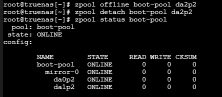

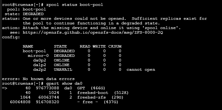

Not sure if anyone has thought about this or tried it yet, but think I just found a WAY easier way to do this. If you are installing fresh from start, or do not care about your existing install, you can run the installer and install to your SSD AND the flash drive at the same time, just select them all on the installer. This will create the partitions with the flash drive size on the SSDs, but leave the extra space open. Once the install is finished, reboot, unplug the flash drive and remove it from the pool.
zpool offline boot-pool <flash drive>
zpool detach boot-pool <flash drive>
Attached are a couple of screenshots to show how this looked once it was done.

acdoussan
Nov 6, 2021
Also, I was also having the same issue as others where I was getting the "can only attach to mirrors and top-level disks" error message, due to mismatched block sizes. Installing in this manner allowed me to get around that without manually setting block sizes and having the warning message when running "zpool status boot-pool"
Thank you, @acdoussan. I could reproduce your approach by installing on both a 64 GB USB stick and a larger M.2 SATA SSD that now hosts my jails in addition to the boot pool. Also thanks to @Patrick M. Hausen for the original how-to.
