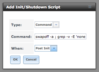

In the GUI, click on Tasks -> Init/Shutdown Scripts, Add Init/Shutdown Script:
Then add a "Command" where the command is the following
swapoff -a ; grep -v -E 'none[[:blank:]]+swap[[:blank:]]' /etc/fstab > /etc/fstab.new && echo "md99 none swap sw,file=/usr/swap0,late 0 0" >> /etc/fstab.new && mv /etc/fstab.new /etc/fstab ; swapon -aL
And set it to "Post Init" for "When"

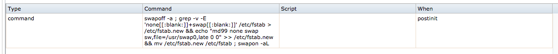

When finished it should look like this.
