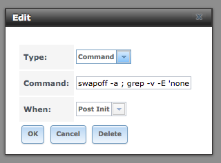

And finally, in the GUI, click on Tasks -> Init/Shutdown Scripts, Add Init/Shutdown Script:
Then add a "Command" where the command is the following
swapoff -a ; grep -v -E 'none[[:blank:]]+swap[[:blank:]]' /etc/fstab > /etc/fstab.new && echo "/dev/gptid/<gptid>.eli none swap sw 0 0" >> /etc/fstab.new && mv /etc/fstab.new /etc/fstab ; swapon -a
Note: change the <gptid> in the above command to use the gptid that you retrieved from glabel in the above steps, ie the bit after "gptid/". Do not include the angle brackets (<>) in the final command
And set it to "Post Init" for "When"

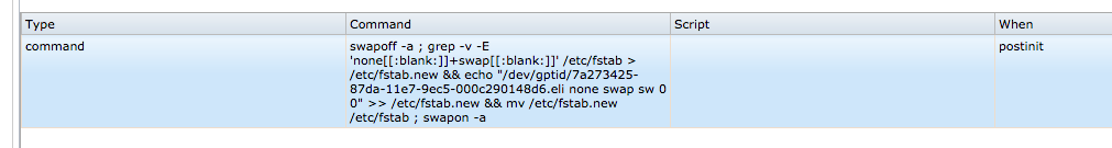

When finished it should look something like this, of course, your gptid will be different.
