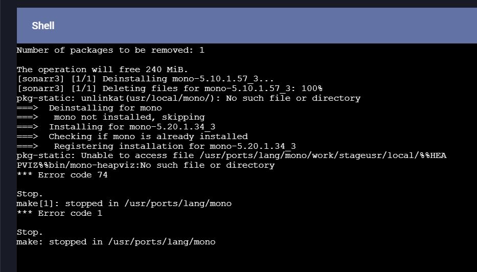

still getting that

Try from a completely fresh jail.
From FreeNAS root...
iocage create -r 11.3-RELEASE -n monotst dhcp=on
iocage start monotst
iocage console monotst
portsnap fetch extract
fetch 'https://bz-attachments.freebsd.org/attachment.cgi?id=211011' -o /tmp/mono-patch-6.8.0.96
cd /usr/ports/lang/mono
patch -E < /tmp/mono-patch-6.8.0.96
make -DBATCH install clean
make -DBATCH deinstall reinstall
If that works it is something you did to the jail you are trying to upgrade. If that doesn't work then you are either changing something from the outlined commands or something is screwed up with your install of FreeNAS.

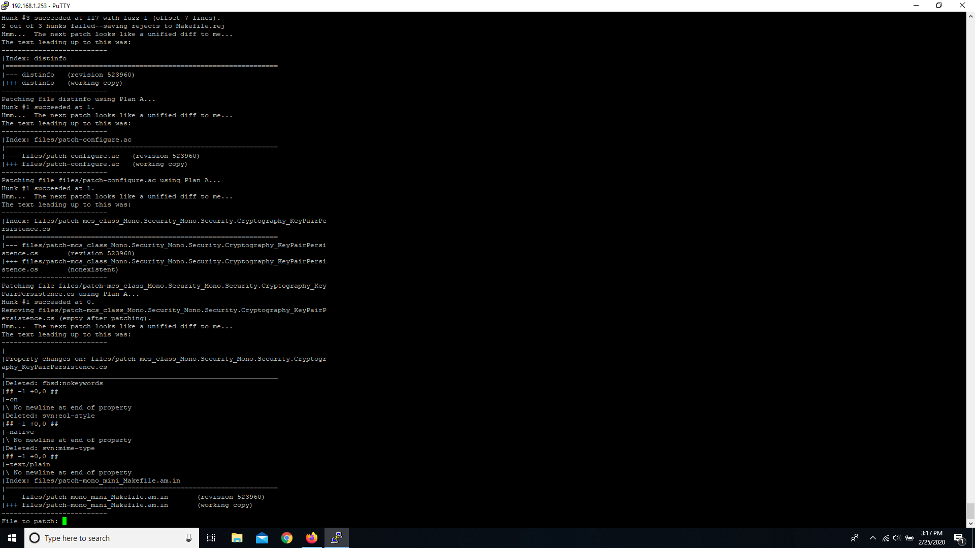

Hey, I've been following this thread since I've been having issues like some others. I am currently running FreeNAS-11.3-U1. I followed these codes exactly (with one exception on the fetch command I had to add "--no-verify-peer" to "fetch 'https://bz-attachments.freebsd.org/attachment.cgi?id=211011' -o /tmp/mono-patch-6.8.0.96" in order to bypass a certificate verification failed error) and I am still having issues getting the prompt "File to Patch". Any idea on what could be causing this?
Did you try creating a fresh jail as I suggested to hertzsae? If a fresh jail works then it is something specific to your existing jail that is causing the issue.

I tried. Almost yours commands of new jail creation (just added ssl):
iocage create -r 11.3-RELEASE -n monotest dhcp=on iocage start monotest iocage console monotest mkdir -p /usr/local/etc/pkg/repos echo 'FreeBSD: {url: "pkg+http://pkg.FreeBSD.org/${ABI}/latest"}' > /usr/local/etc/pkg/repos/FreeBSD.conf pkg install -y ca_root_nss portsnap fetch extract fetch 'https://bz-attachments.freebsd.org/attachment.cgi?id=211011' -o /tmp/mono-patch-6.8.0.96 cd /usr/ports/lang/mono patch -E < /tmp/mono-patch-6.8.0.96
As a result we have this output:
root@freeNAS:/ # iocage create -r 11.3-RELEASE -n monotest dhcp=on
dhcp requires vnet, enabling!
dhcp requires bpf, enabling!
monotest successfully created!
root@freeNAS:/ # iocage start monotest
* Starting monotest
  + Started OK
  + Using devfs_ruleset: 6
  + Configuring VNET OK
  + Using IP options: vnet
  + Starting services OK
  + Executing poststart OK
  + DHCP Address: 192.168.1.120/24
root@freeNAS:/ # iocage console monotest
FreeBSD 11.3-RELEASE-p6 (FreeNAS.amd64) #0 r325575+d5b100edfcb(HEAD): Fri Feb 21 18:53:26 UTC 2020
Welcome to FreeBSD!
[...Message cut...]
Edit /etc/motd to change this login announcement.
root@monotest:~ # mkdir -p /usr/local/etc/pkg/repos
root@monotest:~ # echo 'FreeBSD: {url: "pkg+http://pkg.FreeBSD.org/${ABI}/latest"}' > /usr/local/etc/pkg/repos/FreeBSD.conf
root@monotest:~ # pkg install -y ca_root_nss
The package management tool is not yet installed on your system.
Do you want to fetch and install it now? [y/N]: y
Bootstrapping pkg from pkg+http://pkg.FreeBSD.org/FreeBSD:11:amd64/latest, please wait...
[monotest] Installing pkg-1.13.2...
[monotest] Extracting pkg-1.13.2: 100%
Updating FreeBSD repository catalogue...
[monotest] Fetching meta.conf: 100%    163 B   0.2kB/s    00:01
[monotest] Fetching packagesite.txz: 100%    6 MiB   1.3MB/s    00:05
Processing entries: 100%
FreeBSD repository update completed. 31427 packages processed.
All repositories are up to date.
Updating database digests format: 100%
The following 1 package(s) will be affected (of 0 checked):
New packages to be INSTALLED:
        ca_root_nss: 3.50
Number of packages to be installed: 1
288 KiB to be downloaded.
[monotest] [1/1] Fetching ca_root_nss-3.50.txz: 100%  288 KiB 295.1kB/s    00:01
Checking integrity... done (0 conflicting)
[monotest] [1/1] Installing ca_root_nss-3.50...
[monotest] [1/1] Extracting ca_root_nss-3.50: 100%
Message from ca_root_nss-3.50:
[... Message cut...]
If you prefer to do this manually, replace the following symlinks with
either an empty file or your site-local certificate bundle.
  * /etc/ssl/cert.pem
  * /usr/local/etc/ssl/cert.pem
  * /usr/local/openssl/cert.pem
root@monotest:~ # portsnap fetch extract
Looking up portsnap.FreeBSD.org mirrors... 6 mirrors found.
Fetching public key from ec2-ap-northeast-1.portsnap.freebsd.org... done.
Fetching snapshot tag from ec2-ap-northeast-1.portsnap.freebsd.org... done.
Fetching snapshot metadata... done.
Fetching snapshot generated at Fri Mar  6 03:07:46 MSK 2020:
82ae2cbdbee69b4371b8b15b03b9f1ed1bc5da3955f46e          83 MB 2813 kBps    31s
Extracting snapshot... done.
Verifying snapshot integrity... done.
[...Dir listing cut...]
/usr/ports/x11/zenity/
Building new INDEX files... done.
root@monotest:~ # fetch 'https://bz-attachments.freebsd.org/attachment.cgi?id=211011' -o /tmp/mono-patch-6.8.0.96
/tmp/mono-patch-6.8.0.96                               117 kB  185 kBps    00s
root@monotest:~ # cd /usr/ports/lang/mono
root@monotest:/usr/ports/lang/mono # patch -E --dry-run < /tmp/mono-patch-6.8.0.96
Hmm...  Looks like a unified diff to me...
The text leading up to this was:
|Index: Makefile
|--- Makefile   (revision 523960)
|+++ Makefile   (working copy)
Patching file Makefile using Plan A...
Hunk #1 failed at 2.
Hunk #2 failed at 13.
Hunk #3 succeeded at 117 with fuzz 1 (offset 7 lines).
2 out of 3 hunks failed while patching Makefile
Hmm...  The next patch looks like a unified diff to me...
|Index: distinfo
|--- distinfo   (revision 523960)
|+++ distinfo   (working copy)
Patching file distinfo using Plan A...
Hunk #1 succeeded at 1.
|Index: files/patch-configure.ac
|--- files/patch-configure.ac   (revision 523960)
|+++ files/patch-configure.ac   (working copy)
Patching file files/patch-configure.ac using Plan A...
|Index: files/patch-mcs_class_Mono.Security_Mono.Security.Cryptography_KeyPairPersistence.cs
|--- files/patch-mcs_class_Mono.Security_Mono.Security.Cryptography_KeyPairPersistence.cs       (revision 523960)
|+++ files/patch-mcs_class_Mono.Security_Mono.Security.Cryptography_KeyPairPersistence.cs       (nonexistent)
Patching file files/patch-mcs_class_Mono.Security_Mono.Security.Cryptography_KeyPairPersistence.cs using Plan A...
Hunk #1 succeeded at 0.
|Property changes on: files/patch-mcs_class_Mono.Security_Mono.Security.Cryptography_KeyPairPersistence.cs
|___________________________________________________________________
|Deleted: fbsd:nokeywords
|## -1 +0,0 ##
|-on
|\ No newline at end of property
|Deleted: svn:eol-style
|## -1 +0,0 ##
|-native
|Deleted: svn:mime-type
|## -1 +0,0 ##
|-text/plain
|Index: files/patch-mono_mini_Makefile.am.in
|--- files/patch-mono_mini_Makefile.am.in       (revision 523960)
|+++ files/patch-mono_mini_Makefile.am.in       (working copy)
File to patch:
No file found--skip this patch? [y]
Don't know what to do with this issue.

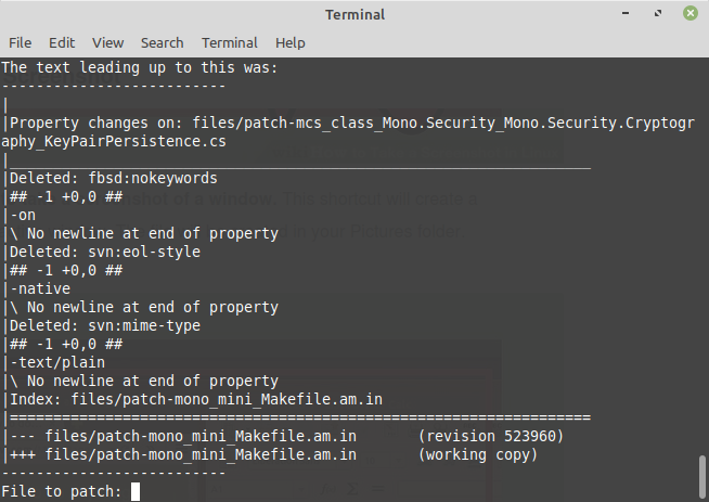

ChaosBlades
Jul 4, 2015
137
[snip]
Can confirm, it is happening to me as well. My guess is that the files got updated and moved around in /usr/ports/lang/mono and don't match what that particular patch is looking for anymore. Also getting the SLL error now and needed to install ca_root_nss.
The latest patch (6.8.0.105) from the bug thread isn't working either... R.I.P.

Looked deeply into it and finally found the solution. We have the following 2 problems from previously proposed steps in the thread:
- Patch mono-6.8.0.96 works for Revision 2 and is not valid any more, as we already have Revision 3 in Ports. So we have to use 6.8.0.105 for compilation
- The way new patch should be applied is different from 6.8.0.96. Patch for 6.8.0.105 should be patched from /usr/ports/lang with another copy of the sources to different directory.
So here's the working script to install, make and move to root dir package for jail from scratch (I'm using bash because csh has different syntax for quotes):
echo '{"pkgs":["ca_root_nss","llvm80","libepoxy-1.5.2"]}' > /tmp/pkg.json iocage create -n mono_patch -p /tmp/pkg.json -r 11.3-RELEASE dhcp="on" vnet="on" bpf="yes" boot="on" rm /tmp/pkg.json iocage exec mono_patch "fetch 'https://bugs.freebsd.org/bugzilla/attachment.cgi?id=211960' -o /tmp/mono-patch-6.8.0.105" iocage exec mono_patch "mkdir -p /usr/local/etc/pkg/repos" iocage exec mono_patch "echo -e 'FreeBSD: { url: \"pkg+http://pkg.FreeBSD.org/\${ABI}/latest\" }' > /usr/local/etc/pkg/repos/FreeBSD.conf" iocage exec mono_patch "pkg update" iocage exec mono_patch "pkg upgrade -y" iocage exec mono_patch "portsnap fetch extract" iocage exec mono_patch "echo -e 'cd /usr/ports/lang' > /tmp/mono_patch.sh" iocage exec mono_patch "echo -e 'cp -R mono mono68105' >> /tmp/mono_patch.sh" iocage exec mono_patch "echo -e 'patch -E < /tmp/mono-patch-6.8.0.105' >> /tmp/mono_patch.sh" iocage exec mono_patch "echo -e 'cd /usr/ports/lang/mono' >> /tmp/mono_patch.sh" iocage exec mono_patch "echo -e 'make -DBATCH install' >> /tmp/mono_patch.sh" iocage exec mono_patch "echo -e 'make -DBATCH package' >> /tmp/mono_patch.sh" iocage exec mono_patch "echo -e 'mv /usr/ports/lang/mono/work/pkg/mono-6.8.0.105.txz /' >> /tmp/mono_patch.sh" iocage exec mono_patch "sh /tmp/mono_patch.sh"
Compilation will take some time. Enjoy!
