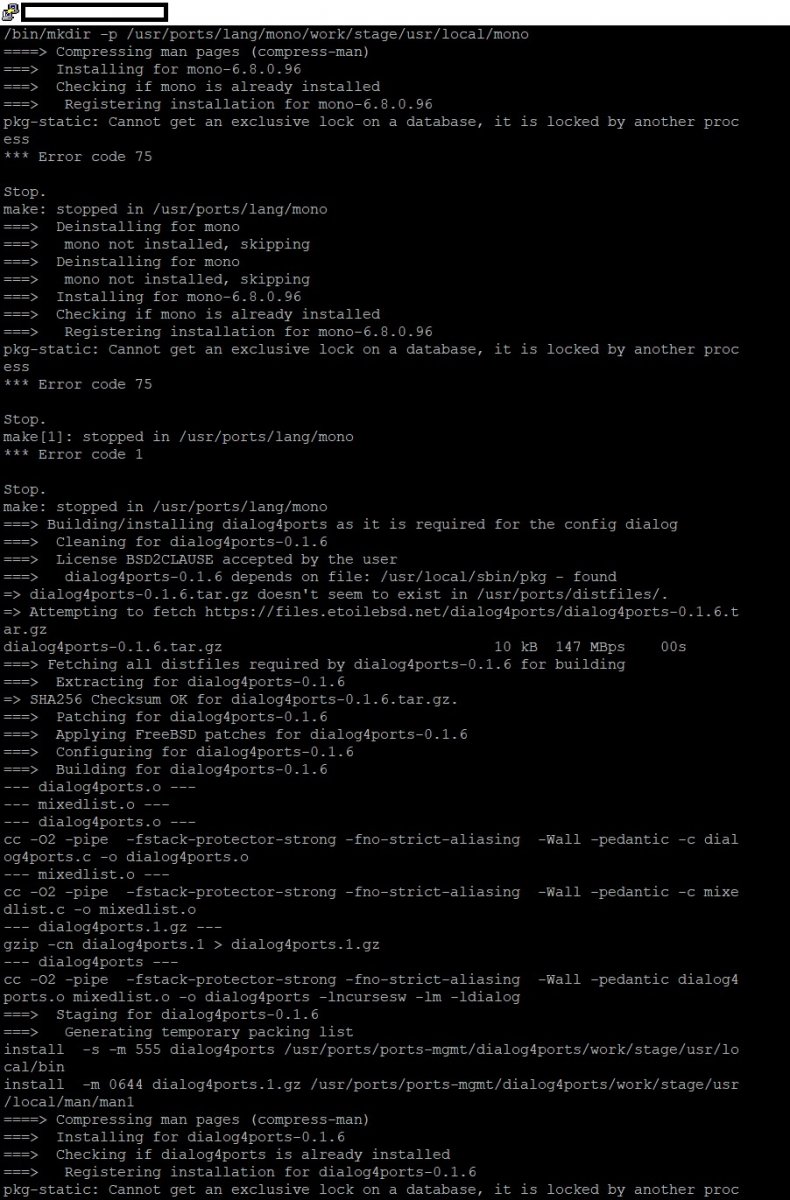

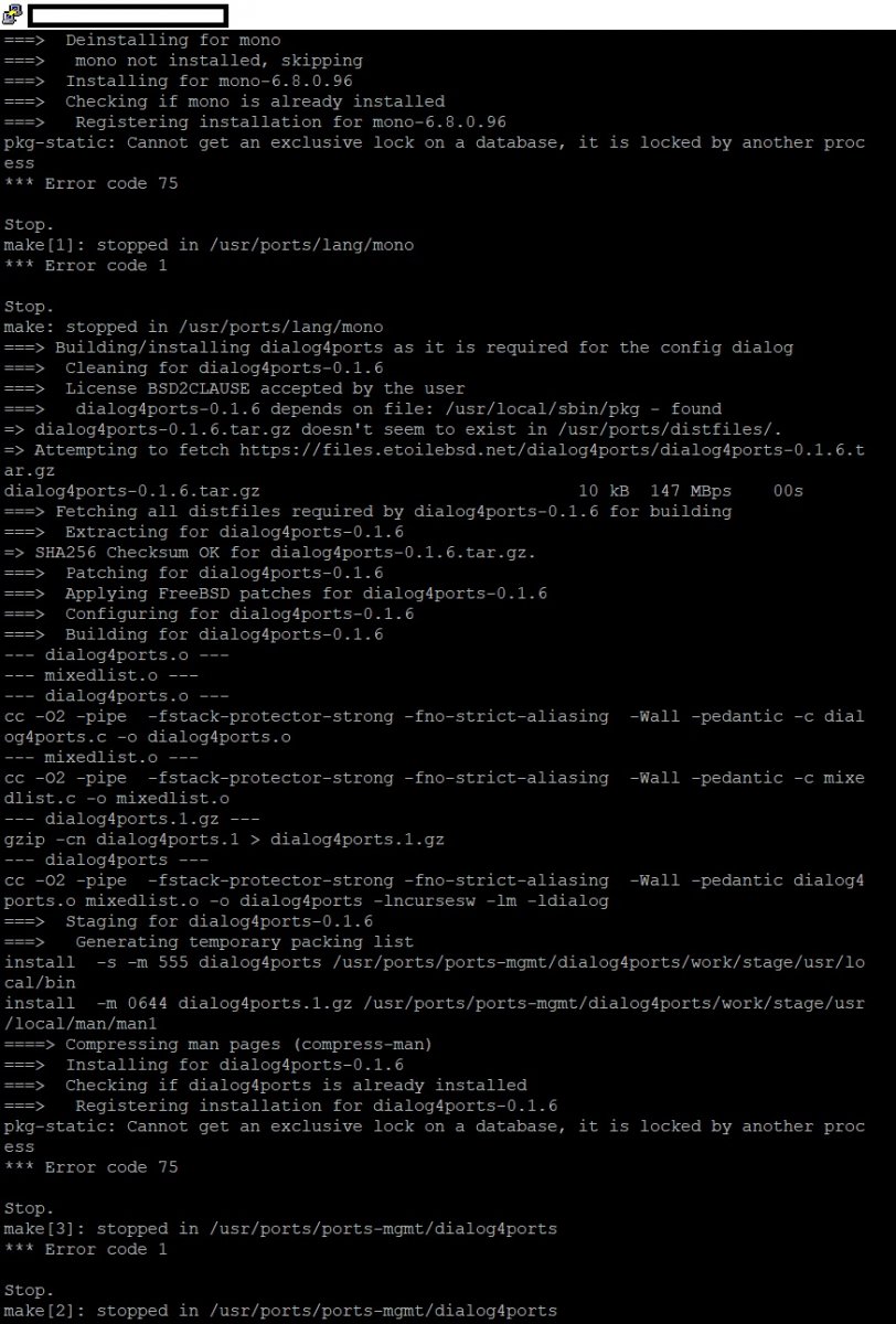

@thxtex I ran ur script, but it's giving me the following errors:
(My system is on Freenas 11.3 and jails @ 11.3-RELEASE-p6)
===> Installing for mono-6.8.0.96 ===> Checking if mono is already installed ===> Registering installation for mono-6.8.0.96 pkg-static: Cannot get an exclusive lock on a database, it is locked by another process *** Error code 75 Stop. make: stopped in /usr/ports/lang/mono ===> Deinstalling for mono ===> mono not installed, skipping ===> Deinstalling for mono ===> mono not installed, skipping ===> Installing for mono-6.8.0.96 ===> Checking if mono is already installed ===> Registering installation for mono-6.8.0.96 pkg-static: Cannot get an exclusive lock on a database, it is locked by another process *** Error code 75 Stop. make[1]: stopped in /usr/ports/lang/mono *** Error code 1
I am getting these errors, both for mono & dialogports it seems. Any idea what could be causing this? :S

Looks like you didn't stop all services running mono before modifying it. The first and last commands from my guide still apply when using the script
Stop all services running mono. Should be "sonarr", "radarr", "lidarr", and "jackett".
service lidarr stop
*run script*
Restart all services running mono
service lidarr start

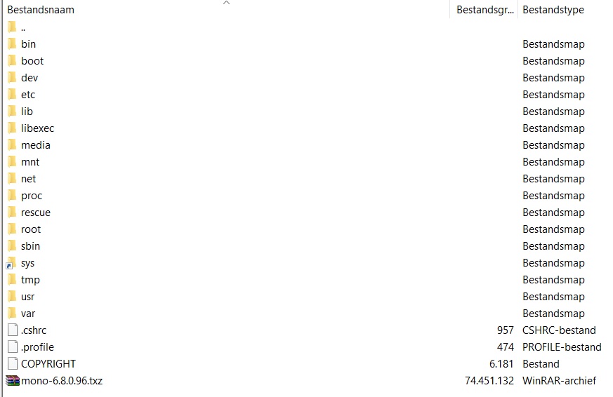

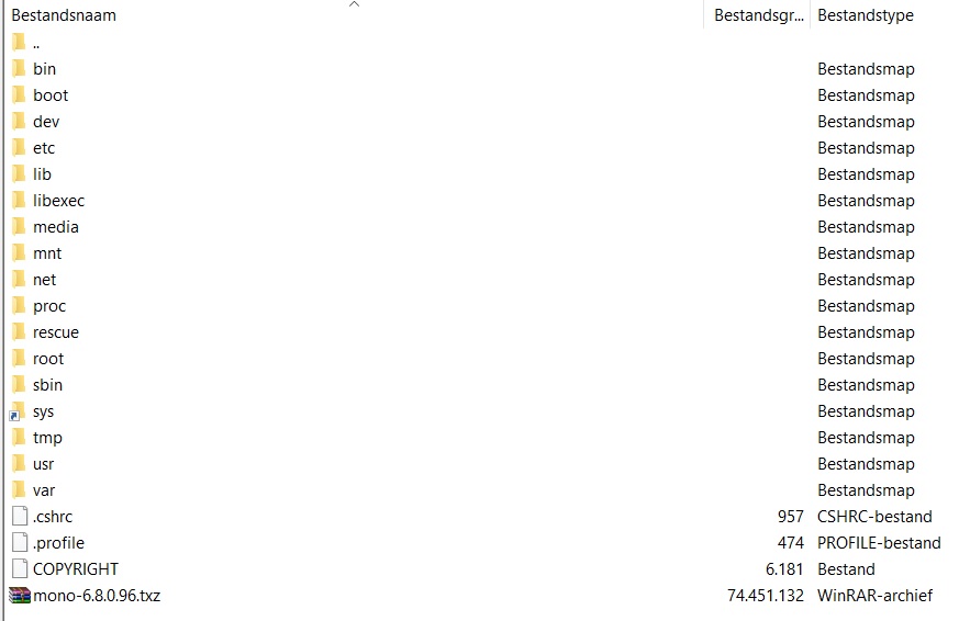

I tried it again, and now it seems to have succeeded, although i'm not sure what exactly i have to copy where after the script has completed?
I now have a jail named: mono-patch @ /mnt/tank/iocage/jails/mono_patch/root, containing the following files and folders:
What are the next steps i should take?

The way I understood it was that you copy the mono-6.8.0.96.txz into the root of the jail you want to install mono 6.8 in then run pkg add /mono-6.8.0.96.txz but when I did this it kept asking for dependancies I was missing. Once I got all those installed and then subsequently mono 6.8 installed I tried Jackett and almost every tracker failed with an SSL error. At this point, I reverted to the tried and true method. I figure I did something wrong but I'm not going to bother. The way I understand it the script method only saves you CPU time and about 3-4GB per jail in storage space. Not worth it for me to spend the time to research what went wrong.

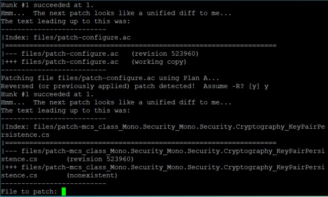

i tried following this step, but when i get to patch -E < /tmp/mono-patch-6.8.0.96 its saying it cant find file..... can you get me the text for nano so i can update this

I also tried following these steps, with a fresh 11.3 jail, but get the following, (which is probably the same issue @Andre Clarke is having) What am i missing? :
I have gotten that before and it was a typo in a command or I didn't cd into the mono ports directory before I tried to patch. The error is saying it is looking for a file and can't find it.
If anyone wants to save a few GB and remove the EOL python 2 packages the following commands will clean up the ports directories from compiling mono and delete python 2. Tested on radarr, sonarr, jackett, and lidarr.

@ChaosBlades i check everything, made sure, i was cd in the proper directory, still doing the same thing, can you just guide me how to do it the other way...please
ChaosBlades
Jul 4, 2015
137
can i jump from 5.20 to 6.8?
I have not tried this. This is probably your issue. You will need to clean the ports directory.
pkg install -y portupgrade
portsclean -CDD
Should work now. If that does not work you will probably need to brute force the issue and delete the ports directory and re-extract.
rm -rf /usr/ports
portsnap fetch extract
