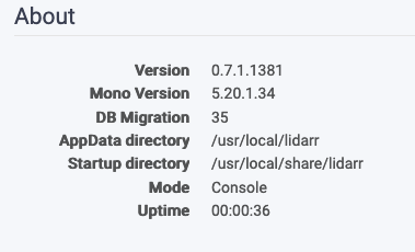

ChaosBlades submitted a new resource:
[How-To] Manually upgrade mono from 5.10 to 5.20 in a FreeNAS Jail - How to upgrade mono before support is dropped for 5.10 in Sonarr, Radarr, Lidarr, and Jackett
With the recent version of Lidarr (0.7.0.1347) older versions of mono were broken and I found out that "soonish" it would drop support from the current latest FreeBSD version of mono 5.10 (26 Feb 2018 ) for 5.18 (21 Dec 2018 ). Same with Sonarr and probably Radarr and Jackett as well. So if we don't get a newer version (6.0.0 is the latest) of mono "soonish" on FreeBSD then we could find ourselves in a situation where auto-updates to these apps will break them. That is if the...
Read more about this resource...

Just gave this a shot and it worked like a charm. Fixed the issues I was having since updating Lidarr. Thank you!

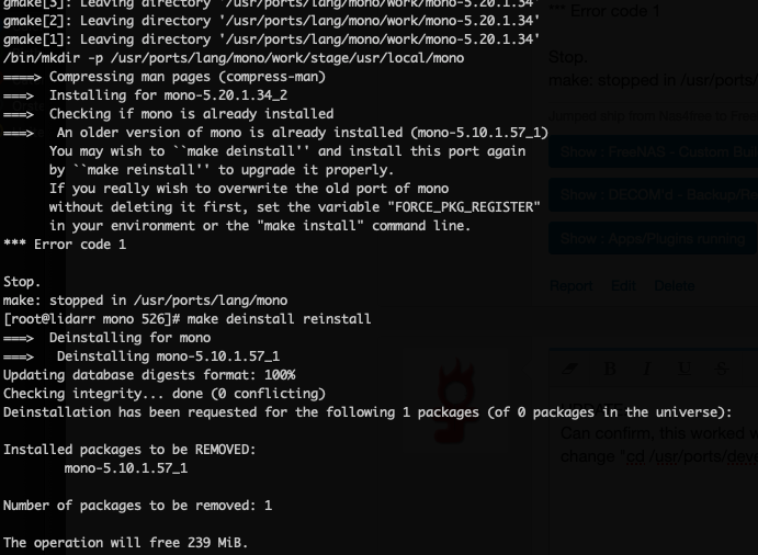

UPDATE:
Can confirm, this worked when I did the following in the instruction set:
change "cd /usr/ports/devel/llvm80 " to "cd /usr/ports/devel/llvm90"
From Lidarr, I am back online and running mono v5.20.xxx

How does one do make package?
On another note, instructions worked fine and worked for me. 1 note, I had to use llvm80 not llvm90 for it to work (using pkg install).
Apr 8, 2012
136
you go to the directory for mono under your ports after you have compiled and literally run "make package" this creates a tarball which you can then copy to other jails/installations for install then just run "pkg add -f /tmp/mono.whatever.txz"

===>  Extracting for p5-XML-Parser-2.44
=> SHA256 Checksum OK for XML-Parser-2.44.tar.gz.
===>  Patching for p5-XML-Parser-2.44
===>  Applying FreeBSD patches for p5-XML-Parser-2.44
===>   p5-XML-Parser-2.44 depends on package: perl5>=5.30.r1<5.31 - found
===>   p5-XML-Parser-2.44 depends on shared library: libexpat.so - found (/usr/local/lib/libexpat.so)
===>  Configuring for p5-XML-Parser-2.44
/bin/sh: cannot create :/root/.cshrcbin:/usr/local/go/bin:/root/.gopkg/bin/usr/local/go/bin/root/.gopkg/bin:/usr/local/go/bin:/root/.gopkg/bin:/usr/local/go/bin:/root/.gopkg/bin: No such file or directory
*** Error code 2
Stop.
make[2]: stopped in /usr/ports/textproc/p5-XML-Parser
*** Error code 1
Stop.
make[1]: stopped in /usr/ports/lang/mono
*** Error code 1
Stop.
