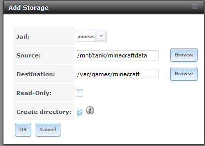

I wanted to keep the /var/games/minecraft in another dataset for easy backups (without having to worry about backing up the whole Jail). So after I create the Jail, I then Add Storage:
/mnt/tank/Sysadmin/MineOSData -> /var/games/minecraft with read-only unticked, and create directory ticked. Then within the jail I change the group of the folder from wheel to games chgrp games /var/games/minecraft, and then followed the rest of the guide to install MineOS.

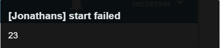

Everything install and works and I can create a new server, BUT (and there had to be a but!) when I press Start the right-hand corner states:
The log file states:
{"level":"info","message":"[Jonathans] eula.txt detected: ACCEPTED (eula=true)","timestamp":"2017-09-08T10:47:21.443Z"}
{"level":"info","message":"[Jonathans] 192.168.0.12 issued command : \"start\"","timestamp":"2017-09-08T10:48:06.860Z"}
{"level":"info","message":"[Jonathans] received request \"start\"","timestamp":"2017-09-08T10:48:06.860Z"}
{"command":"start","uuid":"3298f0c0-9483-11e7-bb98-036289c2da07","time_initiated":1504867686860,"success":false,"err":23,"time_resol
ved":1504867687073,"level":"error","message":"[Jonathans] command \"start\" errored out:","timestamp":"2017-09-08T10:48:07.073Z"}
Any idea what I'm doing wrong? It must be a permissions issue, but I just can't see it.
Thanks.

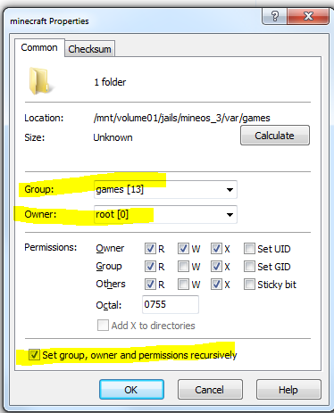

I'm actually running the same setup; I keep my Minecraft data on my main pool and use the Add storage to mount that dataset into /var/games/minecraft
My permissions are as follows:
root@mineos_3:/var/games/minecraft # ls -al
total 44
drwxr-xr-x  7  root  games  7 Aug 24  2016 .
drwxrwxr-x  3  root  games  3 May 20 15:54 ..
drwxrwxr-x  25 root  games  25 Jul 26 14:21 archive
drwxrwxr-x  25 root  games  25 Jul 26 14:21 backup
drwxrwxrwx  2  root  games  2 Aug 24  2016 import
drwxrwxr-x  11 root  games  11 Jun 23 08:05 profiles
drwxrwxr-x  17 mcserver  games  17 Jul 26 14:21 servers
Some other notes:
  • I had issues when trying to share my mc dataset via SMB, as the windows ACL seemed to break things. I now use WinSCP to drop in mods etc...
  • I created a user mcserver in the FreeNAS gui with the same UID/GID as in the jail, mostly for consistency, security and to make it look clean.

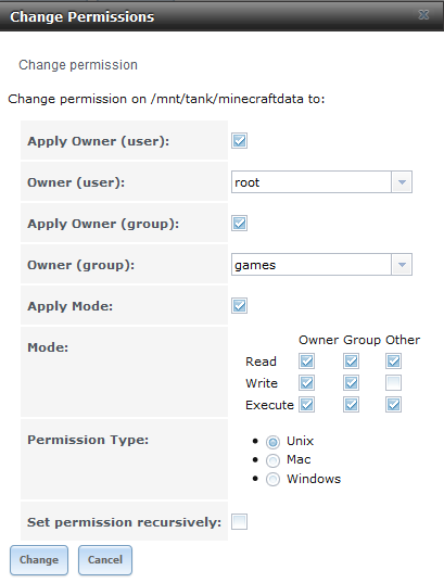

To move your files to a dataset outside of your jails, try this:
  • Stop mineos jail
  • From the FreeNAS UI, create a new dataset called e.g. minecraftdata, owned by root/games and the following permissions:
  • move the data from your jail folder to the new dataset (my jail is called mineos):
    mv /mnt/tank/jails/mineos/var/games/minecraft/* /mnt/tank/minecraftdata
  • Add the new dataset to the "storage" of your jail
  • Start your jail again

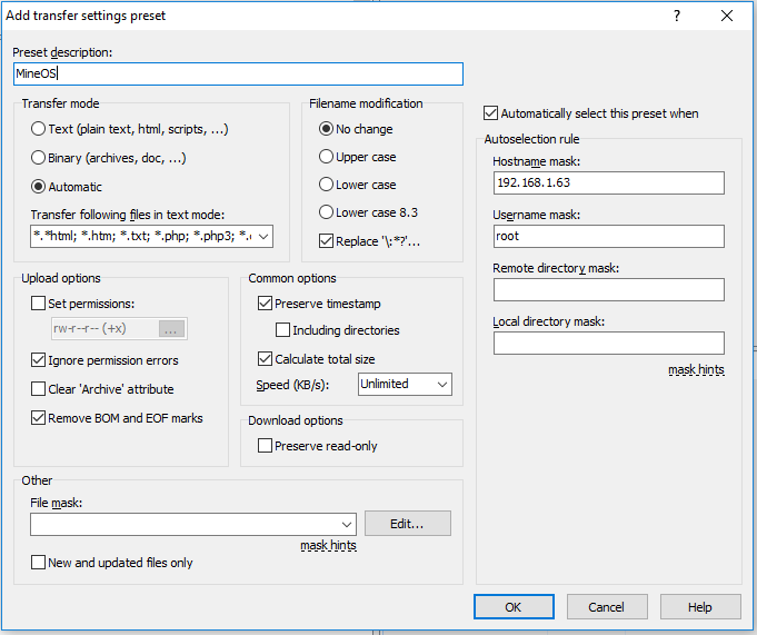

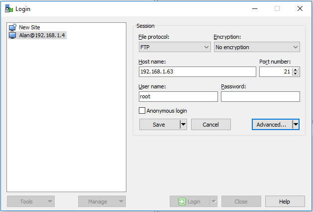

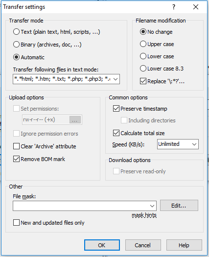

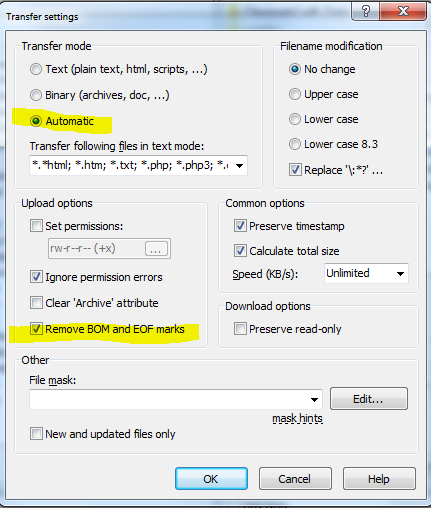

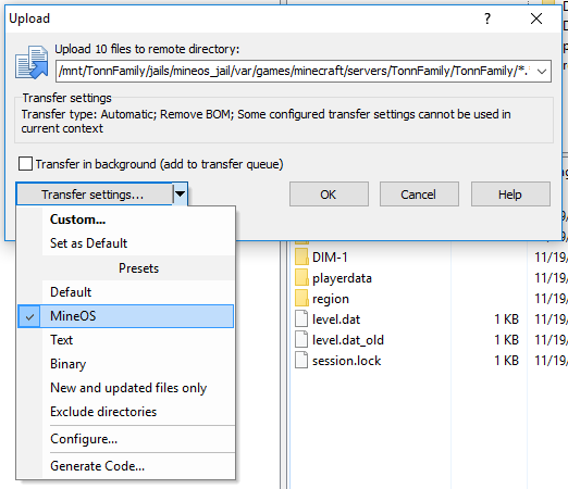

Yeah, I have to admit, I am a pretty useless newbie when it comes to this stuff. Unfortunately I did not have another dataset available as I had to start everything from scratch again due to hardware and user error. I am planning on a few things to stop this from happening again but at the moment I am stuck with a copy of the files from the previous freenas install on a drive on my windows computer that I had manually copied.
So at the moment I have to use the WinSCP method to get the files back to the way they are supposed to be. I am going to need a walk through on that as well. I downloaded and installed that tool on my windows machine, is that where I should be using it? I already tried to connect to the mineos jail through the IP address, 192.168.1.4 but it told me that it didn't like SFTP and so I changed to FTP and that told me the connection was refused.
If I were to put the files in a folder on a separate dataset and copy them into the mineOS dataset would the permissions change to the correct ones and drop all the crap that windows puts on?

If you run WinSCP, logon using sftp with root to the IP of your FreeNAS box, not the one of your jail; the same as if you would logon to the FreeNAS UI. If it won't let you, make sure you have the SSH service running and the "Login as Root with password" option checked. Follow the instructions from the manual if needed. You can uncheck the box when you're done when you have any security concerns.
In WinSCP, use the Transfer Settings dropdown to select "Configure" and then click "edit..." The settings should look something like this:
Drag & drop the proper files from your windows folder into /mnt/tank/jails/mineos_jail/var/games/minecraft folder. When done, right-click on the minecraft folder (the one on the FreeNAS side) and change the owner & group recursively to root:games like this:
Once this is done, log on to your jail and change the ownership of the server files to mcserver:games
cd /var/games/minecraft/servers/
chown -R mcserver:games *

WinSCP is a great tool once you get it working with the freeNAS. I can look all around at the files and folders for everything.
So I have been hacking away at this most of my day and I get the feeling that something still isn't right. I don't have any screenshots of early attempts but I am uncertain why but I am not getting the EOF checkmark, just BOF. When I use WinSCP to transfer should the jail be stopped?
When I first setup the connection to the FreeNAS with WinSCP I get these dialogs:
When I click the advanced button I get a transfer rule setup choice and get this:
I set the settings the same and gave it a title. I then hit save on the first dialog and then login. I get a dialog that asks for my password, then it shows the folders that I want to navigate. I get them setup and i try a Drag and Drop and get this:
If I click ok the transfer starts and the files get over, but the first time I tried it the whole MineOS jail became unresponsive. I nuked it and tried again. So I just did the transfer again. This time I just tried the files and folders inside of the TonnFamily folder. I was hoping to not disturb any of the other folders under the MineCraft folder other than the stuff inside the servers folder. And again the MineOS web interface is now screwed.
Would there be any incompatibilities between the plugin servers and the standard jail setup? These files are after all from a plugin MineOS install rather than a standard jail setup.
Here is a screen of the transfer settings when I try to do it after logging on to the FreeNAS FTP:
Notice how the BOM and EOF are now just BOM and the ignore is greyed out as well.
