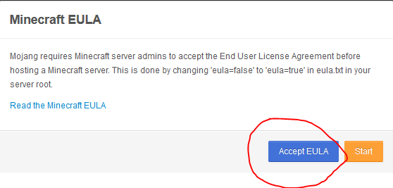

I was able to setup minecraft but the problem is Server wont start. There's a tab on main MineOS webpage where it asked me to Accept EULA and when I tried to do that an error message (see below) pops up as it says below:
"Mojang requires Minecraft server admins to accept the End User License Agreement before hosting a Minecraft server. This is done by changing 'eula=false' to 'eula=true' in eula.txt in your server root."
Please could someone guide me how to find this eula.txt file?
I appreciate it. Thanks!

This thread discusses how to install a Minecraft server in a jail. There are several other active threads that are more specific to MineOS.
Did you install MineOS? If so, all you really need to do is to click "Start Server" and then "Accept EULA" on that popup you are referring to, and it will update the file for you.

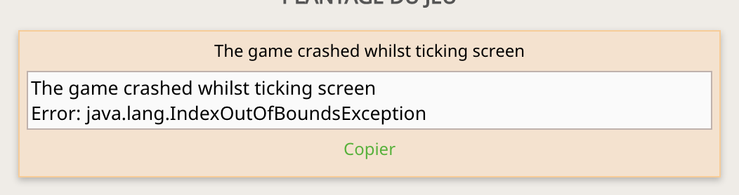

Hi everyone,
I have kind of a double problem :
Following the guide I get to something that looks fine but when I launched it I saw I dumbly copied the 1.7 serv in archive files where today's version is 1.13 .. dumb but it reavels something :
I DLed the new serv file, put it in the jail, restart it aaaand then it appears as "Can't connect to server" in Minecraft server's list.
I double check and indeed only 1.7 is detected.
To troubleshoot I thought about put back the 1.7 serv that at least seemed to works and try to launch, I launch a profile as v1.7 but then when I try to connect to server this happens
Btw, using v1.7 file i can launch screen -x via ssh, with v1.13 I get "There is no screen to be attached."
Soooo either ways I'm stuck, any suggestions ?
Thx guys.

FreeNAS has evolved quite a bit since this thread was posted. Can you start at the beginning....
Some very basic information would be useful:
  • What is the exact version of FreeNAS that are you running?
  • If you're on 11.2+ , have you tried to install the MineOS plugin?
Note: I did read you minecraft-related post in the other thread also,but it's not clear what your end goal is.

Never mind, indeed MineOS works well.
Yes I just find that out, nevermind, indeed MineOS works well.
I wanted to setup myself the jail to learn and have full control on it but MineOS seems pretty powerfull and sufficient enough.
Thx for your concern anyway Jurgen.
