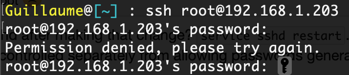

Hi everyone,
So I searched around the internet and find various posts about "can't SSH in jails" but none seems to fix my problem :
I'm setting up a minecraft server jail following this guide : https://www.ixsystems.com/community/threads/how-to-install-minecraft-server-in-a-jail.18246/
On step "Download the jar file and place it in your jail under /srv/minecraft" I want to move the files from my laptop to the jail using scp but cant SSH access in as root, I'm stuck there.
• The guide tels to create a minecraft user : done.
• I also added this new user in wheel group as told in FreeNAS's doc "Users that require root access must also be a member of the wheel group. Enter wheel when prompted to invite user into other groups? []:"
• I allowed SSH into jail with those lines in /etc/rc.conf
> sshd_enable="YES"
also
> PermitRootLogin yes
The core issue is that trying to scp from Terminal on my laptop using minecraft@jail'sIP... into /srv/minecraft : Permission denied
• ssh as root@jail'sIP

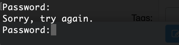

But then sudo su just dont let me in.
(tried many times)
I passwd root in the jail using the FreeNAS shell in the web ui and restarted the jail after any of my changes, so i'm pretty sure about the password and stuff.
My best guest then is somewhat of a permission issue ..?
Thx for your help guys

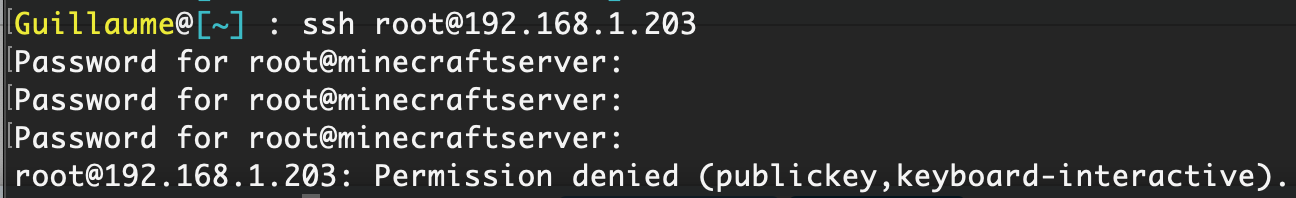

15,504
Still can't ssh as root :(
Did you restart sshd after making that change? service sshd restart. You might also want to make sure that it allows password logins for root; I'm not sure if that is controlled separately from allowing passwords generally.
gchamort
Feb 28, 2019
6
Yep, restarted the service, then the jail, then even the whole NAS -__-
In /etc/ssh/sshd_config
> PasswordAuthentication yes
If that's what you mean
aswell as
> PermitRootLogin yes
still
gchamort
Feb 28, 2019
6
Wellllll .. it works now :eek:
I deleted and reset the jail and carefully did again all of the previous manipulations
> sysrc sshd_enable="YES"
created the minecraft user (added to wheel group)
in origin /etc/ssh/sshd_config added
restarted jail
copy the files from laptop to NAS/Jail via minecraft user then logged from the web GUI as root to move the files inside the jail from
-> one of them overwrite the sshd_config file
in modified /etc/ssh/sshd_config added
> PermitRootLogin yes
restarted everything
I now can log as minecraft, log as root, but still cant sudo su from minecraft, but obviously I don't mind
I'm glad but frustrated not to know what was going wrong :/
Thanks a lot for your time Dan
