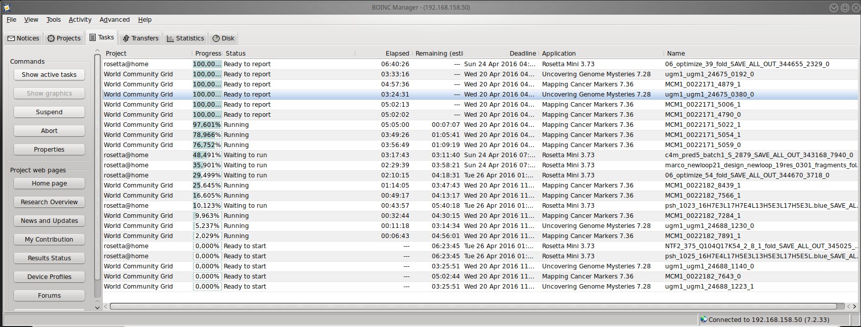

3. Connect with boinc-manager
This file contains the password to connect with the boinc-manager:
cat /var/db/boinc/gui_rpc_auth.cfg
In Boinc-Manager you go to 'Advanced -> Select Computer' and enter your jails hostname or ip-address together with the password. If you run boinc at home I suggest that you change this very long key to something you can remember. (daemon restart required!)
I had the case that my instance was calculating only one task even though I have 8 HT-cores. So I aborted it via the manager and waited the 1:30m. After that 8 tasks were picked up and calculation started.

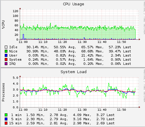

Does the "suspend boinc when CPU usage is above XX%" feature work? Even if the usage comes from another jail?
ChrisFor
Aug 30, 2013
18
Yes. I have it set to 60% and the CPU usage looks like down there in the pic. I don't 'feel' any speed-penalty because of boinc running in the background the whole time. We use our fileserver moderatly (Xeon E3-1220, 32GB-RAM, 6*2TB WDRed, RaidZ2). Once in a blue moon I need to copy a big 150GB vm to and fro and get constant 100MB/s both ways. So our GB Ethernet is nicely saturated.
Anhow, a jail can take as many cpu time as it wants. It would be much better to have it set to 100% inside the boinc jail and have the jail's CPU usage limited from outside the jail.
I assume (and hope) that this is going to be possible with bhyve under FreeNAS 10.
Then of course, setting up a boinc-vm with debian or ubuntu is going to be a piece of cake. Exciting times ahead!
