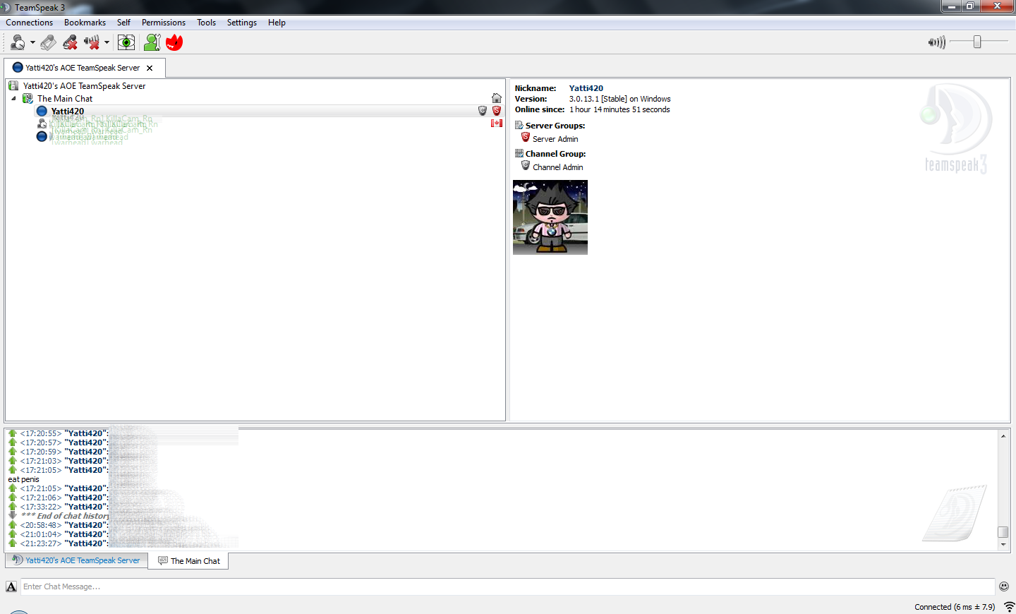

Mumble is open source.. Definitely worth looking into... TS was the only name I knew of.. Was quick and painless at least.. Not sure how to pull 1 specific port versus them all.. TS3 is atleast painless and relatively clean and simple..
