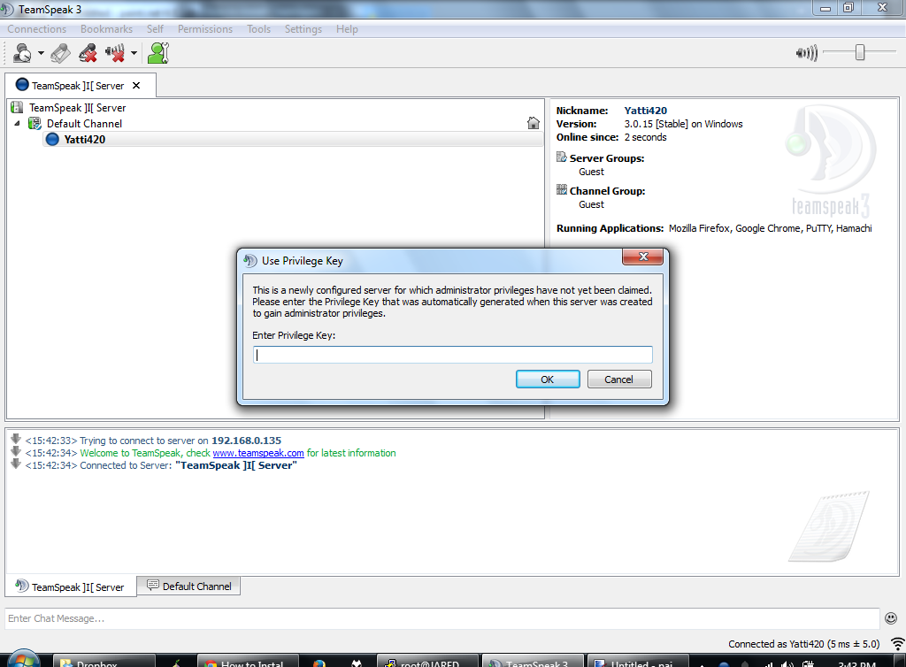

You appear to be having network problems.. This is what it looks like when connection completes.. Token removed for security purposes.. Note you will only find this key in one of the first logs..
2014-03-31 07:01:58.699333|INFO |VirtualServer | 1| listening on 0.0.0.0:9987
2014-03-31 07:01:58.699840|INFO |VirtualServer | 1| client 'server'(id:0) added privilege key for servergroup 'Server Adm
2014-03-31 07:01:58.699865|WARNING |VirtualServer | 1| --------------------------------------------------------
2014-03-31 07:01:58.699884|WARNING |VirtualServer | 1| ServerAdmin privilege key created, please use the line below
2014-03-31 07:01:58.699903|WARNING |VirtualServer | 1| token=*************************************
2014-03-31 07:01:58.699924|WARNING |VirtualServer | 1| --------------------------------------------------------
You use this token in order to gain admin privileges.. See screenshot.. I believe the token only appears once.. Check your jail network connectivity..
Edit: Appears when you actually make a successful connection!
