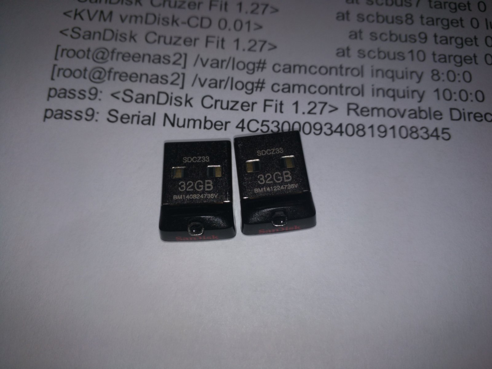

And here are the serial numbers printed on the USB sticks:
BM140824736V
BM141224736V
Anyone see a pattern?
Robert Smith
May 4, 2014
270
Perhaps, larger number on the inside corresponds to the larger number on the outside, and vice versa…
But yea, wow. I think we need a recommendation to mark USB drives before usage, or to use different brands/models together for easy identification which is which.
If you can import the USBs one at a time on another FreeNAS, you should be able to figure out which one shows as healthy with the second drive missing. I am just not completely sure that the second FreeeNAS won’t try writing anything to the stick.
Yes, but we are (as humans) pretty good at finding pattern who doesn't mean anything, so...
For instance, here are the serial numbers from camcontrol:
4C530102841224103441
4C530009340819108345
BM140824736V
BM141224736V
