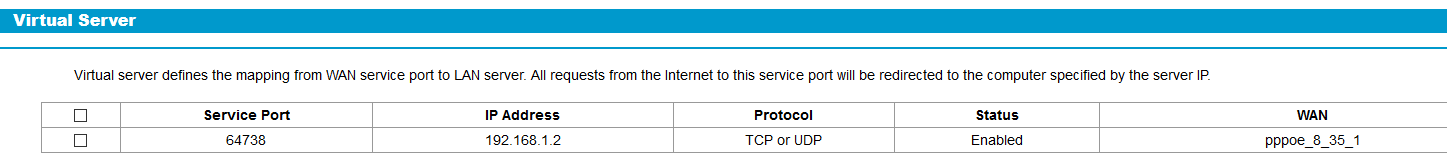

Yeah sorry I should have mentioned this has been done:
The IP address should be correct for the murmur jail too:
Is it possible that the NAS or the murmur jail itself is blocking the connections coming in? Not sure how to tell were the breakdown is.
I'll do some more googling - just thought I would check in here to see if there are any immediate places to start looking.

OMG I'm an idiot... Thought I was testing external IP connection from outside my local network but the VPN not on. When VPN activated, could connect just fine.

Also, you are confusing me a bit. I think you might (?) be using jargon incorrectly. VPN? I don't see a VPN. Your screen shot looks like it's one of the cheaper TP-link routers, and they use the wording "virtual server" but that's really just unfortunate phrasing for "port forwarding" and has nothing to with virtual anythings. By "turn on the VPN", what do you mean exactly? Or, in fact, are you actually using a VPN? If so, why, and which one? Mumble is always fully-encrypted to the bejesus belt with AES on all packets, so a VPN will not add much to the situation except making it more difficult for other to connect to your Mumble server.

The VPN is not on my FreeNAS but on my normal PC. I wouldn't use Mumble with the VPN active normally though. I turned it on so that connections from my PC would come from outside my network so that I could simulate connecting to the Murmur server from an outside device. Before it was turned on I was trying to connect to the external IP address (i.e. my ADSL router's external IP) from within my local network and that was generating the connection refused.

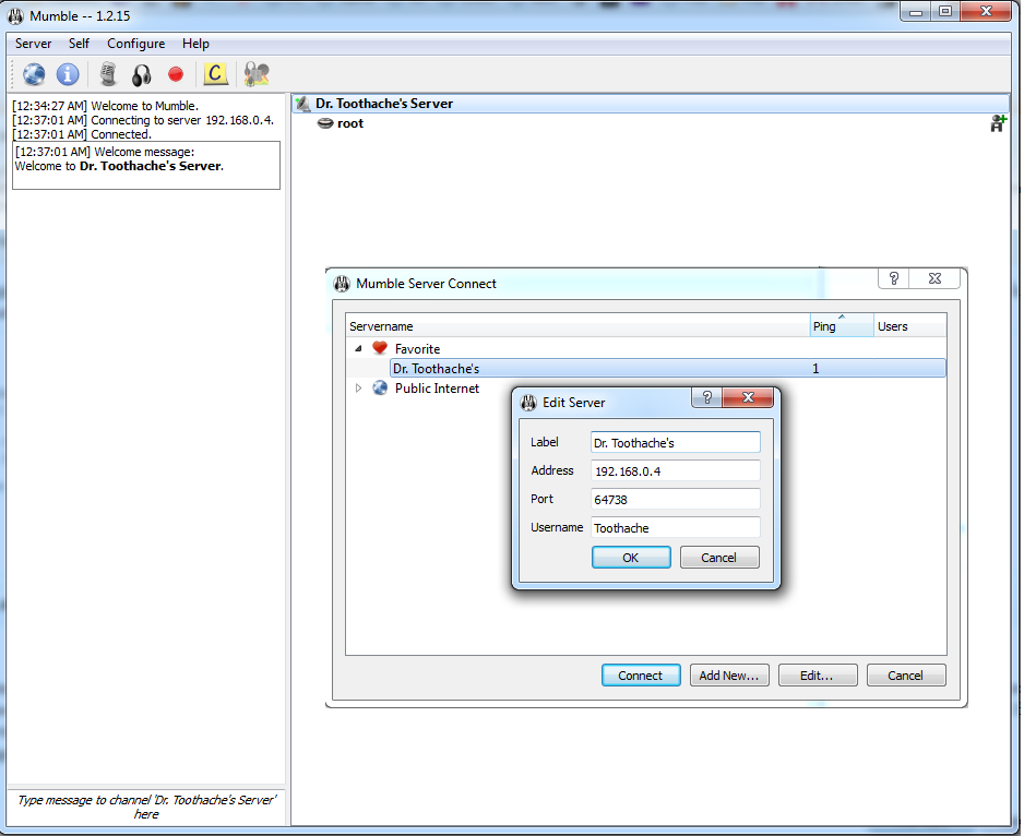

Hello Dr. KK,
First of all, awesome guide making skill, I followed the YouTube video every step of the way and it was fairly easy to understand and complete all tasks. The only problem I have now is that when I log into the mumble server, it logs me as the "root" user, not as the name I provide in the "Username" field in the Edit Server Settings window. How can I fix this? Is there a way?
I can start the service, log into mumble, stop the service, all of that. It's just that one piece that is missing.
Please help me. Again, thanks for the guide and the thorough explanation.

Hello Dr. KK,
The only logical explanation I have is this: One you "register" a certificate with the server, that certificate is permanently associated to the username it had upon registration, regardless of what you put in the field. If your name was "root" and the certificate was "registered", that could be the problem. There is no other reason I can think of that it would not accept a name like "Toothache".

That is EXACTLY what happend. Now that i remember it, how do I fix it? Thanks for the quick reply.
Well, you could log in as a privileged user (SuperUser, or if you made your "root" guy a privileged user), then you have a Server->Registered Users menu, you can highlight the certificate for "root", and blow it away. And then try again with the correct username and register it again.
Or, if you just want to start totally fresh, blow away the database. It's probably in /var/db/murmur/murmur.sqlite

You my friend, are a god among man..!! Thank you so much. Easy as that. I did the Server->Registered Users->Remove "root"->and GG.
Thanks again for the guide. Take care.
