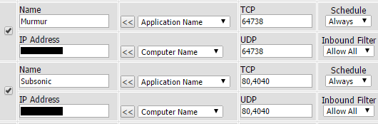

Here's how I have the ports setup. I assumed it's correct since subsonic seems to work.
Well, you blanked out the only thing that could be a problem.
have you put in the IP address ***OF THE JAIL***? Putting in the IP address of the FreeNAS appliance would be stupid.
