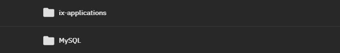

How to backup and restore ^ix-applications^ to/from an other dataset local or remote!?
Louis2
Sep 7, 2019
177
To start with, I am not 100% sure what is exactly stored in ^ix-applications^.
I think all data related to:
- Kubernetes
- Docker
- Apps
- more !!??
- what not !!??
What ever it is an important dataset to backup. And the backup should be such that you can recover Docker, Apps and Kubernetes, in case of a severe event
I think there backups should be there on three levels:
1) regular ^ix-applications^ data set snapshots
2) backups on an other local dataset or even better on a remote dataset
3) backups from a particular app / docker instance
At the moment I am busy with the upper two levels.
If you look at the dataset GUI, than you see one ^ix-applications-folder^, however that is false representation of the real situation .... there is a lot invisible below that ^folder^. You really have to tell what ever backup method used, that it should work ^recursive^ !!!
Related to regular snapshots (1):
- I assume that they include everything within the dataset
- And I hope that nothing goes wrong in you recover that dataset
For the second level (2), I choose a replication task, which does recursively copy's the content of the dataset to a dataset on an other disk. For that purpose snapshots are used, and I think that it is vital that you use backups with a dedicated naming structure there e.g. 'LocalBackUps-<date-time-str>. If not the backups will be created against e.g. old snapshots, what is IMHO not the intention.
I hope, think, but did not test, that I could recover this way, recreate a working dataset on a new drive, even if the original data set get lost for whatever reason!
Does the described method, full fill my requirements:
- restoring to an earlier moment in time for kubernetes, apps and docker
- even when the original dataset is lost!?

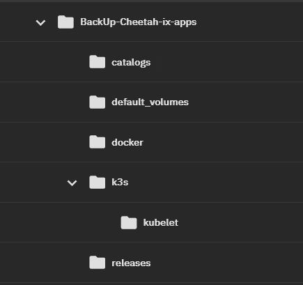

Edit: added a screenshot from the ix-applications data set .... and from the replicated version of that dataset .,... which do look quite different.

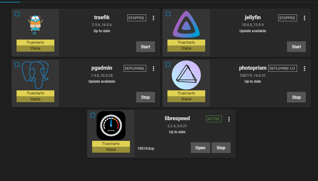

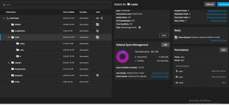

Apps installed wouldn't spin up. If i go to the "edit" screen, it just have a blank spot to put in the name of the app, but it will not allow you to type anything. If you go to the log, it claims "No Pools Found - At Least one pool must be available to use apps"
I deleted Photoprism cause i already lost those videos anyways, and i can't install a new one. I even try to do a fresh new install by deleted photoprism completely and the dataset. Rebuild the dataset and installed photoprism. Still will not work.
I tried to spin up nextcloud, and i got the same thing. At this point, i went to pgadmin to restore the data and pgadmin claims my nextcloud app isn't on the array. (like it wasn't installed). At the time, the app was there, just not responding and can't edit and can't get in the log.So i deleted the app and try to reinstall thinking the pgadmin still has the backup and I can see the data taking up room in the nextcloud-data dataset. Well, it will not install, i got the error below (see lost script error).
the samething happen to Jellyfin. However, i didn't delete that app year.
soooooooooooo after asking on the TrueNAS Scale discord ticket help, i didn't get any guidance for two days and decided, ill just roll back on heavyscipt one more time.
Same issue. No change.

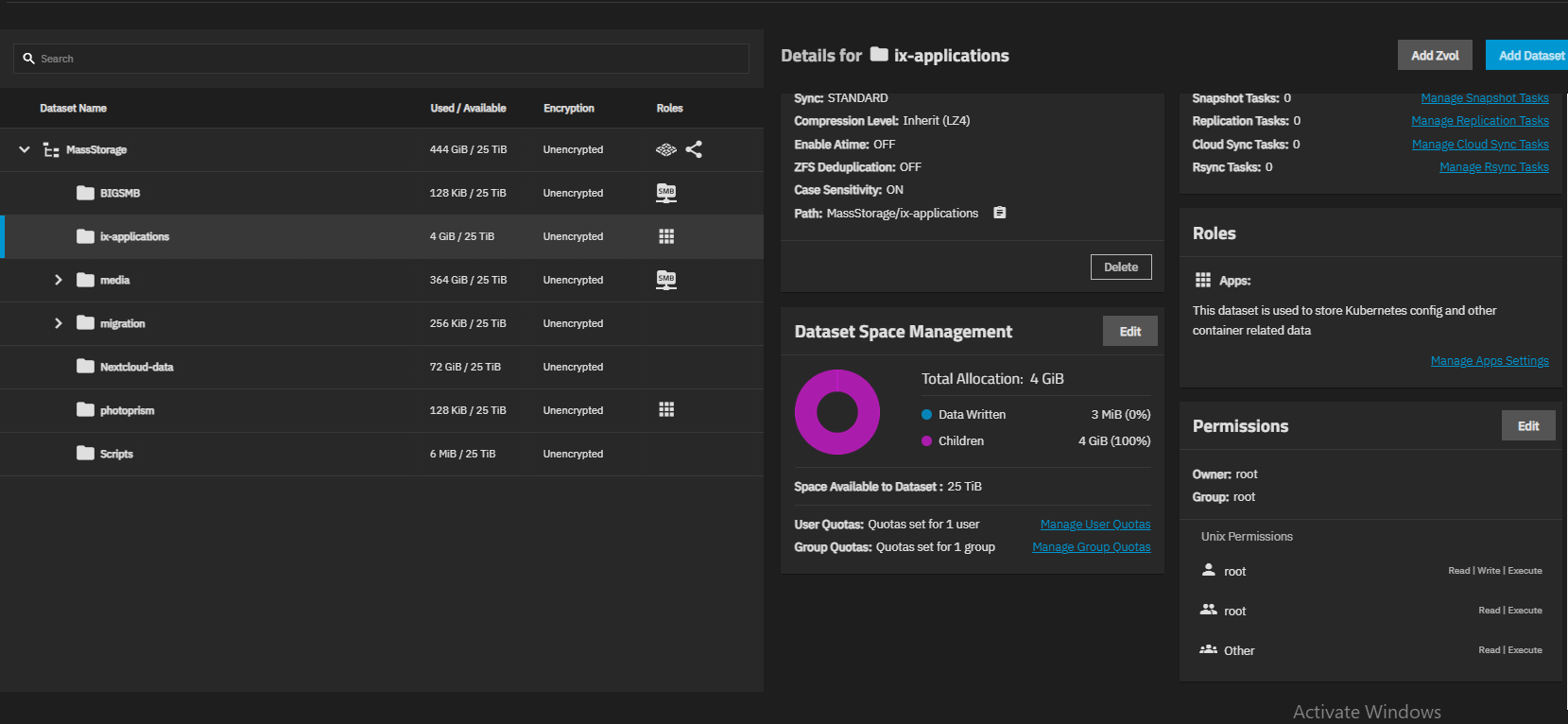

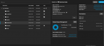

conclusion: In my datasets (see attach screenshot). You can clearly see there nextcloud and Jellyfin still have data there, however I can't get my old Applications to work on the system. Just for laughs, i installed librespeed and it works just find with no issues.
So, something in the heavyscripts disconnected the jellyfin, nextcloud and photoprism's ability to talk to it's pool, even after deleted the app and (in photoprism's case) the dataset.
