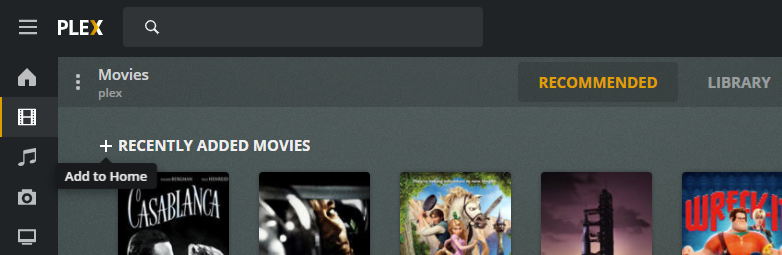

For the home screen, you may need to reset it to defaults. Otherwise, you can populate it yourself from the Recommended tabs of each pinned library, and selecting the + at the left of each category group.
Steve Davis
Sep 9, 2015
29
I can deal with no content on home screen, just as long as I have access to my libraries without all the streaming "ads" like news/weather/ movie clips/etc. I guess I will have to deal with for now, considering I cant find anything else to replace plex with.

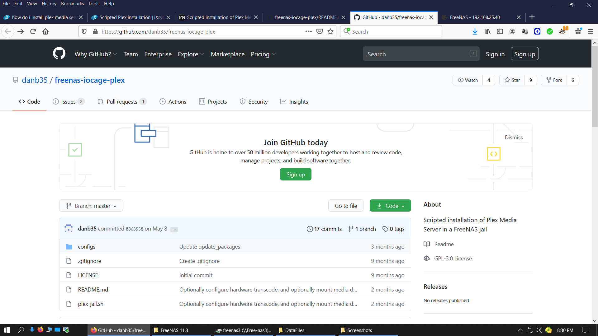

You're not restricted to the plugin. You could try @danb35's Plex install script to install inside a generic iocage jail.
I am attempting to install Plex using Danb35 install script;
I follow the installation instructions exactly as directed.
1. says to create configuration file called "plex-config" (done).
2. change to convenient directory on freenas server, ("/mnt/FreeNAS3/DataFiles") - done.
and download this script using:
git clone https://github.com/danb35/freenas-iocage-plex

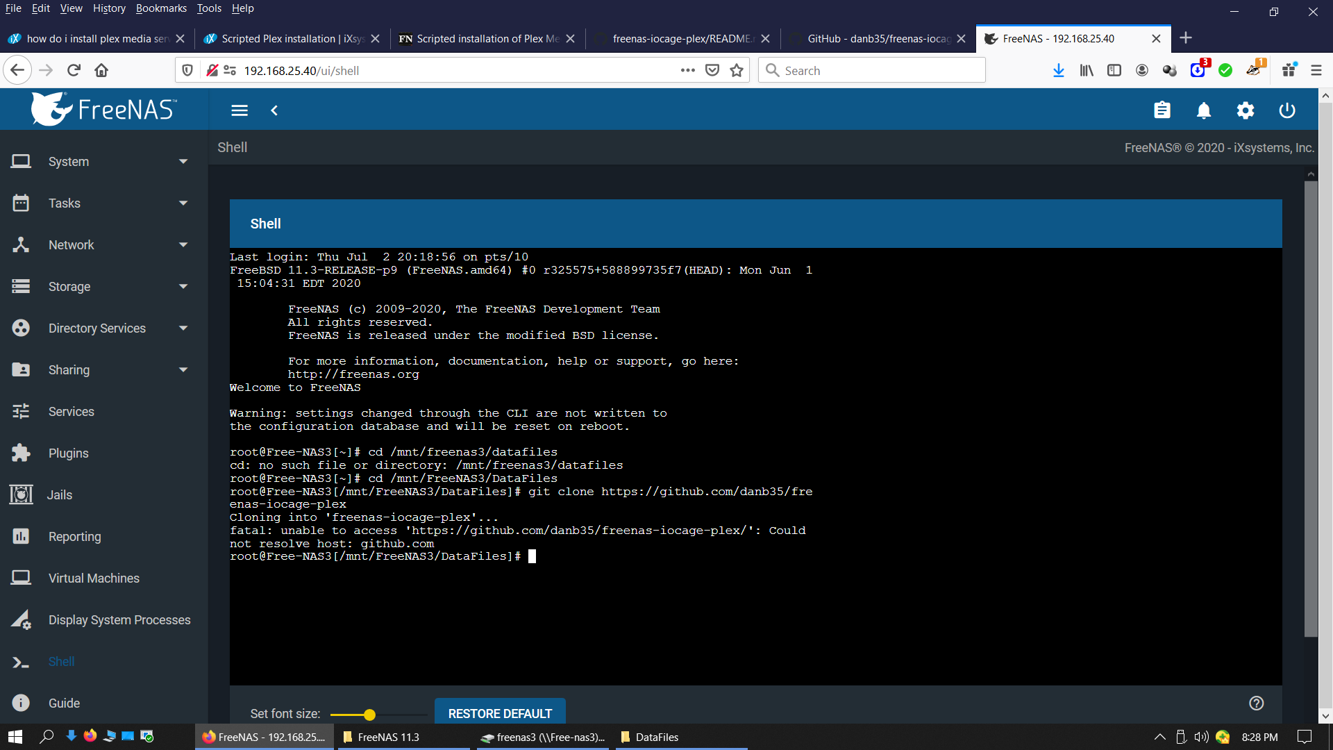

everytime I try to download the file specified by Danb35 using the git clone command I get error:
Cloning into 'freenas-iocage-plex' ...
fatal: unable to access 'https://github.com/danb35/freenas-iocage-plex/' : Could not resolve host: github.com
I can directly go to github.com website in my browser ( https://github.com/danb35/freenas-iocage-plex )
so I know there is nothing wrong with my internet access.
What am I missing?

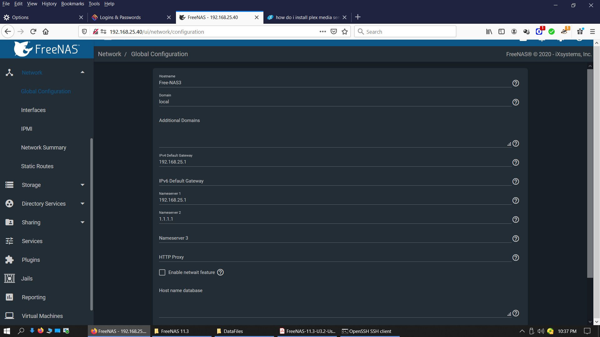

What am I missing?
Network settings on your FreeNAS box. Make sure you have a DNS server (use 1.1.1.1 if you don't have another one in particular to use) and default gateway set. And really, don't use the shell from the web GUI--ssh in instead.

the network info worked, I logged in via ssh and was able to download files.
root user password is set and nameservers are set
NameServer 1: 192.168.25.1
NameServer 2: 1.1.1.1

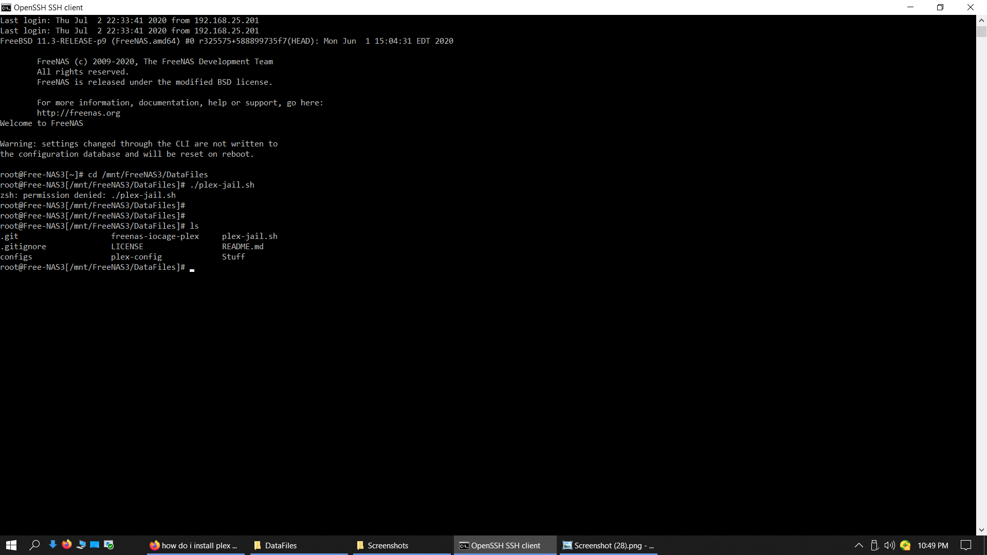

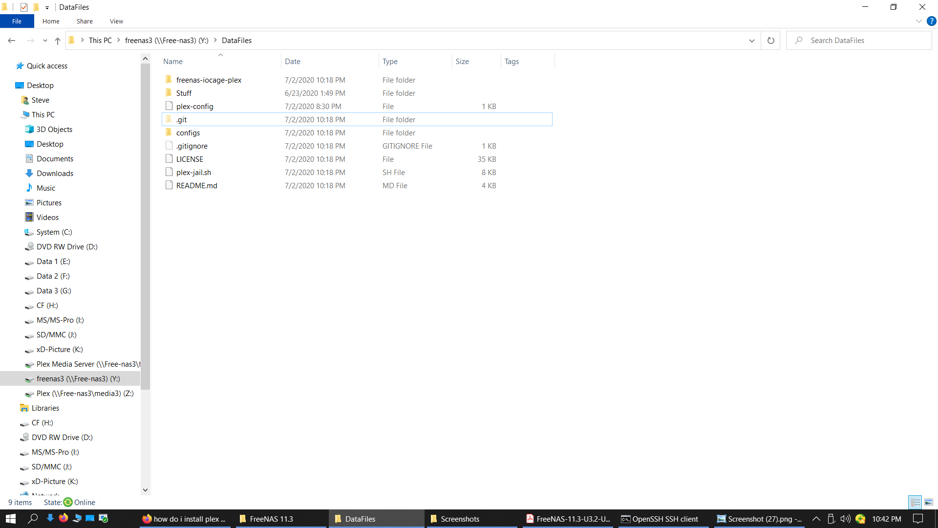

when I run the "plex-jail.sh" program I get
zsh: permission denied: ./plex-jail.sh
ls command shows all files are accounted for in current directory
"plex-jail.sh"
"plex-config"

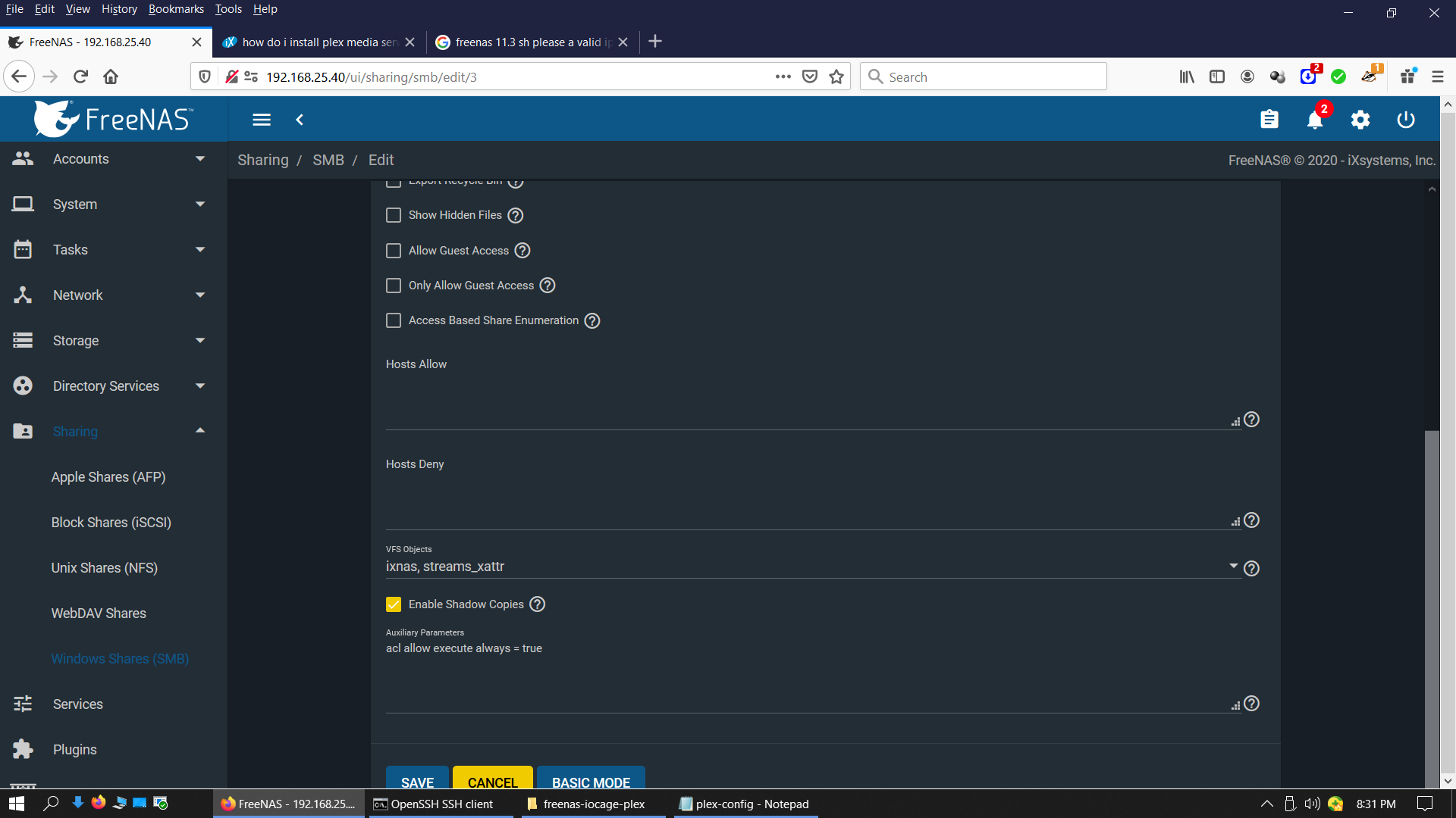

Samuel Tai
Apr 24, 2020
5,399
Try sh plex-jail.sh. Since you're sharing this folder out via SMB, you may also need to set acl allow execute always = true in the share's Auxiliary parameters.

Steve Davis
Sep 9, 2015
29
I set the share Auxiliary parameters to "acl execute always to = true"
command and run "sh plex-jail.sh"

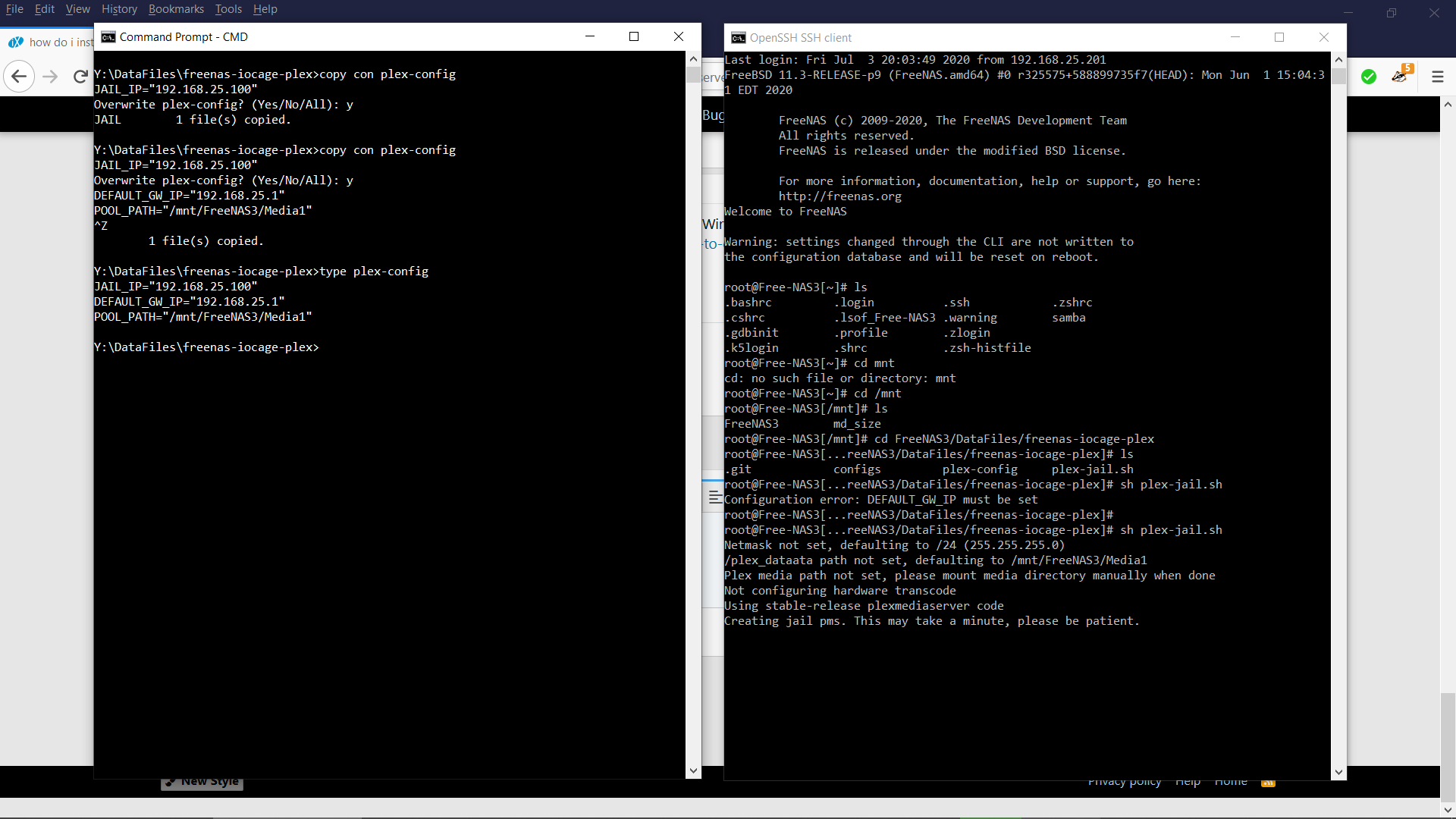

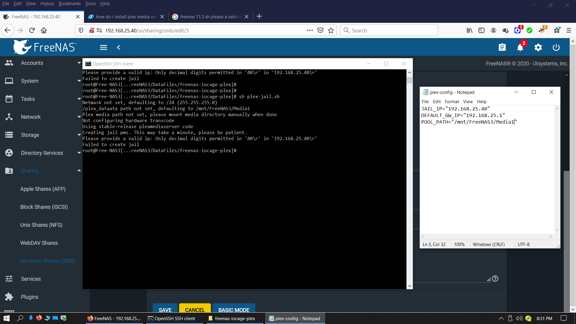

now every time i run "sh plex-jail.sh" command i get
please provide a valid ip: Only decimial digits permitted in '40\r' in '192.168.25.40\r
Failed to create jail
my "plex-config" file is
JAIL_IP="192.168.25.40"
DEFAULT_GW="192.168.25.1"
POOL_PATH="/mnt/FreeNAS3/Media1"

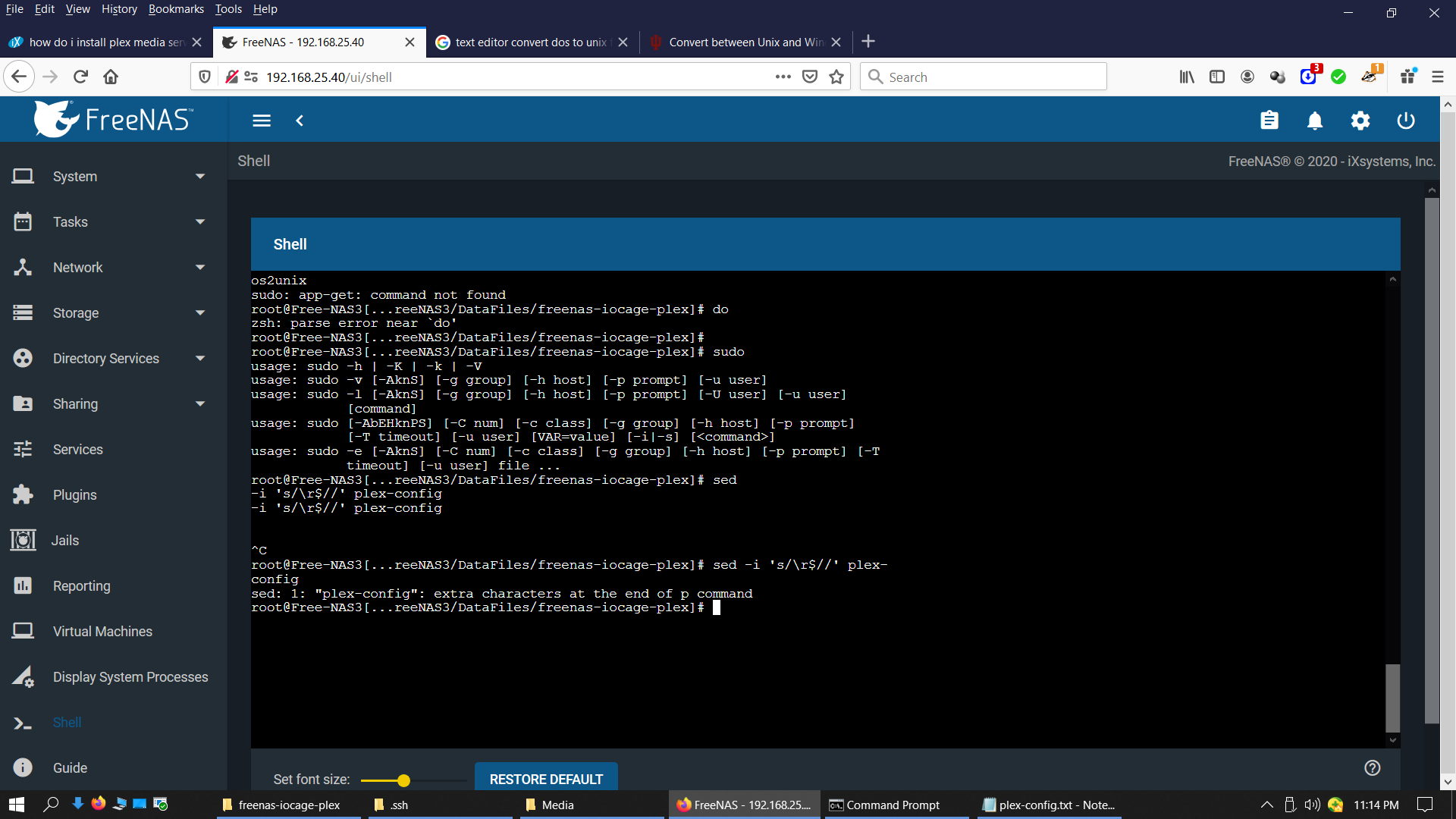

Samuel Tai
Apr 24, 2020
5,399
Steve Davis
Sep 9, 2015
29

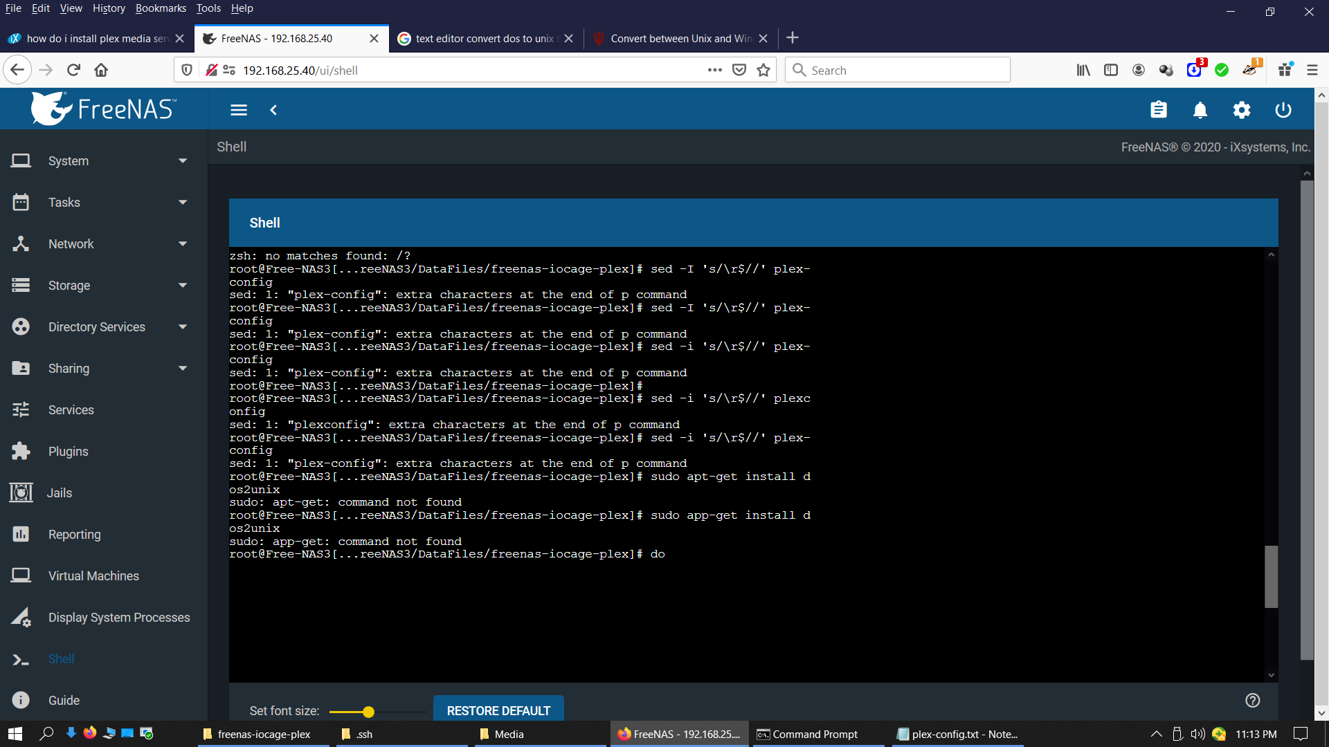

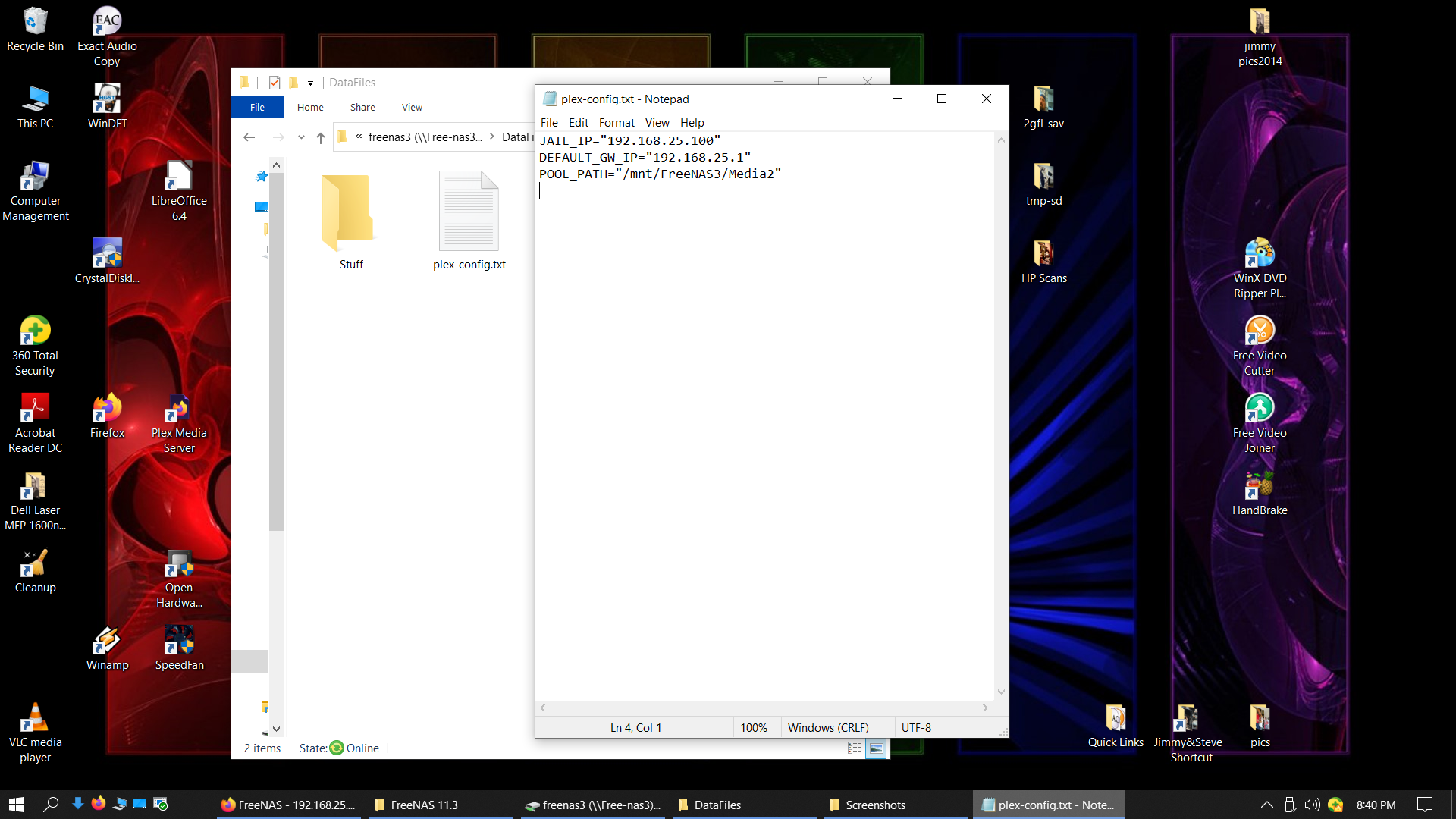

Ah, you created the plex-config in Notepad, and thus it has the Windows line endings of \r\n. Unix (and FreeNAS in particular) expects line endings of just \n. Try this from https://askubuntu.com/questions/803162/how-to-change-windows-line-ending-to-unix-version to convert the line ending to Unix format:
sed -I 's/\r$//' plex-config.
I created a new config file and replaced the old one, "sh" command is running but it seems to be taking forever
its stuck at " creating jail pms. This may take a minute, Please be patient."
how long is this supposed to take?

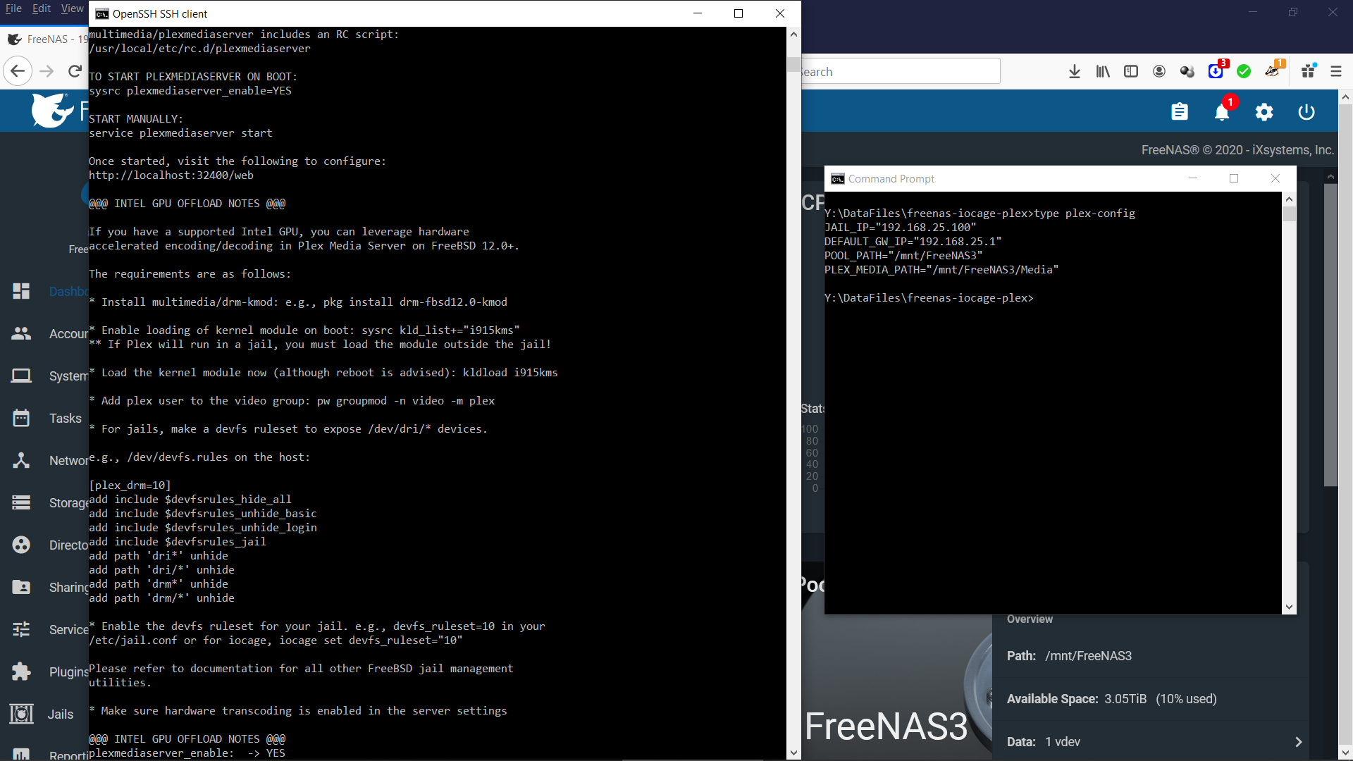

Did you pass the script the wrong value of POOL_PATH? That looks like your server media path, which in the script is PLEX_MEDIA_PATH. According to the script notes, the POOL_PATH is the root of the pool which iocage uses. In your case, I think that's /mnt/FreeNAS3.

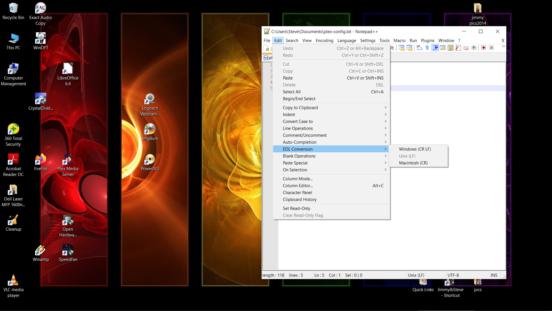

Steve Davis
Sep 9, 2015
29

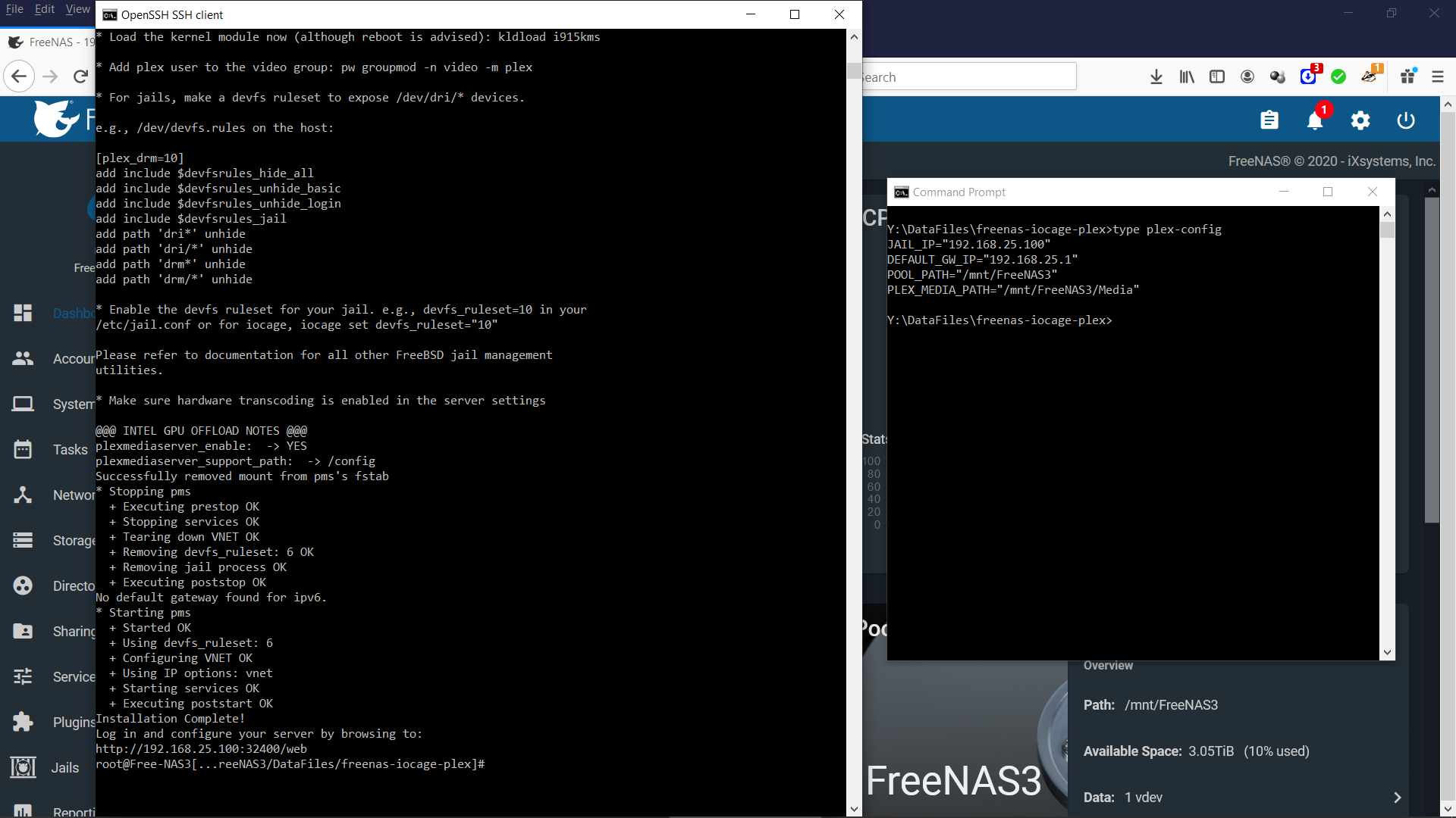

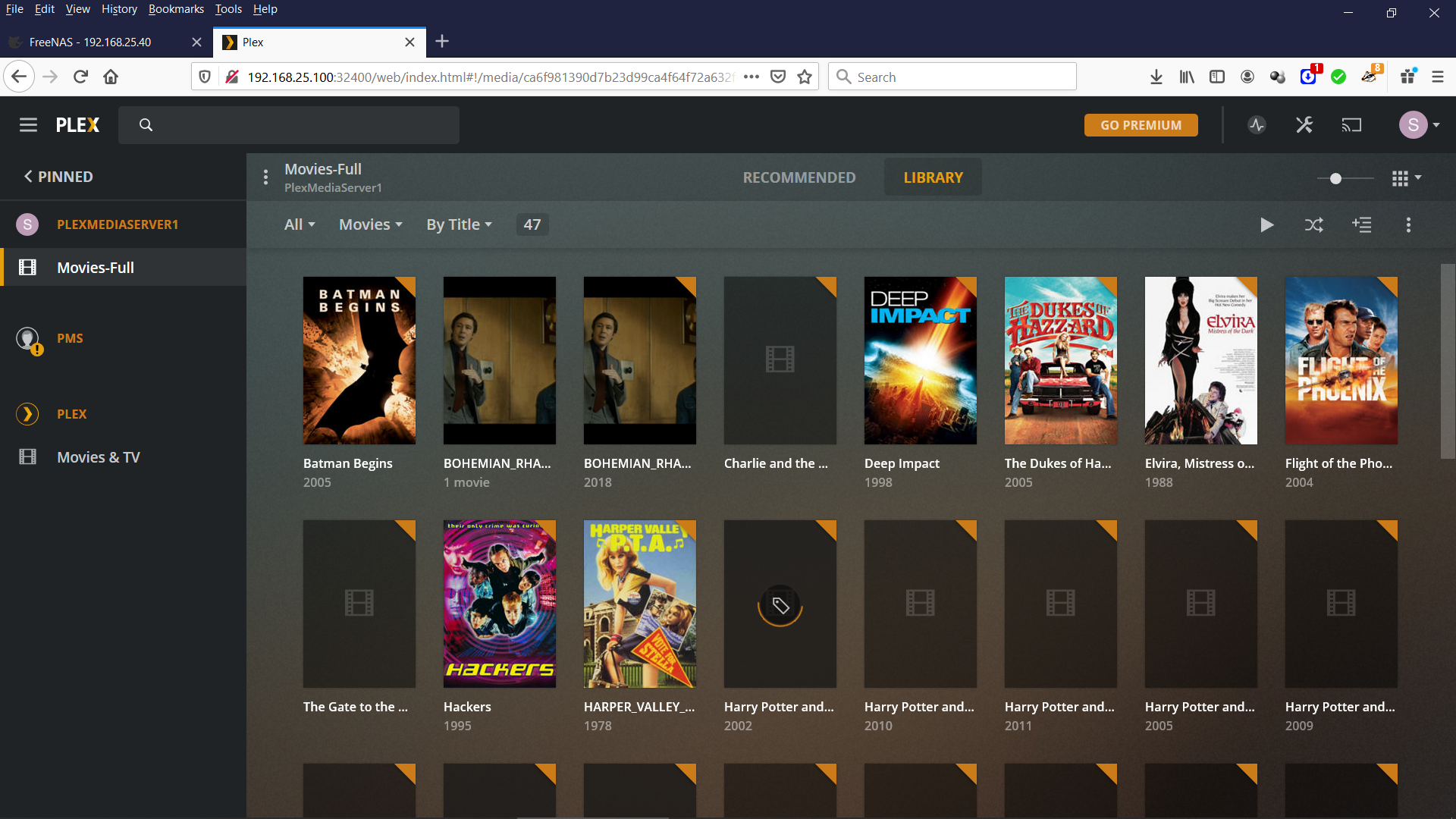

after all of the headaches I finally got it to work.
biggest problem was getting "plex-config" file saved in a unix format, I finally found the program Notepad++ it let me save my configuration file as UNIX LF format.
then plex server installed properly.
(my library files are still updating)

Samuel Tai
Apr 24, 2020
5,399
I tried these commands and none of them work
Glad you latched upon Notepad++. It's pretty good. Note, the specific command I recommended was sed with capital -I. You, in your frustration, were using lowercase -i.
15,504
Or, really, just use one of the simple text editors that ship with FreeNAS (ee or nano) and create the config file on the system itself. I don't think it's "wrong", exactly, to put the script in a shared dataset, but it's definitely not where I'd intended it to be placed.
Steve Davis
Sep 9, 2015
29
Samuel
I didn't matter if I used upper or lower case "i"
I got same error every time.
Only thing that fixed it was using Notepad++
BTW: thanks for suggestion about POOL paths, I completely mis read that in config instructions.

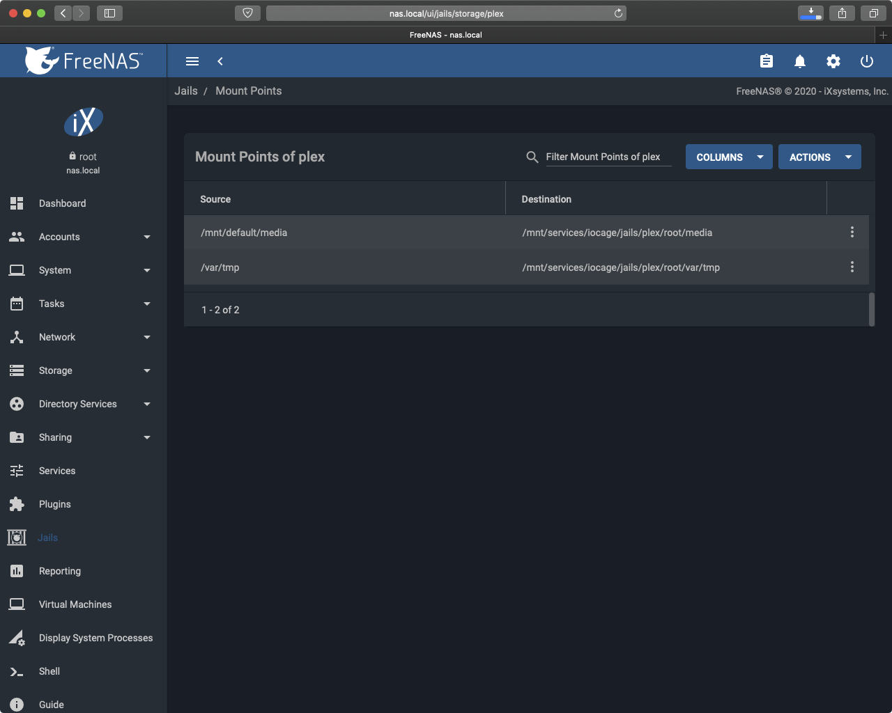

Daisuke
Jun 23, 2011
1,041
the version of plugin in freenas 11.3 is forcing me to install the plex media server with plexpass
I have no idea what do you mean by having the plex media server with plexpass installed. When I installed Plex for first time two months ago on 11.3, I did not have a plexpass and the plugin worked perfect with all my media.
Edit: I just saw your screenshots, here are my mount points, second is to use the transcoder files into ramdisk:
