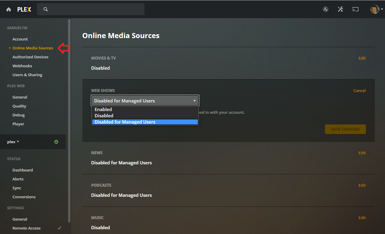

You can configure Plex to disable all these extra features. For external access, you can disable Settings->Remote Access. For the additional services, you can disable all the Online Media Sources. Lastly, you can unpin all the extras, only pin your local media.

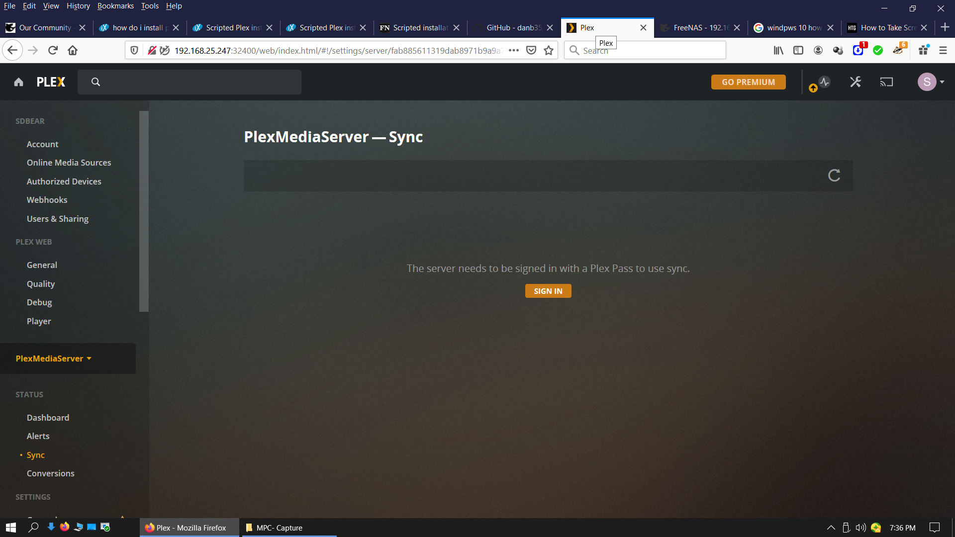

I'm not using the beta version of plugin, i'm using the stable version 1.19.2852 release 11.3-RELEASE-p10
but all the "garbage" that installs with plexpass is still there, I cant disable it and plex will not "remember any of my settings it always defaults to its own settings.
It always defaults to use sync option
every-time i sign into my plex account with plex server I get greeted with " this account needs to be signed in with plexpass to use sync"
I do not have a plexpass

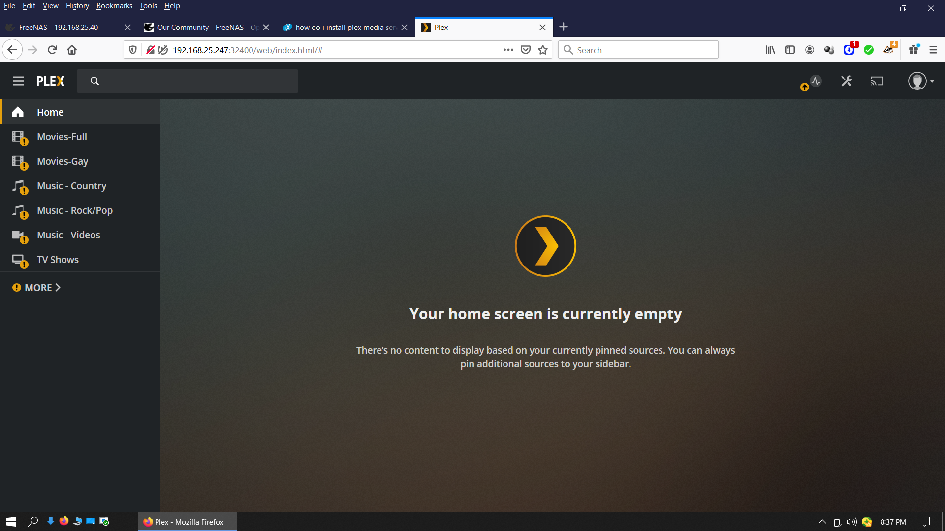

plex media will not save any of my settings, such as what is / isnt pinned to my home screen, everytime i start the plex server first thing im greeted with "it seems your home screen is empty" and wants to pin all of my librarys to it I selected what i want pinned and select "finish setup" no settings get saved and every time i exit and open the plex server page again i get greeted with the same thing everytime
if there is an option to save thes settings would you please tell me where it is

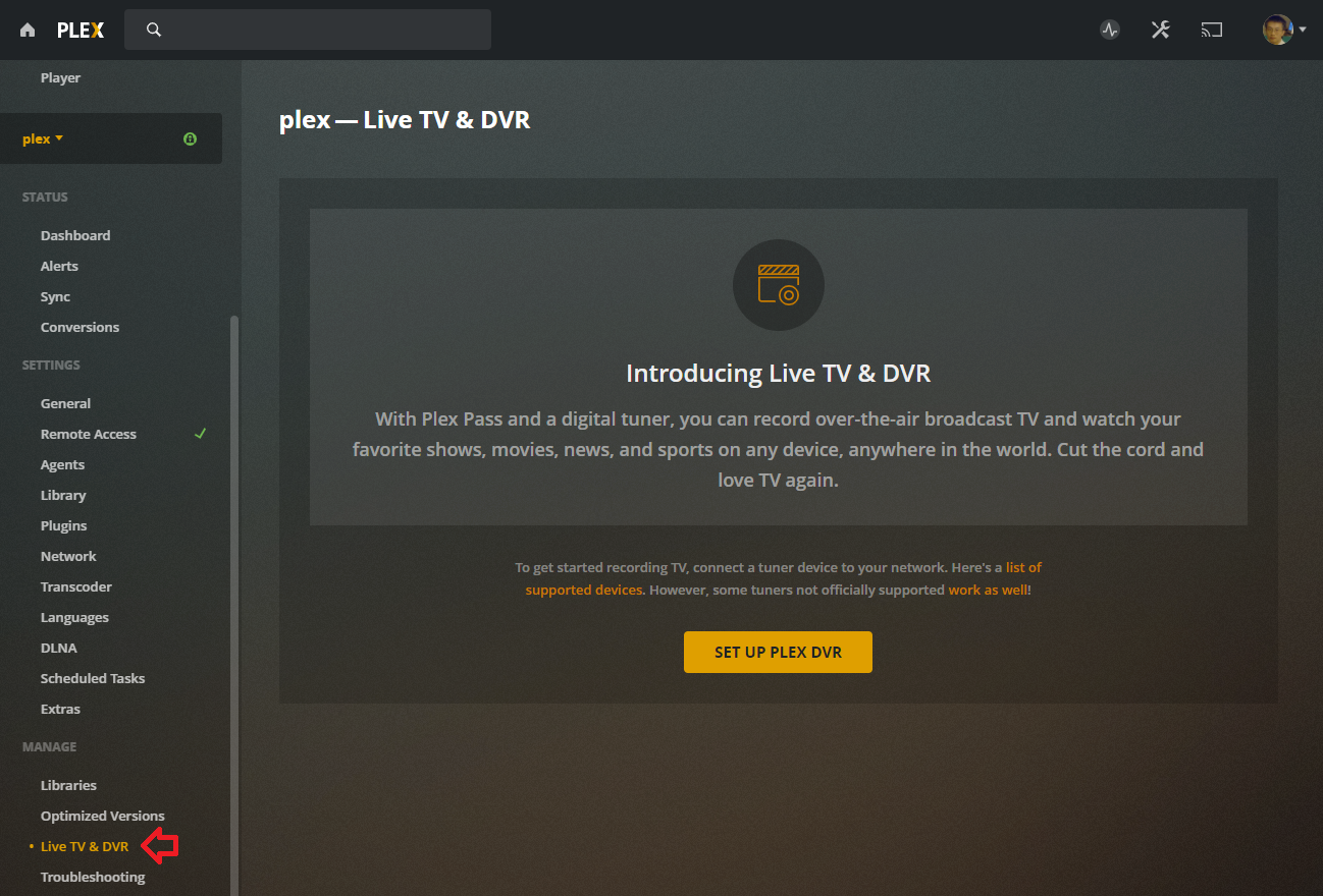

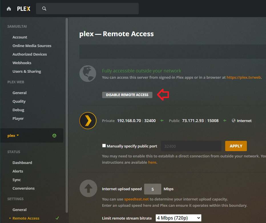

To disable remote access:
To disable online media:

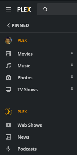

To pin and unpin your media:
Now if you have to do this on every boot, then the Plex configuration directory is read-only. Try removing the plugin and reinstalling.

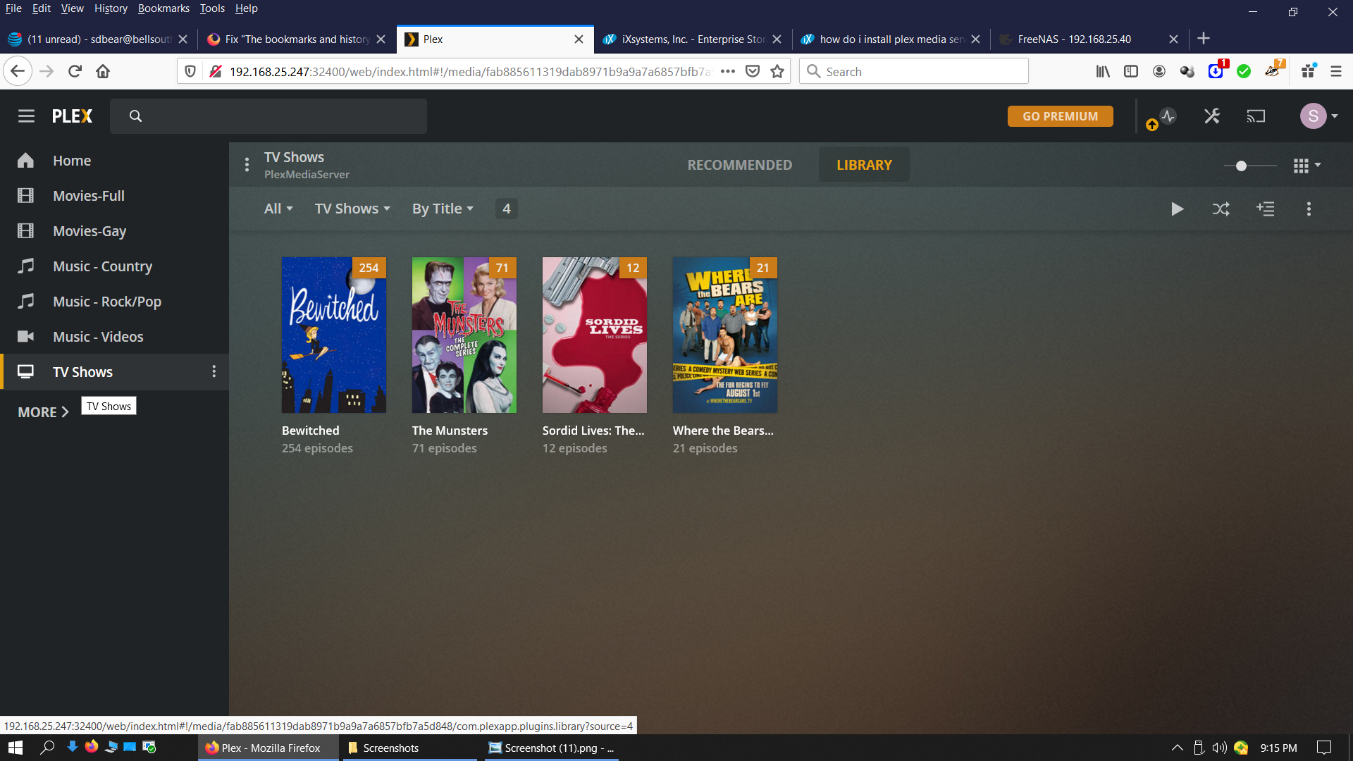

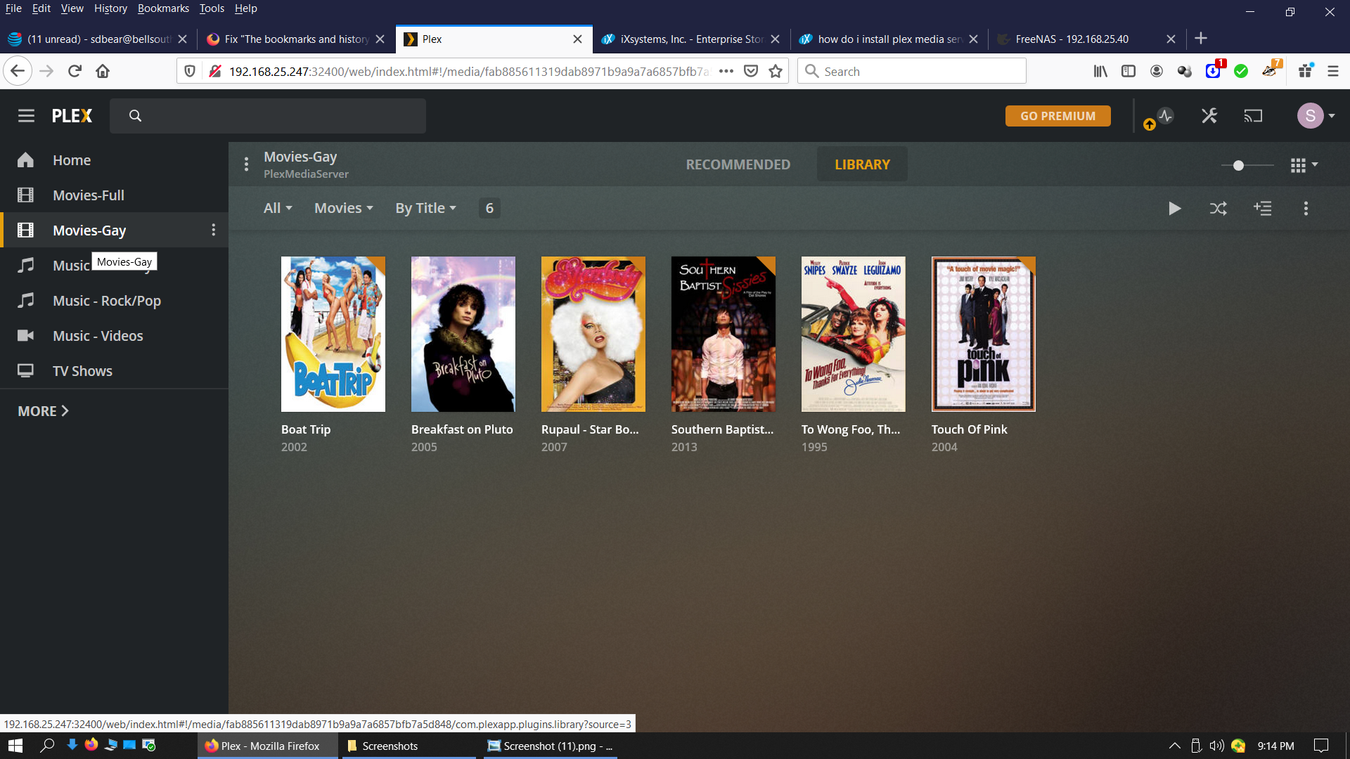

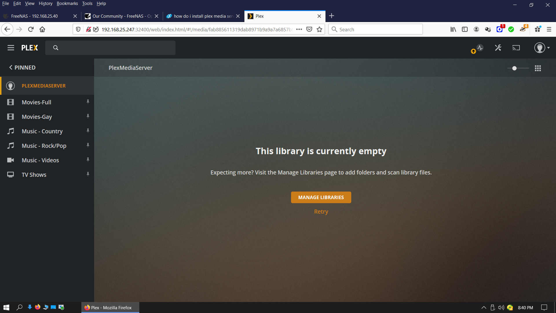

I am running a fresh install of FreeNAS 11.3 with the plugin that came with it, thats when all of these problems started happening

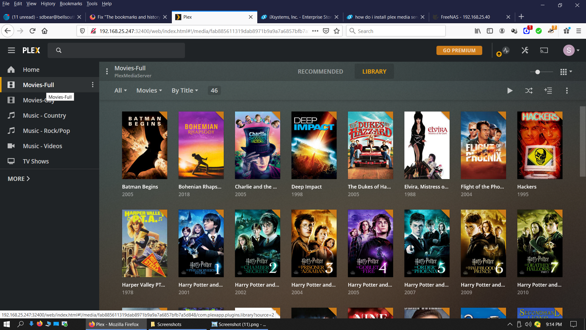

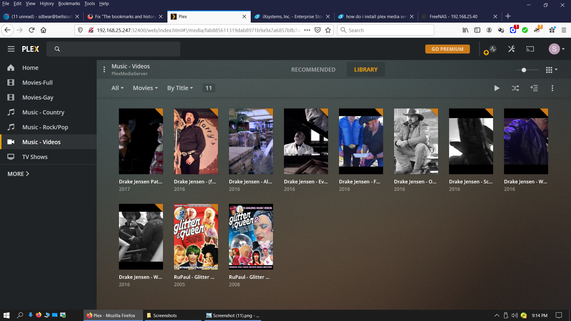

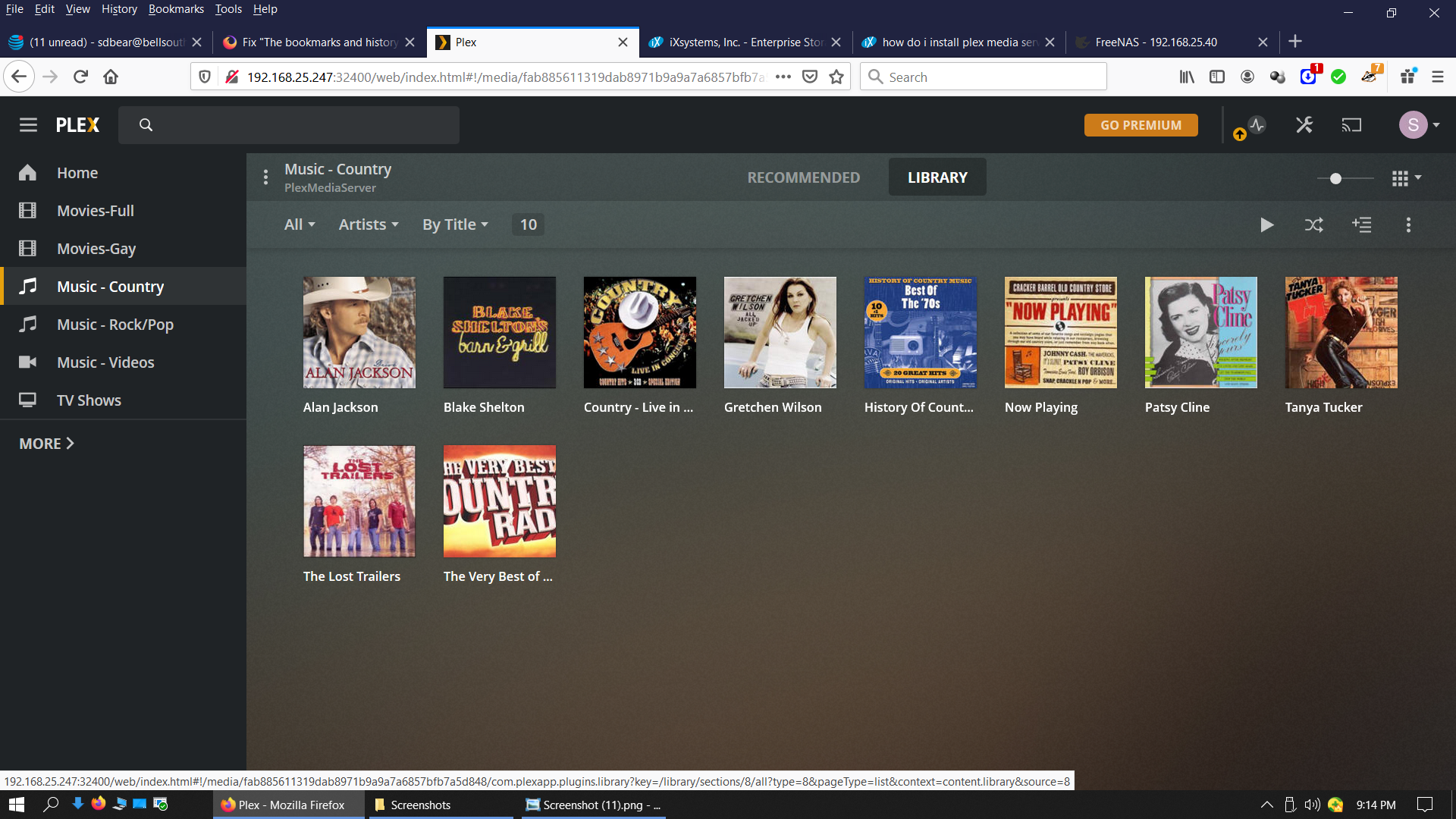

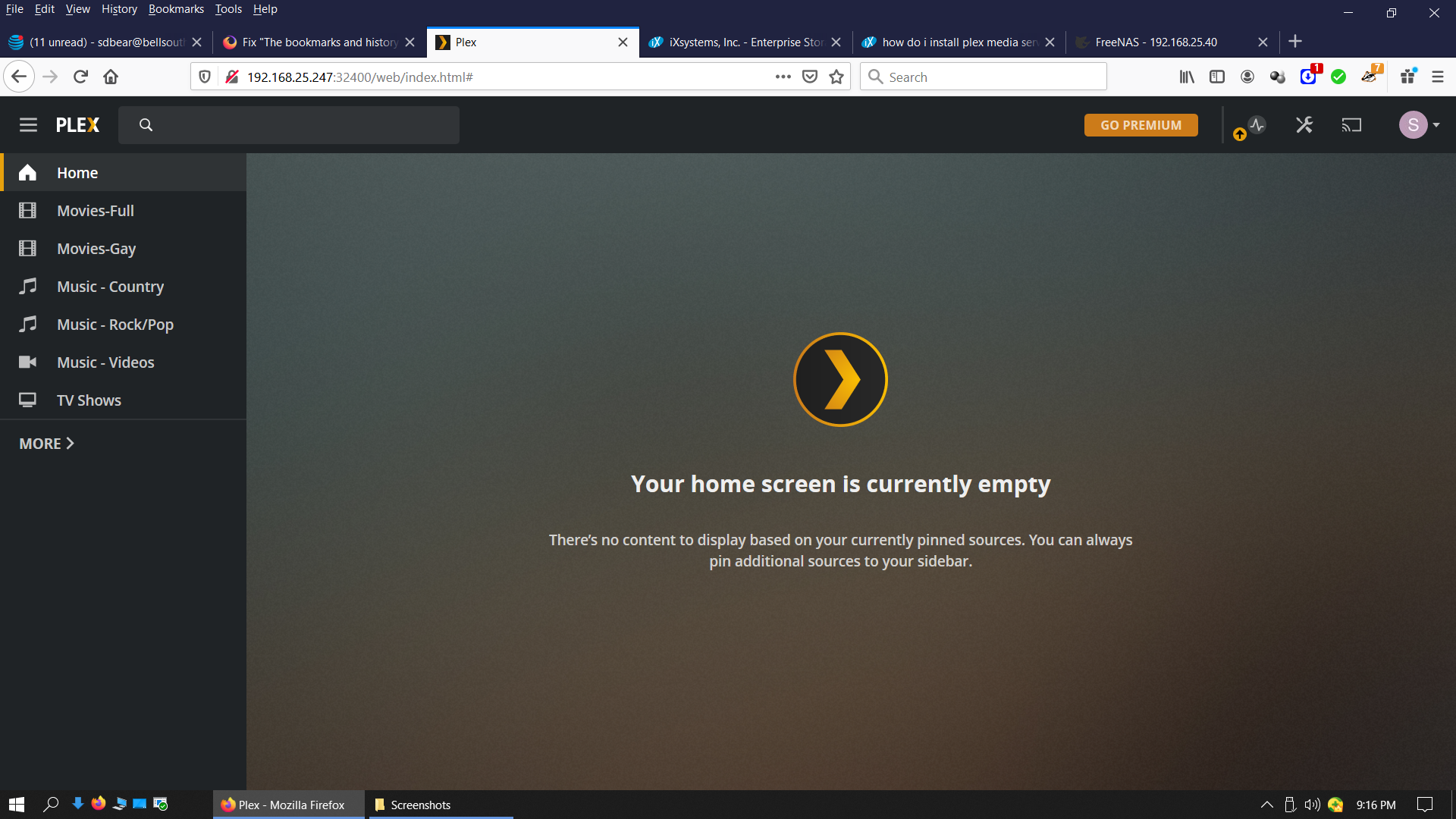

also i have several items pinned to my home screen, it constantly says theres nothing there
another odd thing is, i have many librarys defined however plex says i have none

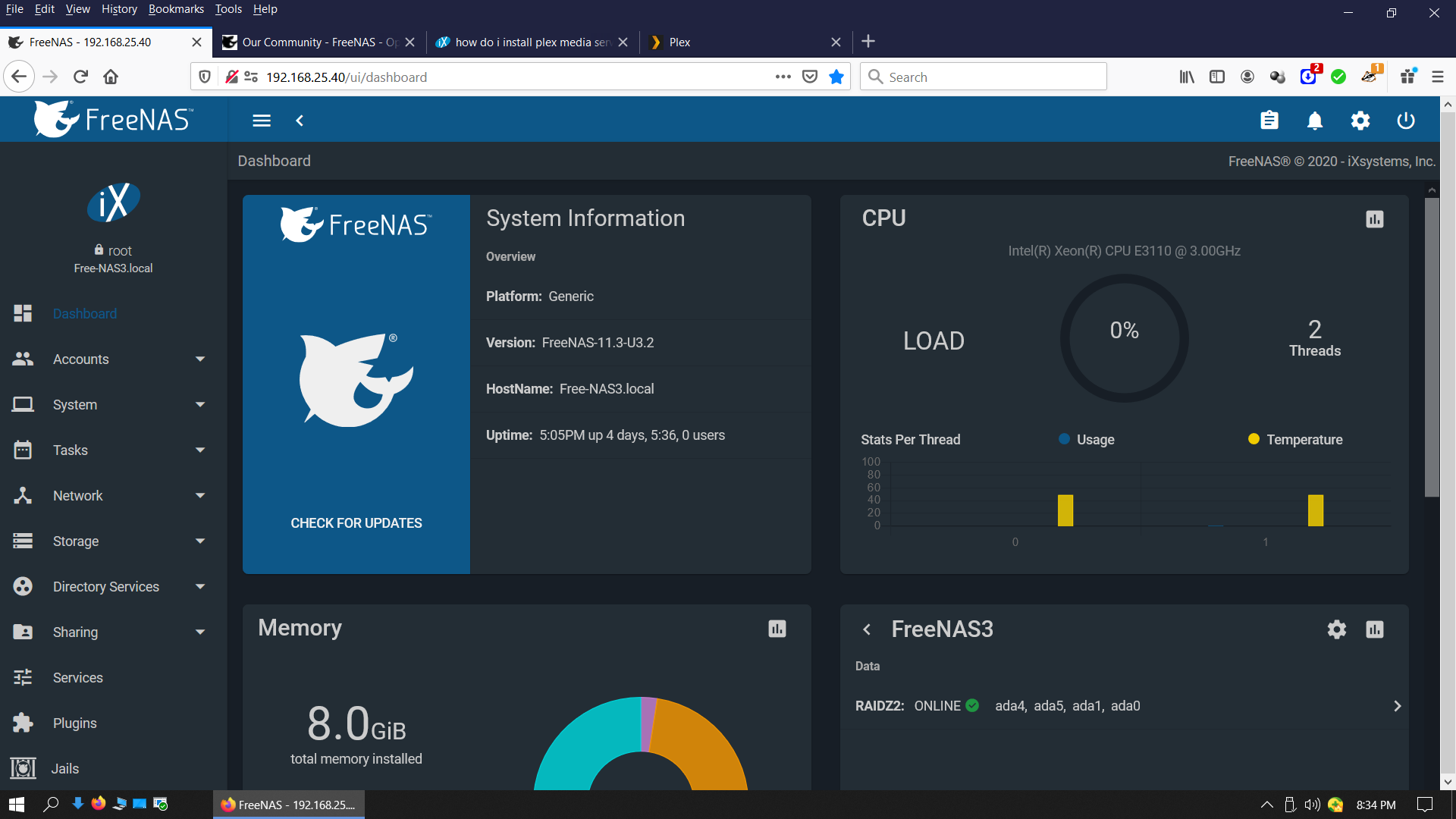

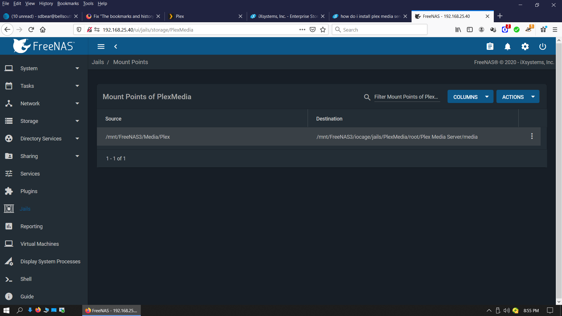

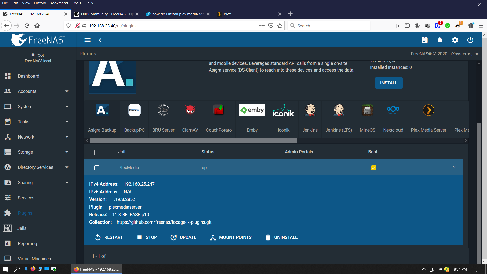

Thank you for the screen shots. They are very helpful. First, for the pinned items, have you mounted your media dataset inside the plex jail, using the Mount Points button in the plugin screen? Second, I see you're using the local portal for the plugin. Inside the local portal, have you logged into Plex?
Steve Davis
Sep 9, 2015
29
library and dataset jails are mounted.
and yes i was signed into plex account

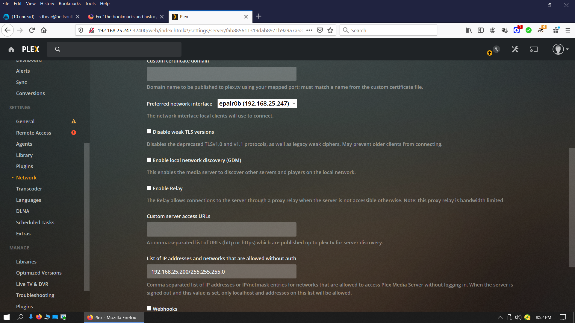

I think I have a partial workaround the online content loading, I disabled TLS in network settings, made sure that General Network discovery (GDM) was disabled, and restricted access as to ip address range
I have lots of media librarys pinned to home screen plex still insists there isn't anything there;
as for the "no content" problem seems plex only wants to display what it wants on home screen and not local media;
apparently this is a bug in plex media server, hopefully they can find and fix the bug.
