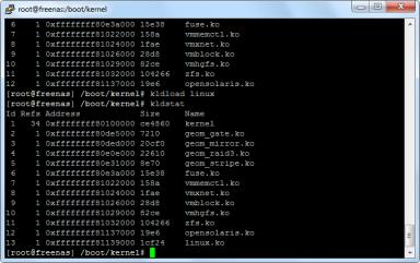

OK, I set myself up a FreeBSD 8.2 virtual machine. From that, I pulled off the linux.ko and copied it first to my virtual FreeNAS 8.0.4 and then to my physical one. The module did indeed load without any errors. The Veeam job still didn't run, but at least I now have fresh logs to send to Veeam support.
I have no idea what a jail is. I have seen the term bandied about, but haven't explored it yet.
