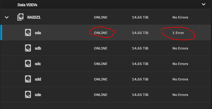

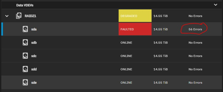

Found this status for my storage devices:
Ran a smart short test and a zfs scrub and after that, I got this:
Back online but still has errors.
Do I need to replace the drive? I tried figuring out this output but still not sure if i need to replace the drive or not.

Pending Defects log (GP Log 0x0c)
No Defects Logged
SATA Phy Event Counters (GP Log 0x11)
ID      Size     Value  Description
0x0001  2            0  Command failed due to ICRC error
0x0002  2            0  R_ERR response for data FIS
0x0003  2            0  R_ERR response for device-to-host data FIS
0x0004  2            0  R_ERR response for host-to-device data FIS
0x0005  2            0  R_ERR response for non-data FIS
0x0006  2            0  R_ERR response for device-to-host non-data FIS
0x0007  2            0  R_ERR response for host-to-device non-data FIS
0x0008  2            0  Device-to-host non-data FIS retries
0x0009  2           21  Transition from drive PhyRdy to drive PhyNRdy
0x000a  2           15  Device-to-host register FISes sent due to a COMRESET
0x000b  2            0  CRC errors within host-to-device FIS
0x000d  2            0  Non-CRC errors within host-to-device FIS
root@truenas[~]# zpool status -v CHUNK
  pool: CHUNK
 state: ONLINE
status: One or more devices has experienced an unrecoverable error.  An
        attempt was made to correct the error.  Applications are unaffected.
   see: https://openzfs.github.io/openzfs-docs/msg/ZFS-8000-9P
  scan: resilvered 553M in 00:00:06 with 0 errors on Sun Sep  3 05:21:01 2023
config:
        NAME                                      STATE     READ WRITE CKSUM
        CHUNK                                     ONLINE       0     0     0
          raidz1-0                                ONLINE       0     0     0
            b776a493-8c25-4999-988a-5570ec8afa01  ONLINE       0     0     0
            6415b76b-174e-48ae-9d72-4a0e1dc82ece  ONLINE       0     0     0
            6318b353-b38b-4914-be7a-8c99f90f6063  ONLINE       0     0     0
            287a1658-b6a0-4c11-b486-10973def5afd  ONLINE       0     0     0
            c23400dc-e278-44ec-a9e9-66469271d111  ONLINE       0     0     1
errors: No known data errors
root@truenas[~]#
Short test can miss unreadable sectors, depending where they are physically. A long test might catch them.
But the "errors" according to the GUI are ambiguous. You'll need to look the pool's status to view more info:
Pardon. I missed it in the output. It's easier to read if you use the code tags instead of icode tags.
If all of those previous errors were checksum errors, it might have been the case of a loose cable or connection.
nothing
Jun 4, 2023
59
Fixed. Sorry about that
