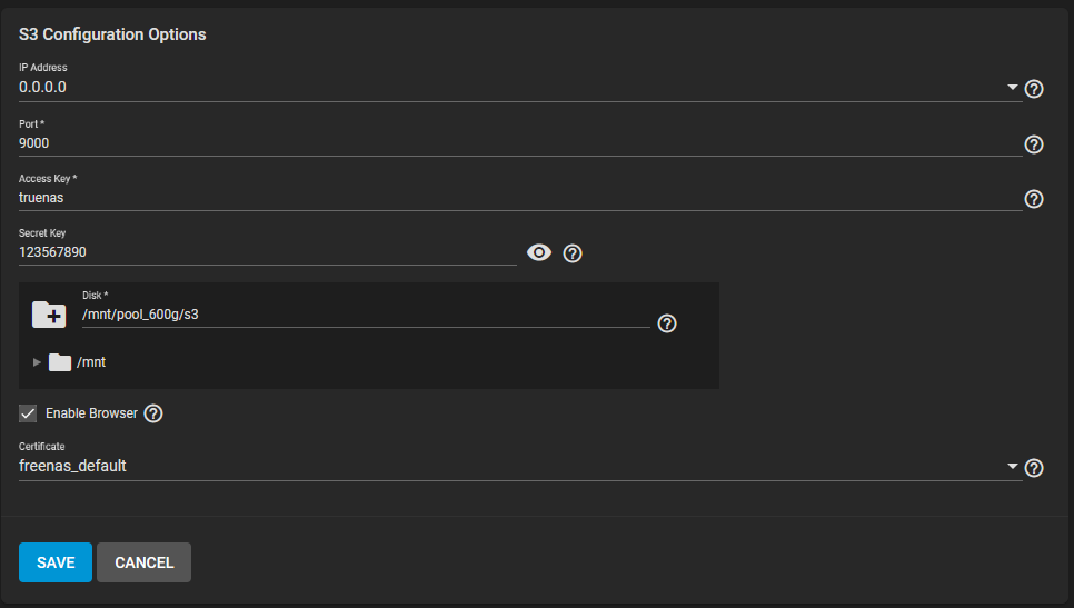

I am newbie on TrueNAS. Yesterday I setup new TrueNAS system (12.0-U7) and config S3 service:

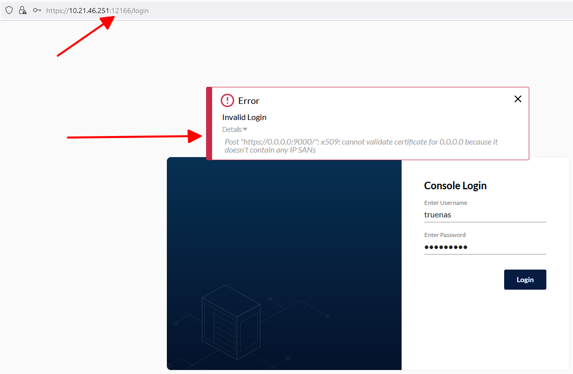

But when I connect to TrueNAS from client, browser auto redirect to port 12166 and error:
Please help me.

This appears due to changes in MinIO that haven't been incorporated yet into the TrueNAS middleware. According to the MinIO Quickstart Guide, the service launcher at /usr/local/etc/rc.d/minio needs to set the environment variable MINIO_SERVER_URL equal to "https://" + certificate's CN + "${minio_address}".
Please submit a bug report, because the S3 browser used to work without this IP SAN check. Unfortunately, upstream changes aren't always relayed to the TrueNAS developers in a timely fashion. Hopefully, this will be an easy fix for 12.0-U7.1.

I managed to get it working, but there've been a log of changes in MinIO, so no guarantees this will continue working. First, stop the S3 service. Starting at line 54 of /usr/local/etc/rc.d/minio, add the following lines:
: ${minio_server_cn:=`/usr/local/bin/midclt call certificate.query | /usr/local/bin/jq | grep common | cut -d'"' -f4`}
: ${minio_server_url:="https://${minio_server_cn}:`echo ${minio_address} | cut -d ':' -f2`"}
: ${minio_root_user:=`/usr/local/bin/midclt call s3.config | /usr/local/bin/jq | grep access_key | cut -d'"' -f4`}
: ${minio_root_password:=`/usr/local/bin/midclt call s3.config | /usr/local/bin/jq | grep secret_key | cut -d'"' -f4`}
export MINIO_SERVER_URL="${minio_server_url}"
export MINIO_ROOT_USER="${minio_root_user}"
export MINIO_ROOT_PASSWORD="${minio_root_password}"
Save the start script, and restart the S3 service.
