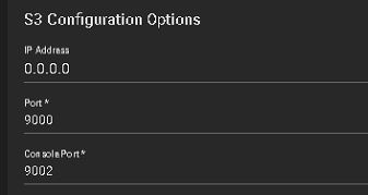

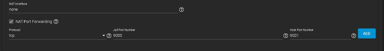

Problem : if i let the S3 service port at 9000 and Console port at 9001 and let the Jail Network properties NAT Forwarding at 9000 and 9001 then i cannot reach the MiniioJail url at port 9001.

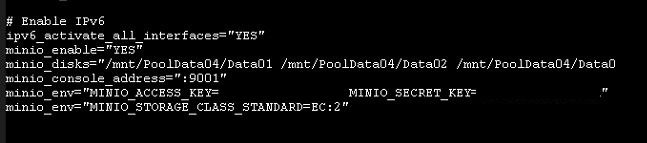

If i change the console port to 9002 and let the Jail Network properties NAT Forwarding at 9000 and 9001 i can reach the Minio at port 9002. Strangely my /etc/rc.conf says still 9001.
Set went fine but cannot create bucket with mc client.
mc alias set minioveeam https://192.16.1.127:9002 TESTRHO6IBB TESTV7f1CwQqAcwo80UEI --api S3v4
Added `minioveeam` successfully.
mc mb minioveeam/veeam --with-lock
mc: <ERROR> Unable to make bucket `minioveeam/veeam`. Put "https://192.16.1.127:9002/veeam/": dial tcp 192.16.1.127:9002: connectex: Unable to connect because the target computer has actively declined the connection.
if i shuffle with ports of S3 and Jail Network properties then i get error
mc: <ERROR> Unable to make bucket `minioveeam/veeam`. S3 API Request made to Console port. S3 Requests should be sent to API port.
i have made 4 pools with dataset to make erasure code work and changed the rc.conf (see picture) not sure if this is put right by me.
