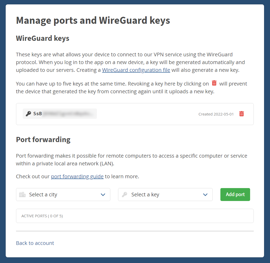

What do you mean the default Wireguard port? The only port that matters for listening is the port that is assigned to you by Mullvad for a specific city. You have to first tell Mullvad to assign you an available port to forward and for which city. (This is done by logging into your Mullvad account.)
For example, you choose your Wireguard public key (from the list) and choose a city (from the list). Let's say you select the public key that you know is from your qBittorrent jail. Then you select Sao Paulo (br-sao) as the city. Let's say it randomly assigns you the port (for this specific selection) of 55001. This means that in order for "Listen on this port" to work with qBittorrent, the following must be met:
  1. The peer's connection must use the same public key (of your Mullvad account)
  2. The wireguard Mullvad VPN server must be through Sao Paulo, Brasil (br-sao)
  3. The port to listen on must be 55001
This also means you cannot keep using a different city each time you fire up your wireguard VPN connection. You must stick to their Sao Paulo servers. (You can always change the city in your Mullvad account, which will delete the existing entry.)
