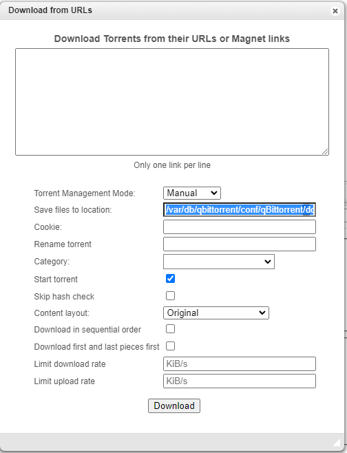

(3) Dumb q - downloading torrent from url; or magnet link - best way? I have access to a private tracker, and want this to count there for uploading.
(4) Also save files to location, I should change? How to access on Truenas? I have permissions enabled on network, so I can transfer files easily but yeah, not setup with jail.
/var/db/qbittorrent/conf/qBittorrent/downloads

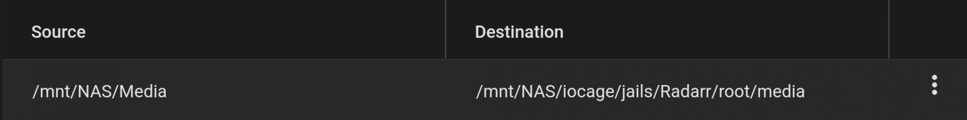

4. For save location, I would recommend you make a new dataset for your downloaded media or if you already have a dataset that's fine. Then go into
Jails -> qBittorrent -> Stop
Jails -> qBittorrent -> Mount Points
point /mnt/[Your System]/[Your Dataset] to /media in your jail (or an alternative location you want to use)
Then restart the jail (you cannot change mount points while the jail is live)
Mount points are how you connect your jail to the outside world, for example for me:
There are plenty of videos and tutorials about mount points out there. I also then have this Media dataset shared as a Samba share so I can access copy movies in from my PC or easily rename files/modify things.
In qBittorrent I then point the downloads to /media/Movies or /media/Downloading

4. "In qBittorrent I then point the downloads to /media/Movies or /media/Downloading"
Is that in Radaar/root/media? (Destination) Or /mnt/Nas/Media (Source)

4. This will be different for your setup, I don't know what your ZFS datasets look like. The destination should be /media/[call this folder whatever you want] and the source is one of your datasets. This is quite hard to explain unless you know what I'm talking about. Once again, am happy to discord or something to show you
