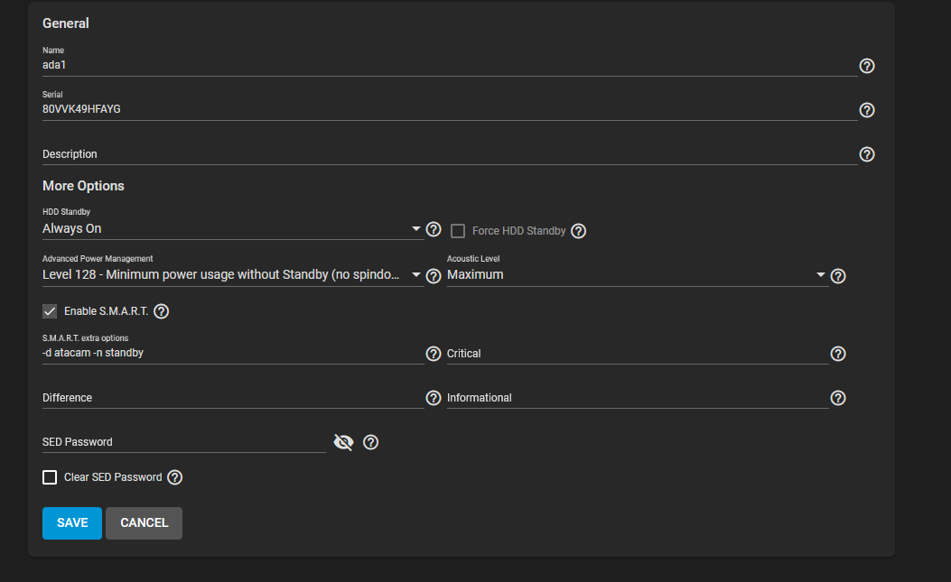

Here you go. That's one of the disk on the pool (there's 6 of them)
The
-d atacam -n standby you see is a try I made when I saw that reading smart values for one of the pool drive was spinning up the disk again (and that -d might be required to avoid smartcl to spin up the drive to find its kind). But it does not change a thing since it is overriden (I guess) by the smartd.conf.
/dev/ada1 -a -d removable -n never -W 0,0,0 -m root -M exec /usr/local/libexec/smart_alert.py\
-s S/../../(3)/(03)\

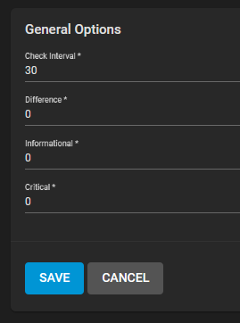

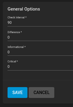

One curious thing I noted is that the drives actually spin up around the 5 minutes most of the time. I set the standby timer in the script to 2 minutes to do some tests, and the drives did come up at regular interval around a multiple of 5 minutes (5, 10, 15 etc). Smart reads occur every 5 minute on my NAS so I bet this is related
Also, If I'm not using the script and use the standard TrueNAS implementation, the drives also spin up around the same time mark. So I guess this is not related to your script, but rather to the
-d removable -n never that TrueNAS put in the smartcld.conf that will probably spin up the drive every time a smart read is executed...
