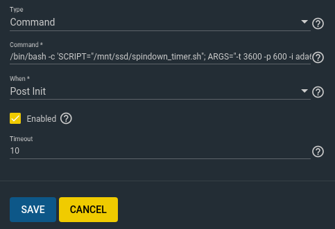

Does anyone know a way to use this script as post init script on 11.3(U1)? There is only an option to let it get killed after x seconds.
ngandrass
Jun 26, 2019
68
Ah I see, the task timeout was introduced by the 11.3 release. Interestingly the script is never killed by FreeNAS for me, therefore I never noticed the new timeout feature. However, that might be due to the upgrade path I took. For this reason I just performed a quick test on FreeNAS-11.3:
  1. Delete old task that was present before the upgrade to 11.3
  2. Re-create new task leaving the default timeout of 10 seconds
  3. Check if the script is killed by FreeNAS
Interestingly the script still executes just fine without getting killed even though the middleware log indicates the registered timeout:
[2020/03/02 11:11:54] (DEBUG) middlewared.execute_init_tasks():173 - COMMAND /bin/bash -c 'SCRIPT="/mnt/ssd/spindown_timer.sh"; ARGS="-t 3600 -p 600 -i ada6 -i da0"; CHECK=60; while true; do if [ -f "${SCRIPT}" ]; then ${SCRIPT} ${ARGS}; break; else sleep ${CHECK}; fi; done' timed out
I launched it as a Post Init Command, described in the corresponding README section, leaving the default 10 second timeout. See: https://github.com/ngandrass/freenas-spindown-timer#automatic-start-at-boot
Can you please confirm if this works for you? I'd than update the documentation accordingly. Thanks!
NAK
Feb 5, 2020
16
I can confirm that it is working. Should have tried it before :)
I hope they will fix the timeout but provide an option to disable it.
ngandrass
Jun 26, 2019
68
Perfect, thanks for confirming this. I definitely keep an eye on the behavior of that option though.

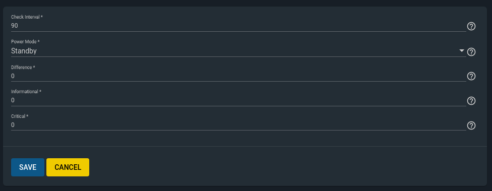

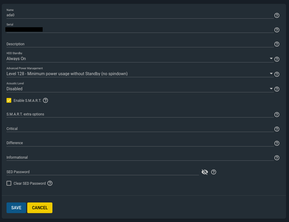

Sorry, I somehow didn't receive a notification about your reply to this thread... It's good to hear that you were able to kinda solve the spindown issues :)
Just for reference, here are my disk and S.M.A.R.T configs:
Disk configuration S.M.A.R.T configuration
