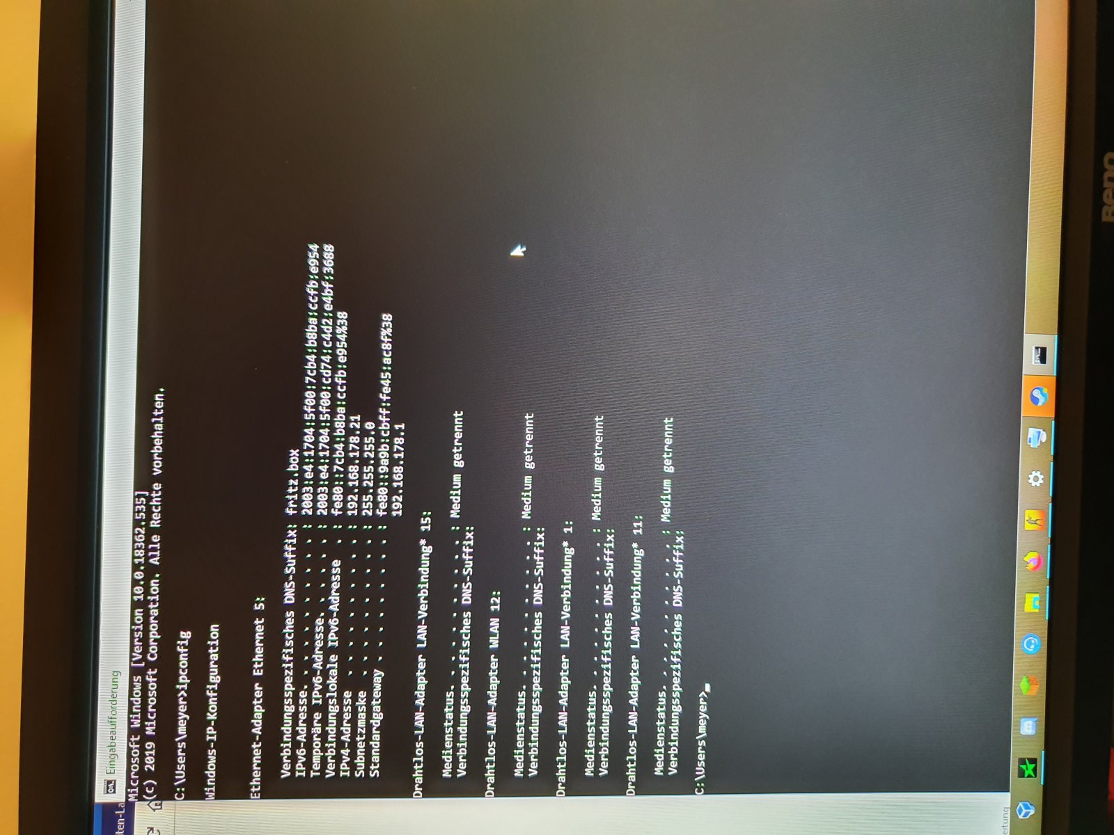

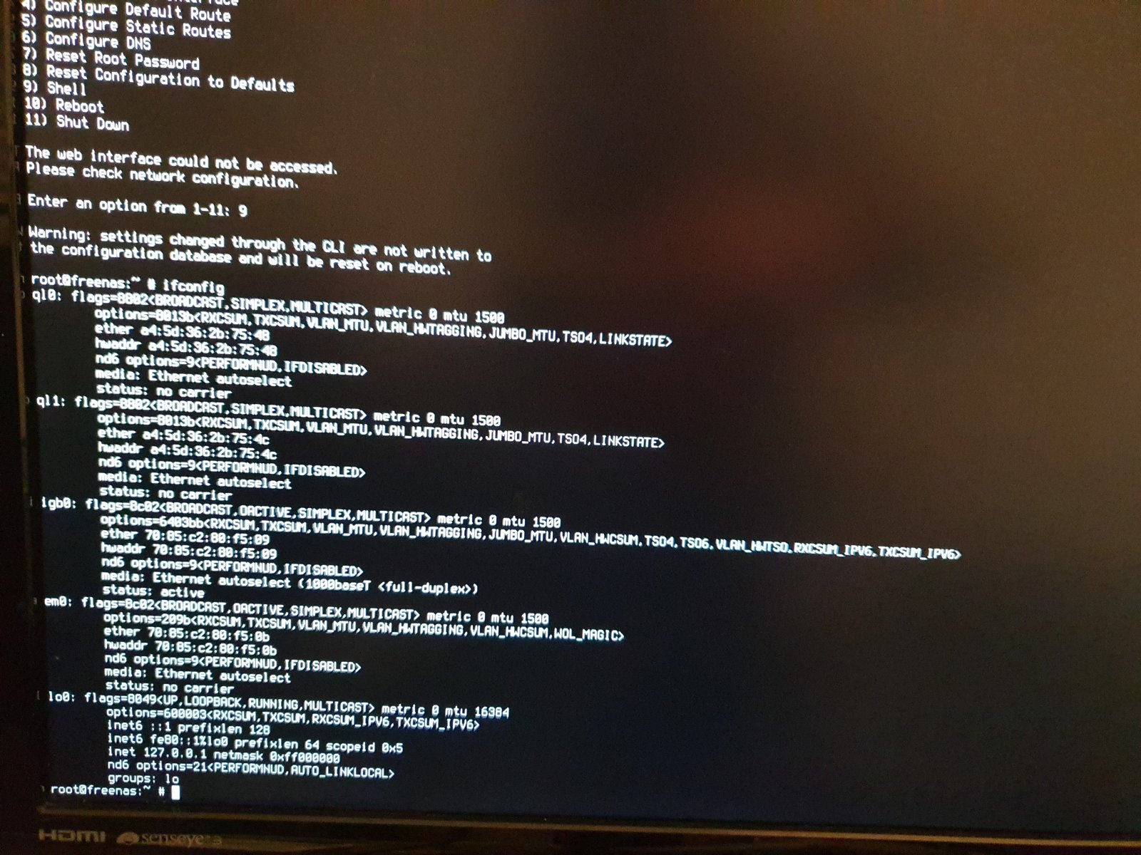

You are not missing anything. My educated guess: IP settings on both sides of the link do not match. You can drop into a shell from the console menu. Please post the output of this command, take a photo with your phone ;)
ifconfig
Additionally post the IP configuration of your computer. Some more info (Windows, Mac, FreeBSD, Linux ...) would be nice.

Is this all you need?

Your computer seems to be connected to a Fritzbox router so it probably got its address via DHCP. When you say you connected the FreeNAS directly to your computer, does that mean the latter has got a second interface? When you unplug it from the Fritzbox it will lose its IP address and you need to manually configure one matching the one on your FreeNAS. But that must be a different network than the one the Fritzbox manages. This is all basic IP networking.
Second your FreeNAS seems to be connected via the igb0 interface, but does not have an address. This is the default, it expects a DHCP server, too.
If you don't know basic IP networking my advice is to connect your PC and your FreeNAS to the Fritzbox and everything will be great, promise ;)

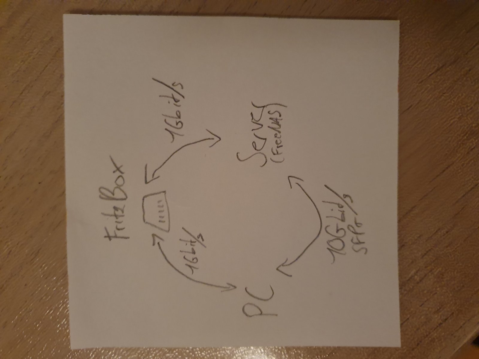

ehh i have both of them connectes to the fritzbox..
That was the connection that worked but is not working anymore. I also have a 10gig link between my pc and the server

If sou have a separate connection between the PC and the FreeNAS you need to set up IP addresses on both sides (!) manually, since there is no DHCP server on that link. And they must be from a different network than the 192.168.178.x you run in the Fritzbox managed LAN.
So, setup e.g. 192.168.0.1/255.255.255.0 for your PC and 192.168.0.2/255.255.255.0 for the FreeNAS on that 10G link and you should be able to access the UI ...

@DDiSoEsT configure your igb0 for DHCP and make sure this one is connected to the Fritzbox ...

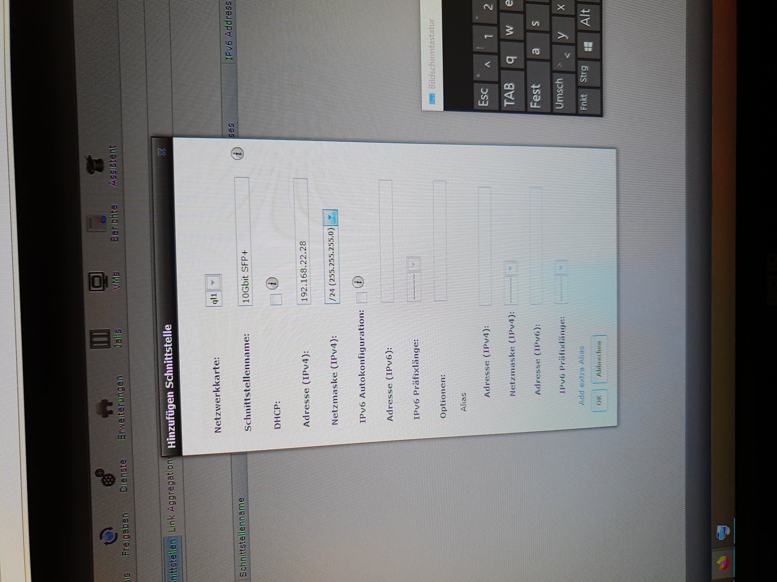

How do i set up the 10 gig link correctly now? do i just choose a random ip like this and configure my pc the same?

You choose a random network different from 192.168.178.x and then pick 2 different addresses in that same network. In the photo you took both ql0 and ql1 showed "no carrier" so your direct link might not quite be working, either. Or possibly your PC keeps that 10G interface in the shutdown state because you have not configured it, yet.

BTW which version are you running? This GUI picture looks oooooold ...
