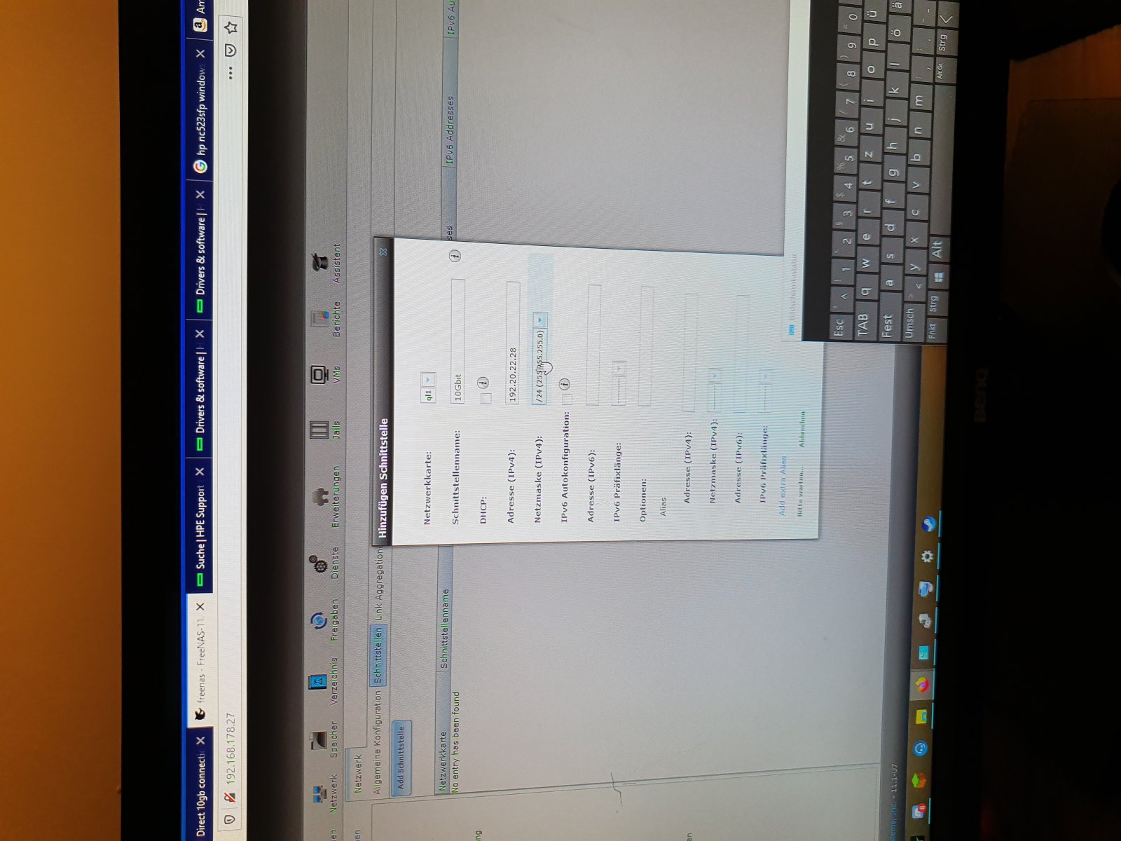

I entered this, hit apply and im stuck again, no connection to the gui..
i have set the same ip adress on the 10gbit port the server is connected to, on my pc

First, you can post real screen shots for the GUI. That phone picture was just a friendly hint for the VGA console ...
Second, I don't have a clue. If you are using the GUI via igb0/DHCP assigning a static address to a different interface should work. But then I have not used 11.1 for years ...
Try configuring all interfaces via console ...

P.S. your PC of course needs a different address! Like 192.168.22.28 for the FreeNAS and 192.168.22.27 for the PC. And please do not make up random networks. Stick to 192.168.x.y - x must be the same for PC and FreeNAS but different from 178. y must be different for PC and FreeNAS.

Lol
Configuring the ip of ql1 on console did just work without any crashes!
Lets see if it works on windows too
